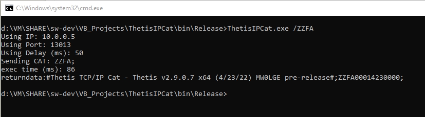

just made a commandline tool for sending CAT-Commands via TCP/IP to Thetis:
https://www.oe3ide.com/sdm_downloads/thetisipcat/
Usage:
Just call the program. The ini-file (thetisipcat.ini) will be auto-generated in the same directory as the exe. Adjust IP & Port.
Examples:
Code: Select all
thetisipcat.exe /ZZFA00014250000 /ZZSP1 /ZZFB00014260
cmd interface.jpg (81.7 KiB) Viewed 9895 times
You can parse the output ("returndata:") for reading the returned data from Thetis
Have fun :-)
