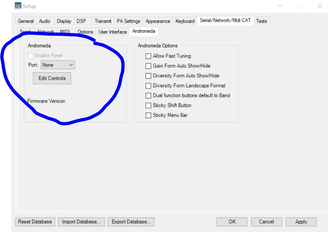

Perhaps these settings need to be adjusted?

Scott - thanks for trying - but that merely enables the buttons/knobs apparently.
If I unset the "Enable Panel" that stops the buttons and knobs from working.
Edit Controls allows you to change the button/knob command functions - which I'm leaving alone for now.

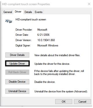

your touch screen problem has nothing to do with Thetis. It's more or less Windows related. If the display's touch controller (mini-USB Type B connector) is properly connected and the driver for it is installed, you should see the "HID-compliant touch screen" entry in Device Manager.
Also make sure the driver is enabled.

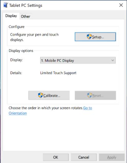

If everything is fine, you should check the "Tablet PC Settings" in the Control Panel. If more displays are connected it is important that the "Mobile PC Display" entry is visible under "Display options". If that's the case, you can now calibrate the touch screen.
