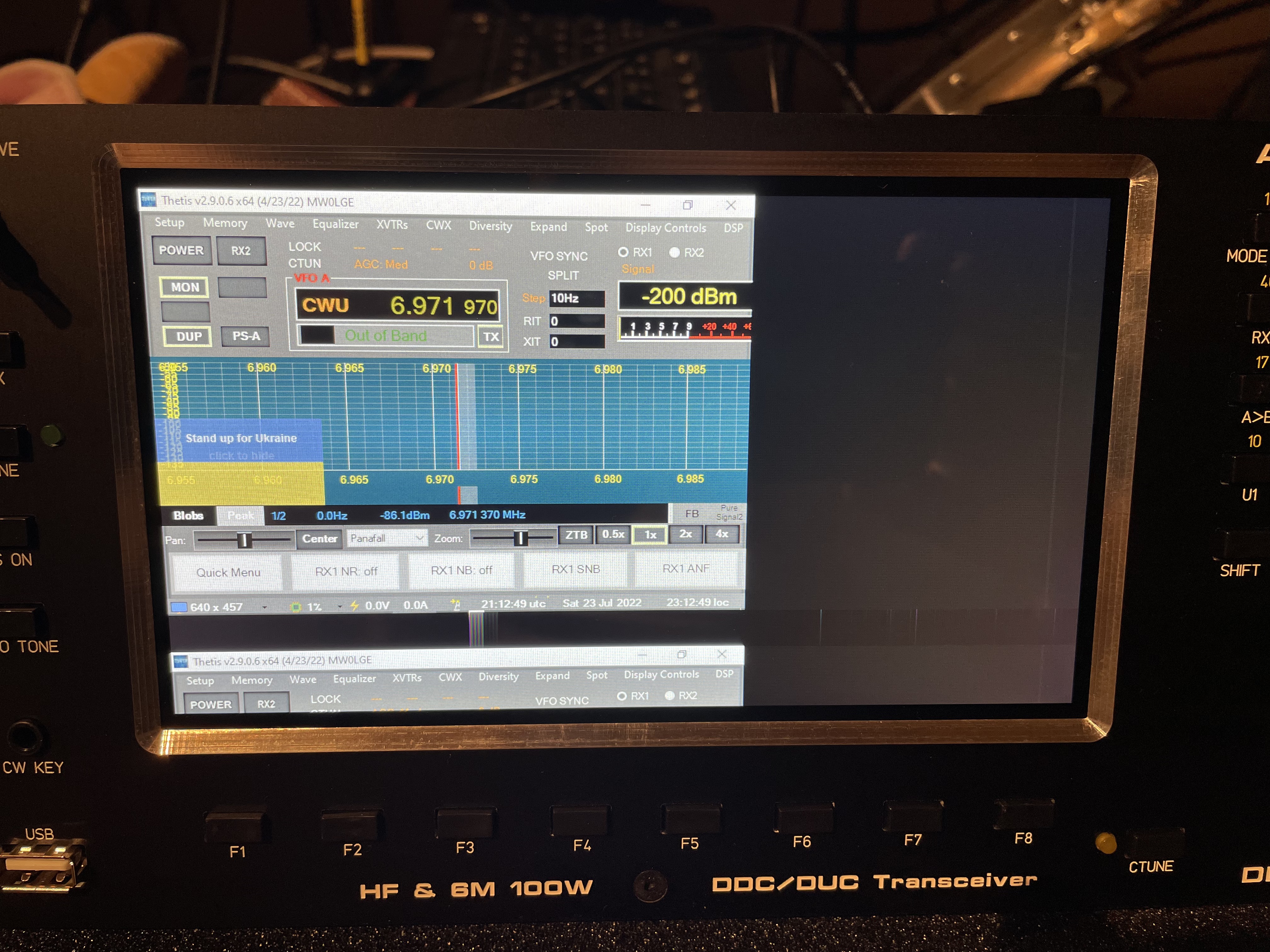

my Newhaven display (IPS touch, original version) is not detected correctly by my Intec NUC. Resolution is fixed 640x480.
(Digital flat screen monitot 640x480 60Hz)
My previously used Ingcool 7" works fine.
I cannot find any hardware drivers for the Newhaven display, nor does Hardware detection detects the display.
any ideas?
Volker

When I first started the NUC, the Newhaven display worked ok, but when I started my Arduino (PWM connnected) the screen got black. Touch function is ok.
I think I have a hardware issue, propably with the flat ribbon connectors.

The problem mentioned by DL4ZBG is crystal clear : the EDID eprom is corrupted.
it's a rather common issue, and what we could consider as a "conception bug" (the write "disable" pin of this eprom is left floating)
considering the price of this display, you have two options :
- flashing the eprom again via the jtag located on the main board of the display. It's a simple I2C eprom, and the content of the EDID file is located on the display documentation, located on the Newhaven web site
If you do not have any eprom programmer, just drop me an email (the on on QRZ.com is the right one) and I will send you an already flashed memory (for free... we are ham, not stuff vendors)
the corruption of this eprom seems to be caused by a ground loop in the pwm circuit. Avoiding this pwm command could be a good idea
