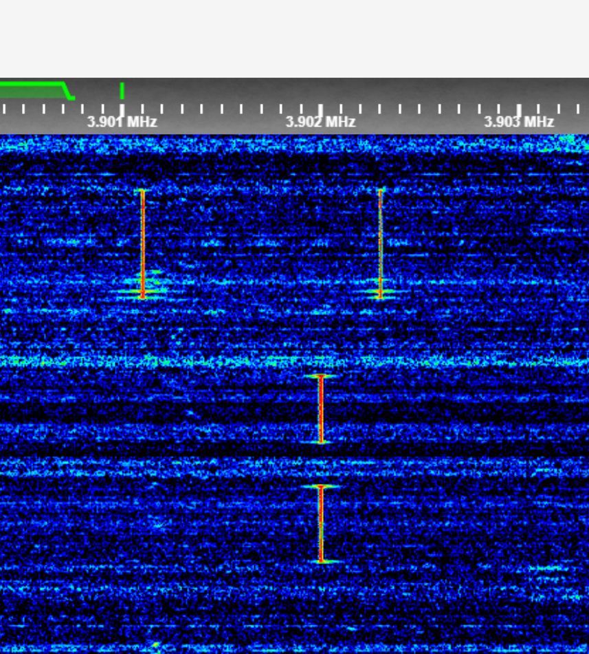

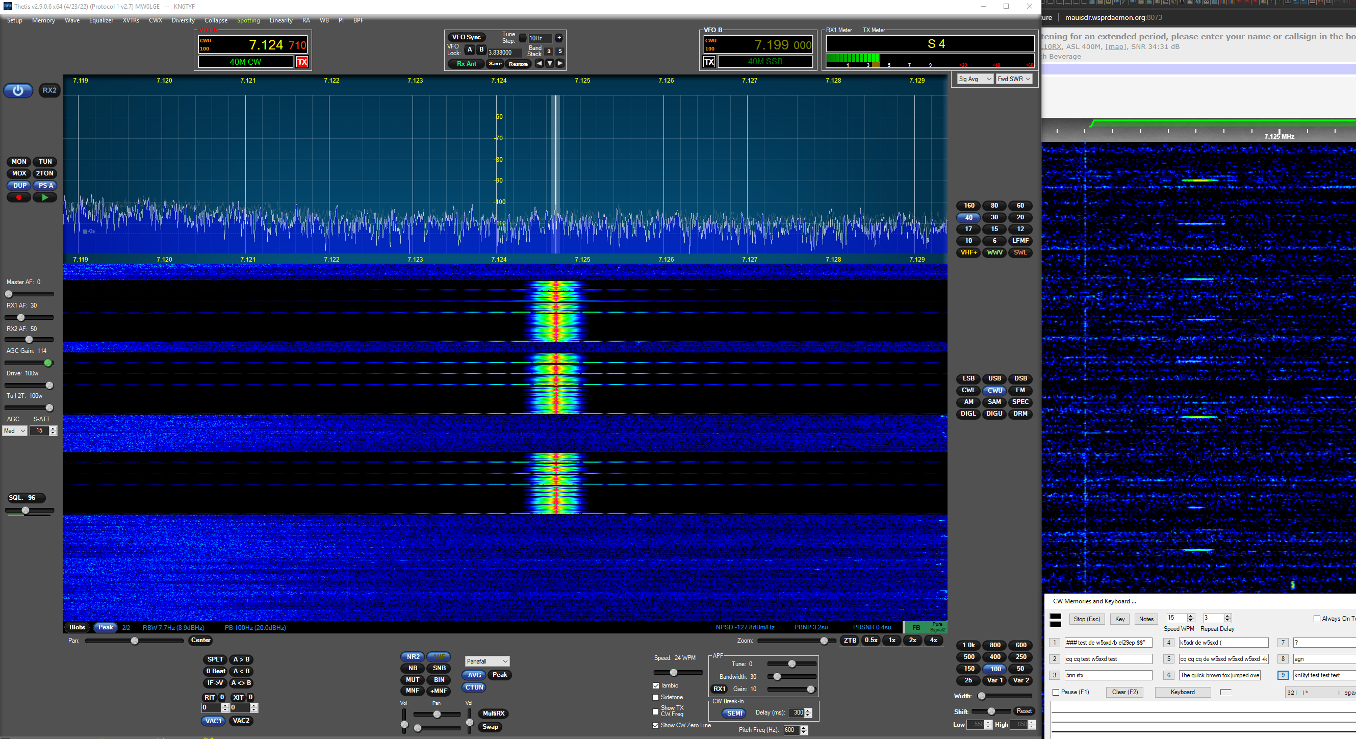

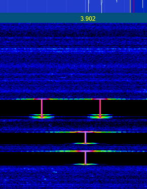

I am facing an issue with my new 7000 Mk3 running v2.7 Protocol1, that has very poor transmitted CW tone with a lot of distortion on the signal, and keying clicks on both key down and key up. This is observed on all bands. The antenna is a resonant fan dipole, there are common mode chokes and ferrites, and I don't believe there is any RF coming into the shack.
The following is from CW transmitted at 100W and received on a remote receiver, via the CWX built in keyer.
CWX Thetis
CWX Thetis
Screenshot 2022-07-26 021120.png (40.78 KiB) Viewed 6324 times
CWX RemoteSDR
CWX RemoteSDR
Screenshot 2022-07-26 021124.png (64.58 KiB) Viewed 6324 times

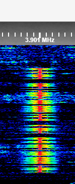

This phenomenon somewhat occurs using the TUN button and 2TON buttons as well.
Tun+2TON Thetis
Tun+2TON Thetis
Screenshot 2022-07-26 020535.png (110.32 KiB) Viewed 6324 times
Tun+2TON RemoteSDR
Tun+2TON RemoteSDR
Screenshot 2022-07-26 020523.png (1.25 MiB) Viewed 6324 times
Part of the problem seems to be incorrect timing of the relays when stopping a transmission.
A potential clue: I have a dummy load connected to ANT2. A power meter and antenna are connected to ANT1. When transmitting into the dummy load on ANT2 with a 100W carrier, when I stop the transmission by clicking the TUN button my power meter on ANT1 registers a blip of power, which I find very interesting.

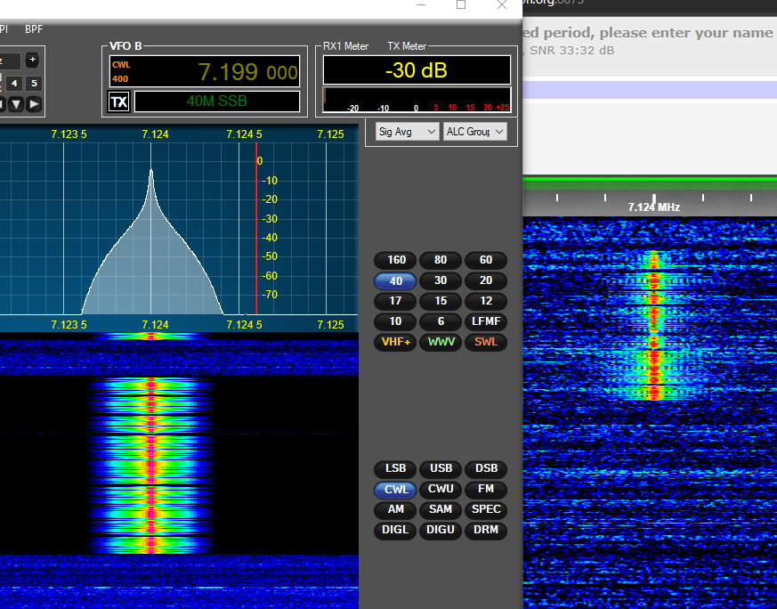

Hi, it was the 80m/75m amateur band in the US. 3.901 MHz. It is a resonant antenna, a large multi band fan dipole.

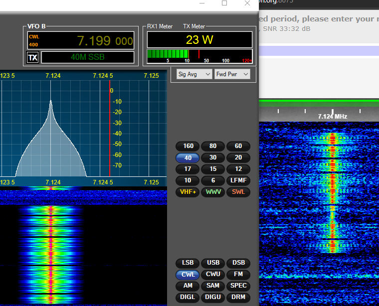

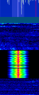

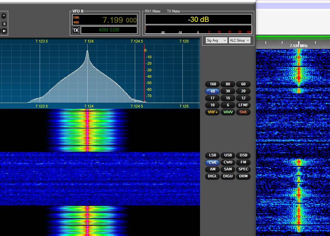

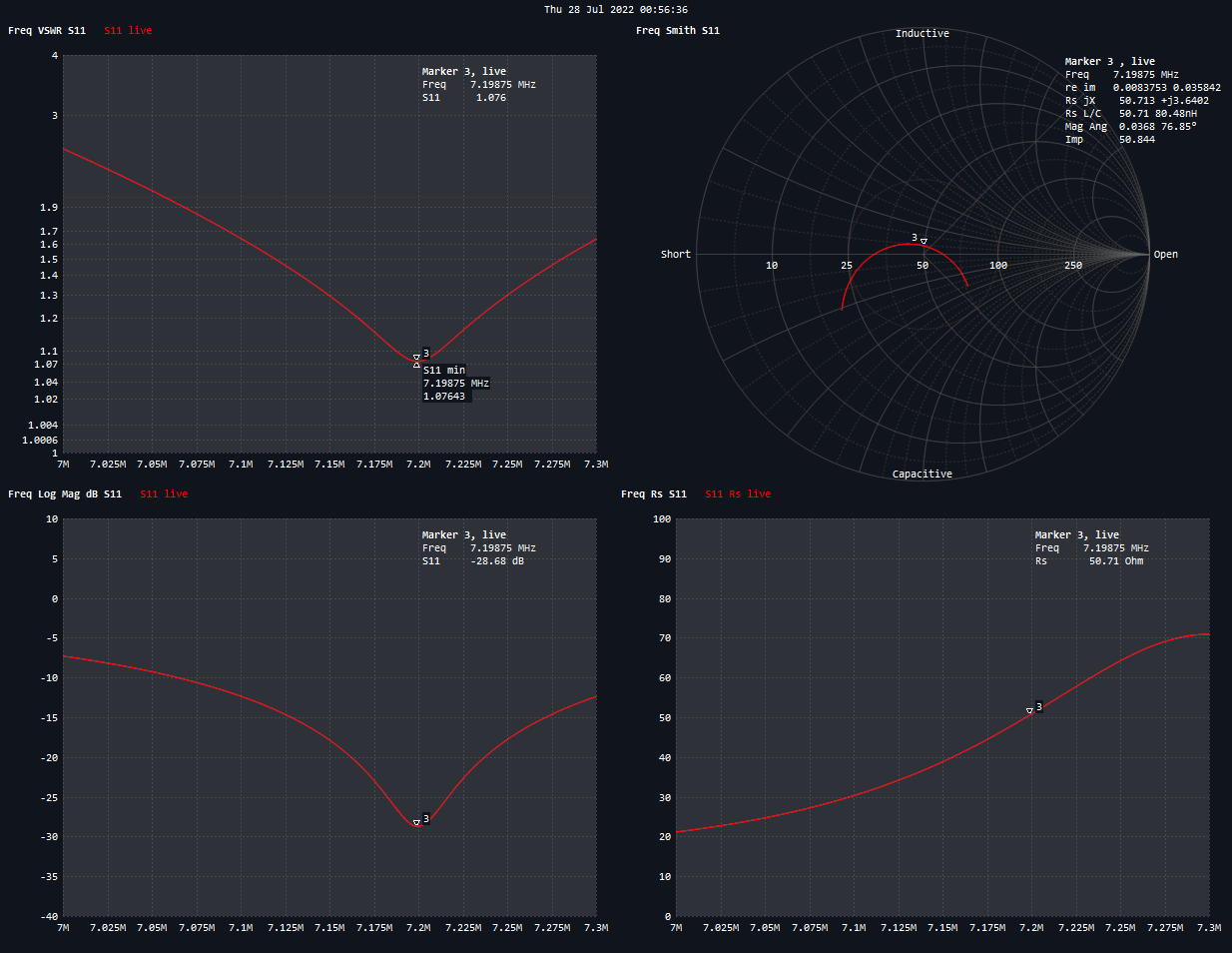

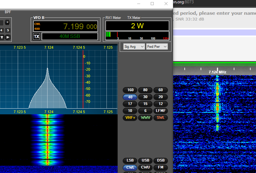

Here it is on the 40m band. Antenna SWR is about 1.5 at this freq. There's nothing else in line, the tuner is bypassed for this. Seems pretty much the same.

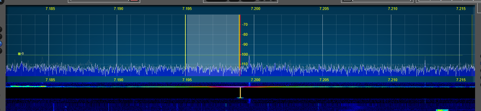

I've discovered another issue as well. While sending CW into my dummy load, which is attached to ANT2, some blips can be seen coming out of ANT1, which are being transmitted over the air. I was pretty surprised to see that...see image at the bottom.
From 100W to 5W, the same behavior is seen.
100w
100w
50w
50w
25w
25w
5w
5w
VNA-40m
VNA-40m
ANT2 transmissions leaking out on ANT1
Screenshot 2022-07-28 012321.png (2.05 MiB) Viewed 6251 times

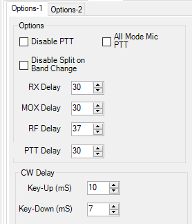

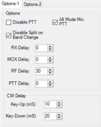

Curious about the time delays on the Options form. My PTT delay is 0 and the RF delay 30 ms. Not that this necessarily explains what you are experiencing. The difference between the PTT delay and RF delay in your case is very brief compared to mine.
Options 1.jpg (29.74 KiB) Viewed 5847 times
I am not using the same Thetis version as you and also I am on Protocol 2 (radio is ANAN 7000 DLE MKII).
Thetis v2.9.06. x64 Protocol 2 v2.1.18
What W9AC suggests would be good to have.
73 de Juha

Paul,

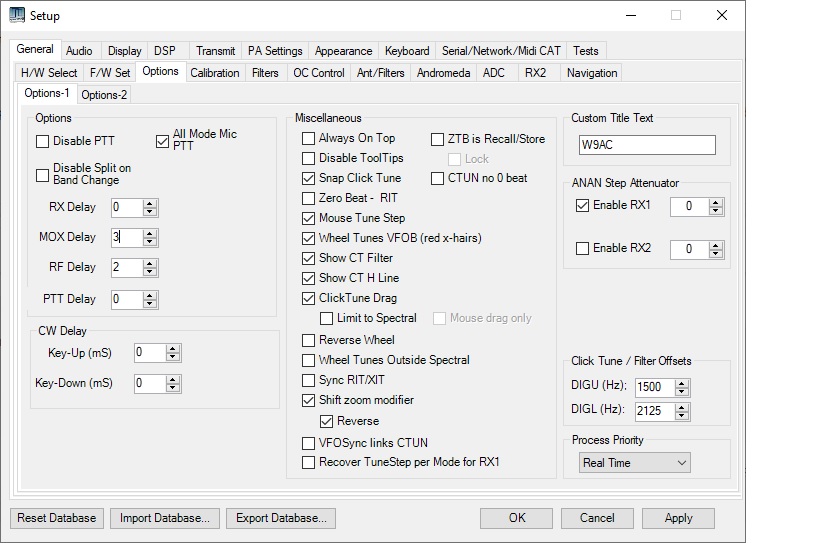

I am wondering what the numbers are on Options 1 form in your case? Mine may be off for all I know. I have only changed the PTT and RF delays, nothing else if my memory serves.
73 de Juha
w9ac
Posts: 321
Re: Poor quality CW and noise bursts start and end of xmits
Post by w9ac »
JJ4SDR wrote:Paul,
73 de Juha
Juha,
My CW settings won't apply to you for several reasons as I'm using a specialized Channelmaster.dll file, ASIO drivers, and some hardware modifications to optimize QSK. All delays are set very low, some to zero. As you requested, I have attached my Option 1 settings but please do not attempt to use these values.
