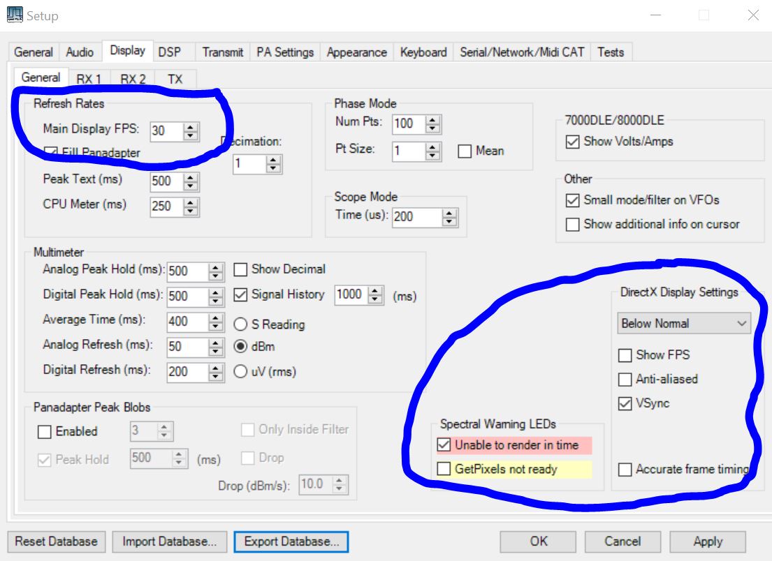

I would check one more thing before pursuing a separate, dedicated NIC for the radio, and that is making sure Main Display Refresh Rate is properly configured. Make sure that the Unable to Render spectral warning LED is turned on, and that the VSync option is enabled. Then look for a red box (may be solid, may be flashing) in the upper left corner of the spectral display. If a red box is seen, lower the main display refresh rate until it goes away.
For instance, I have 30Hz displays. If I make the FPS 31Hz I start to run into problems. However, even with that properly configured I still needed to add a dedicated NIC to get buttery smooth audio while still allowing the computer to do other things like web browsing.
