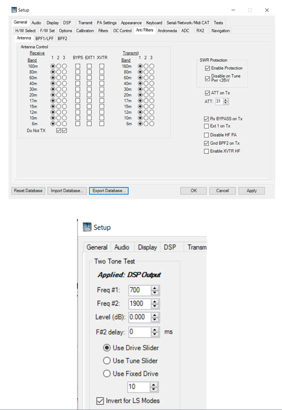

Long story, but I have several amps and for PS I am going to use the RF2K-S SS full-legal limit PA that features 2 LDMOS transistors in the final stage. It also has a built-it RF coupler that provides an attenuated output of - 55 dB for use with PS. From what I see Scott writing, that may not be an "optimal" level of attenuation. Well, that - 55dB is a theoretical value any way.
Below, see a screen capture of two forms. Should you note something that is off or incorrect, let me know. NOTE: The "ATT on TX" setting is very high. I played with it several months ago as I thought that what I was seeing when DUP on the main GUI is set (I have it ON always) was a very wide TX bandwidth, but that is only "normal" and I think I will need to adjust it back to its default value (I don't recall what that value was). I see some of you have it set at 0. When "Rx BYPASS on TX" box is checked, the transmission looks completely different of course, no matter the ATT value so I guess I don't need to mess with that setting after all.
Form settings for PS.jpg (79.71 KiB) Viewed 27482 times
Q1: If I have understood the PS correctly, after I have gotten the PS working at max 1.5kW RF out, can I assume that linearity of the output from the amp will be equally good at 1kW or say 800W?
Q2: I also operate CW quite often and am wondering what kind of benefits I can expect on that mode? My thinking is that the benefits are more "clear-cut" when using wider bandwidth modes such as SSB, correct? I don't operate RTTY or FT8 for instance (might, in future).
Q3: S-ATT levels: I will need to re-read the discussions on the levels as I think that I need to be careful with this parameter and how to set it correctly.
Q4: I recall seeing Scott recommending that I should be hitting the ALC hard and that I should see "ALC Group" figures of 0dB on a consistent basis and perhaps even +3dB at times. This, to enable the PS to work well (Scott had a more expert and technical way of saying this). I also see someone else talking about having the meter set for MIC, with recommended figures to hit (max 0). Which of these 2 parameters should I go by and what are the pros & cons of using either?

JJ4SDR wrote:Long story, but I have several amps and for PS I am going to use the RF2K-S SS full-legal limit PA that features 2 LDMOS transistors in the final stage. It also has a built-it RF coupler that provides an attenuated output of - 55 dB for use with PS. From what I see Scott writing, that may not be an "optimal" level of attenuation. Well, that - 55dB is a theoretical value any way.
Yeah, it's 5dB too much from an "optimal" perspective, but it'll be fine, it will work.
This will automatically change under control of the PureSignal "auto attenuate" feature. If you are not using PureSignal yet, or for some reason turned auto-attenuate off (don't!), then this will remain where you set it.
If you use the radio without the amp this will need to be turned off so that the radio will use the internal feedback coupler. When using the amp this should be turned on (and the amp coupler output attached to the Bypass connector). If you merely put the amp in standby you may still need to turn this off because a -55dB coupling factor is very high for 100W or less operation.
Maybe, maybe not. The amp should be more linear at lower power levels, but feedback SNR will also be lower thereby leading to some degradation in PureSignal performance. It may be an even trade with that amp, you'll have to tell us.
There is no benefit to using PureSignal with CW. Since CW is a single-tone signal amplifier linearity does not come into play. Turn it off for CW.
The same is true for single-tone digital modes like FT8.
For multi-tone digital modes like VARA, Olivia, etc., PureSignal can be extremely helpful, but such modes do not work well with PureSignal's fully automatic mode. It is best to use Two Tone and the Single Cal button to set and lock-in a correction and then just let that ride.
Where PureSignal really shines is on phone modes. Put it into automatic mode and let it do its thing.
There is nothing to set. You are stuck with the -55dB coupler, which should generate safe feedback levels at 1500W, and you let the PureSignal auto-attenuate function take care of everything else.
I must disagree with Paul. Never exceed 0dB on any audio level reading anywhere in the front part of the audio chain. That includes Mic, EQ, and Leveler. Use the post-EQ level to gently allow seeing ALC Group levels as you have stated. Also go to Setup > DSP > AGC/ALC and set ALC Max Gain to 3dB.

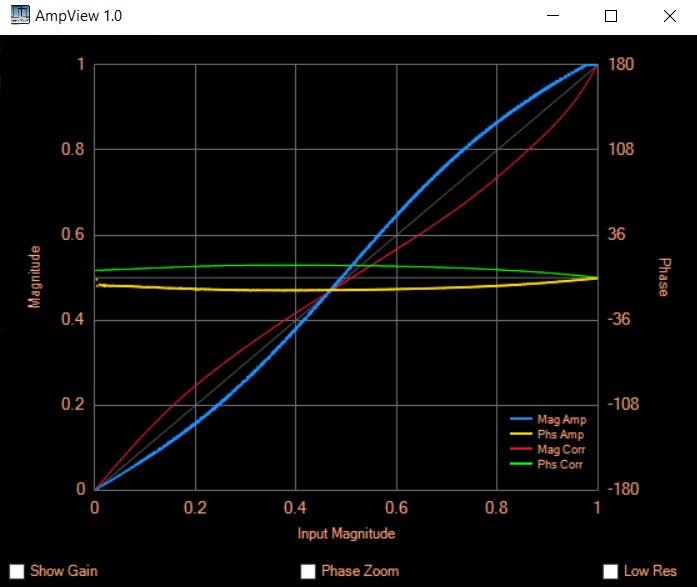

Below, see Amp view from my very tests of Pure Signal. The meter is showing +3dB (+4dB VERY rarely) on peaks when I observe the "ALC Group" parameter. Can someone comment on the graphs? Seems like I will need to do some "tweaking" somewhere. I was putting out about 1kW (15 meter band). The second image - at bottom of page - is the Amp View is when I went on 17 meters (putting out almost full-legal limit). On 20 meters, I am not getting good enough feedback at all.
1st Amp View.jpg (63.53 KiB) Viewed 27228 times
Q1: Do I need to carry out the two-tone calibration for every band that I operate the amp on?
Q2: Can I assume that once I have successfully conducted two-tone tests I don't need to redo any of it and just switch Pure Signal on from the main GUI?

JJ4SDR wrote:Below, see Amp view from my very tests of Pure Signal. The meter is showing +3dB (+4dB VERY rarely) on peaks when I observe the "ALC Group" parameter.
That's perfect.
In general the characteristic S shape you are seeing is very good, very normal, and generally indicative of the normal non-linearity of the average amateur radio amplifier.
However, the data looks a little noisy.
The noisy data, combined with this statement, implies that something is not correct in your setup.
- Is auto-attenuate enabled?
- Is Atten on TX enabled?
- Is RF Bypass on TX enabled?
- Is the cable between the amp coupler output attached to the RF Bypass input?

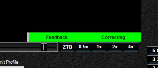

- Are you seeing the Feedback and Pure Signal 2 indicators turn bright green as shown?
- MOST IMPORTANT: what are you seeing on the S-ATT display during TX?

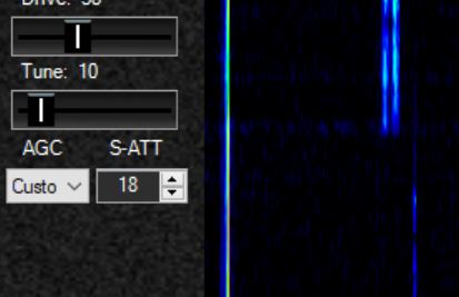

Went on 20 again and this time I let the 2-Tone test run for a little longer (took a bit longer than it did on 17 and 15). Both Feedback and Pure Signal2 were in the green with S-ATT reading saying 18 on that band.
The S-ATT reading says 17 (under AGC, it says "Med", not "Custom") when transmitting and Feedback and Correcting (Pure Signal2) are all green.
Re: New to PS Use (ANAN 7000 DLE MK2)
Posted: Fri Sep 23, 2022 8:50 pm
18 dB is a perfectly acceptable step attenuator setting for PureSignal during TX. It sounds like it is all working perfectly and you are just getting used to how it works.
Assuming you were transmitting at 1500W, the 18 dB step attenuator setting arrived at by the auto attenuate implies a 55dB loss in the coupled path from the amp output, which is exactly what you would expect, so all is well. The math can be found here.

Pure Signal is a very effective and highly visual tool and I really like it. Using an RF2K-S solid state amplifier with my ANAN 7000 DLE MKII.
I am a little puzzled by what I am seeing on the 40 meter band vs. other bands (same multi-band antenna used on those bands). The same TX profile is used as well on both bands although I must admit that my audio chain likely contributes to the phase noise in particular as I am using both Plug-ins, CFC, TXEQ and the Leveler in the ANAN. I have switched out all plug-ins, one at a time to see if the phase noise goes away to no avail. Took the TXEQ off too. The other, narrower 3.3K TX profile does not have the TXEQ in it at all, only CFC and Leveler, but the plug-ins are not the same as in the wider 4K TX profile that may result in much more phase noise.
Switching over to another TX profile and operating on those same bands (40 & 17) I don't see much phase noise at all. The curves look more like they should when using the other - narrower - 3.3K TX profile.
Below, screen-captures. Even on 17, the Amp view looks a bit "funky", like there is noise Mag Amp and even more noise in the "Mag Amp" on 40 meters. The phase noise on 40 m was captured at the very first utterance of words into the mic with the noise becoming less pronounced after the first word into the mic.
Any suggestions on what else I could try would be appreciated.

What exactly are you seeing that you're referring to as "phase noise"?
Posted: Tue Sep 27, 2022 1:51 am
JJ4SDR wrote:I am a little puzzled by what I am seeing on the 40 meter band vs. other bands (same multi-band antenna used on those bands).
There is nothing to be puzzled about. The linearity of the RF chain from the DAC output to the coupler in the amp can be different on every band. The curves you are seeing are quite typical and normal. You might not be driving the amp as hard as it will allow on 40M. Try a little more drive and see if the curve changes to an S-curve. If not, don't sweat it, either curve it totally fine and normal.
The same TX profile is used as well on both bands although I must admit that my audio chain likely contributes to the phase noise in particular as I am using both Plug-ins...
What you drive the RF chain with matters not at all as far as PureSignal is concerned. The only requirement is that it be driven over the full dynamic range of the DAC, i.e. from 0 drive to 0dB ALC, or all zeroes on the DAC input to all ones. Any TX profile that is driving over the full dynamic range of the DAC will result in the same curves as long as the RF drive settings have not changed. You will get the same curve with two-tone, although it may appear as a dotted line due to the characteristics of two-tone modulation. Any noise in the result is because the variability of human speech cannot be guaranteed to hit every spot on DAC dynamic range reliably. For TX profiles that are highly compressed you may see noisier results at the low end of the input magnitude range. Don't worry about it.
PS takes some time to settle back in on each transmission. Also, after the initial major settling period, with solid state amps you will see a second slow (several seconds) settling period as the FETs heat up, as they cool down quite quickly after each transmission.
There's really nothing else to "try". Those results are as good as they get. You are doing everything correctly.
Your desire to fully understand how this all works is laudable. The only other thing to experiment with is drive level, mostly so that you understand what it looks like to overdrive the amp. By all means turn up your drive and watch those curves. You will see the blue curve start to flatten out and try to become horizontal at the top right corner. This is bad and is indicative of overdriving the amp into strong compression. PS will fight you tooth and nail and it is really remarkable how much overdrive it will tolerate. You'll probably also see other distortions of the curve at that point. See where it starts to get ugly on each band and make a note of the drive level to stay under. These curves are a much more reliable way of knowing where you stand drive-wise than the wattmeter.
