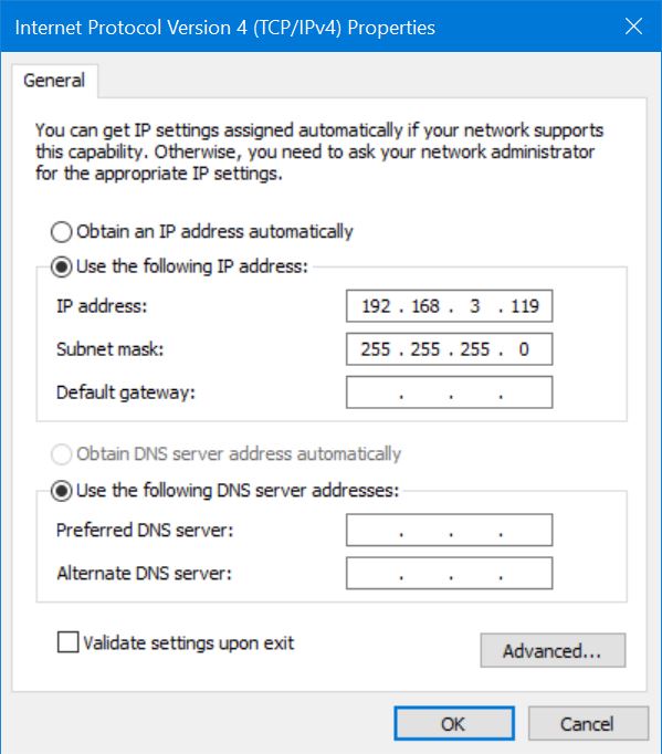

Bootloader says check for J1 when the switch is in the normal/run position so between that and I did mark it before I touched it I think it is as expected.
I did use bootloader to re-write the IP to ANAN 192.168.5.2, still no joy on the ping
double checked IPV4 on the NIC and it looks ok on all panels

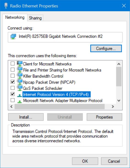

I have a dual NIC setup. No Wi-Fi (remember that counts as a NIC). House network is 192.168.1.x with a metric of 100. Radio network as shown. Every unnecessary protocol is disabled. ANAN IP is set to 192.168.3.2. It showing GigE speed because I'm running P2.

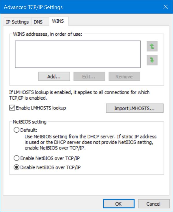

Tally HO....
Only thing I changed was on the NIC config screen,,,
Advanced TCP/IP Settings, WINS tab
Default was checked, I unchecked it and checked Disable Net BIOS over TCP/IP
Pings coming back normal now from the ANAN
Powered up PC and PowerSDR hit power on and BINGO, we are a blip on the radar.
I just have no idea how that NIC config got changed. But now all the code in the ANAN has been loaded fresh so thats always a good thing.
Thanks Scott for sticking with me on this. I really appreciate it.

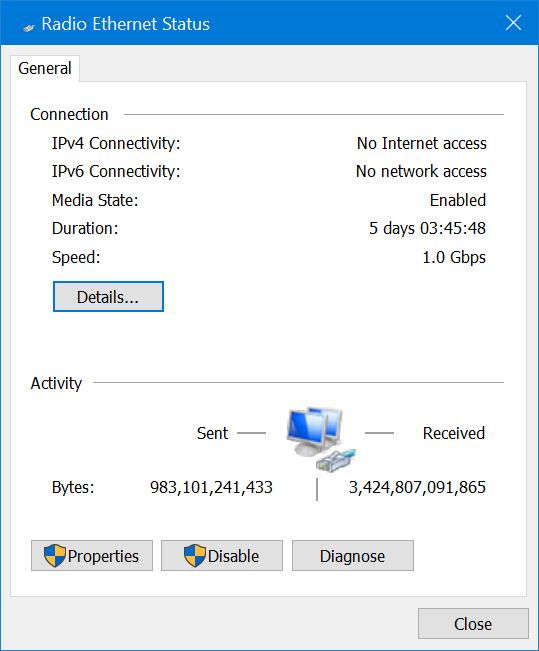

Did you confirm that your NIC is GigE? Did you at least get a link light and a GigE indication on the NIC?
Re: ANAN 7000DLE serial 81....Error starting SDR hardware
Posted: Mon Sep 26, 2022 4:10 am
by pemmel
My NIC card is a 10, 100, 1000 Mbps at least thats what the spec sheet says anyways.
Yes I did get a solid green left light both times I tried it.
