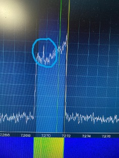

Attached the pictures, Protocol 1, The power on the radio transmitter is higher output to see the carrier Spike out of the RF signal floor, Protocol 2 Power output is turned way down.

In that picture that is Revision 1 and is there all the time, and is WHAT I am talking about, or with the MIC plugged into the radio or not and from 1 to 100% Drive levels.
To see it in the TX spectrum on the Radio scroll up 10 or 20 DB on rev 1 and I can just see it out of the grass.
On REV 2 looking at the other two pictures that I sent using REV2 ver C and REV2 ver D you see it is SO much stronger.
A station a mile away can barely see that signal using REV 1 running 30 Watts out and is at least -110DB down and is perfectly acceptable and legal but with REV 2 it is +30 to +50 DB higher, which you can see in the Picture, and I can see it with the same process as above using the ANAN TX spectrum.
He hears it about 10 over S9 when I key using MOX with no MIC plugged in running the same Power level using SSB with no MIC he should NOT hear anything at all.

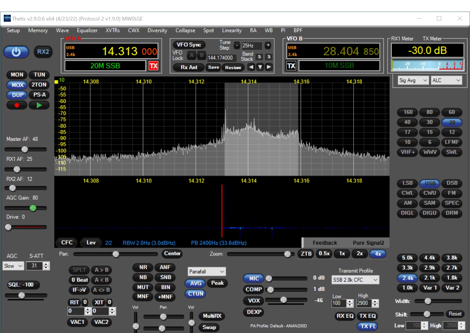

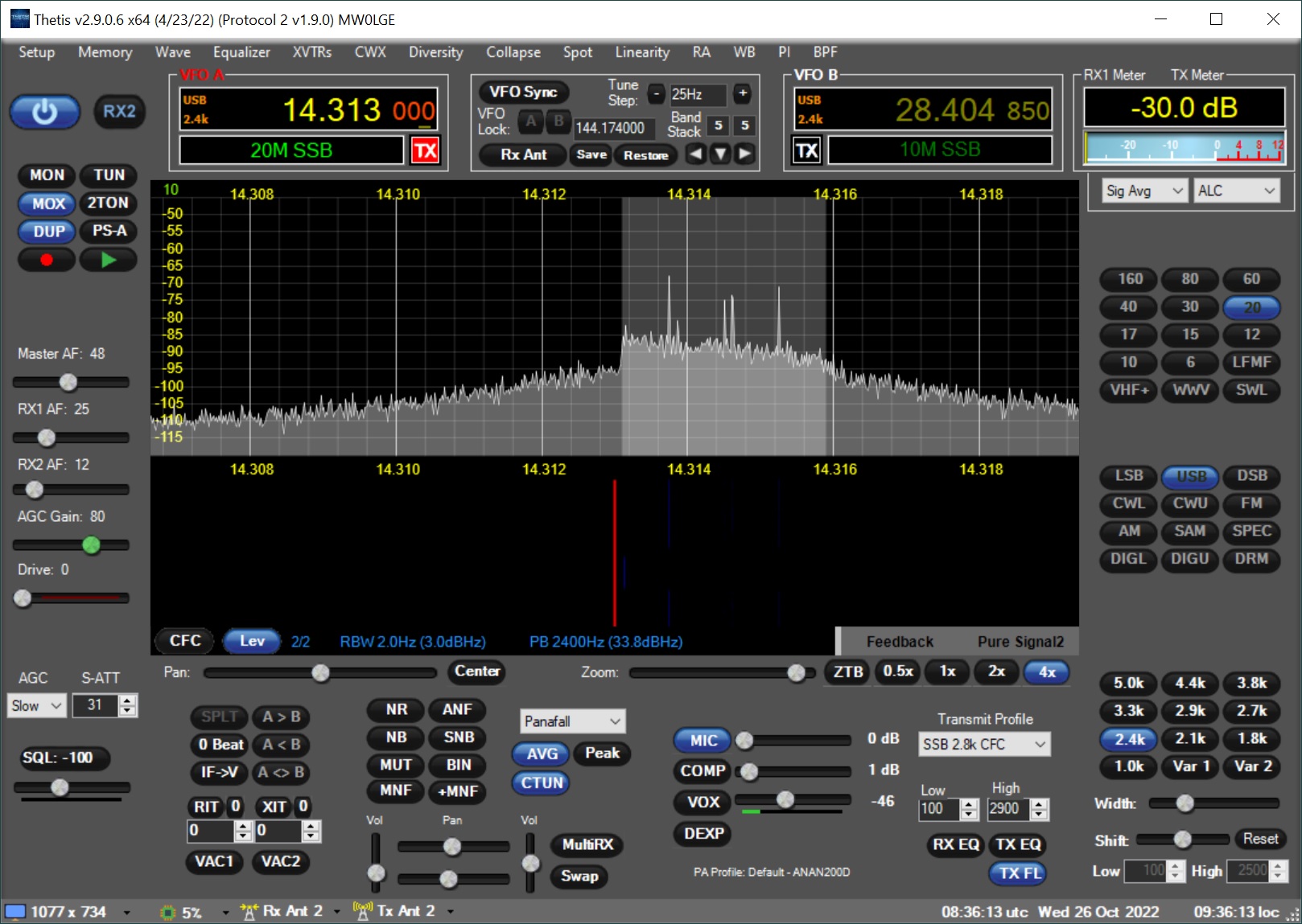

Sure, no problem whatsoever, here you go
These Pictures taken using the Thetis TX Display and are named for what they are displaying in case they get confused in the upload.
1st Picture "MIC Boost" ON, REV1, MIC unplugged, still there just harder to see because it's in the Noise
2nd Picture "MIC Boost" OFF REV1, MIC unplugged, there are actually 2 birdies that show with the lower MIC gain but still there.
REV 1 Is acceptable on the over the air testing.
3rd Picture "MIC Boost" ON, REV2, MIC unplugged, Pops right up out of the TX Noise floor
4th Picture "MIC Boost" OFF REV2, MIC unplugged, Pops right up out of the TX Noise floor
REV 2 Is not acceptable on the over the air testing.
The MIC level is set at "0" in these test

did another test with REV 2 C,
I turned off the 20DB Boost and turned up the MIC gain to approx. 17DB so the Mic levels are -10DB down on the ALC meter (same as with MIC Boost) BUT ALL of the TX grass is substantially higher, and the birdies are buried down in the INCREASED TX Grass, here is the Picture of it in this configuration.
Woops, the Display range changed turning up the MIC gain so there IS lower Birdies with the MIC boost off and MIC gain set to +17DB

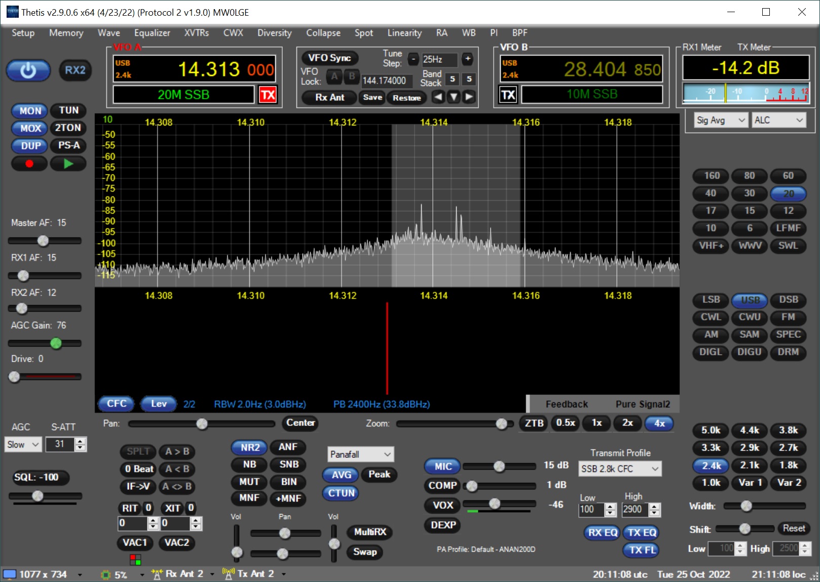

Want to share an interesting observation with MIC input “static” levels on the 100D
100D audio chain birdie.jpg (421.07 KiB) Viewed 26691 times
To me it looks like a “birdie” – its approx. 2450Hz offset from the VFO frequency (on either sideband – whichever is selected – here it’s on LSB)
I can totally remove this “birdie” using the Equalizer (TX) and simply “tuning out” at 2450Hz
Obviously, this creates a “hole” in this passband – not desirable.
Varying the audio chain “gain” will not suppress this “birdie” on its own – it will move the entire passband – including the “birdie”.
Under operating conditions – this “birdie” has little noticeable effect – unless there is “dead audio” - then the 2450Hz can be heard – albeit very very quiet.
I have “pulled” the microphone from the MIC socket – so this “birdie” appears to be generated inside the radio.
Has anyone seen similar effects in their radios?
Is this “birdie” caused by some stray harmonics entering the audio chain?
I did not look in detail at the schematics – thought to share this observation first – just in case its something common and a known artifact.
Hope the above information / observation serves some greater need :oops:

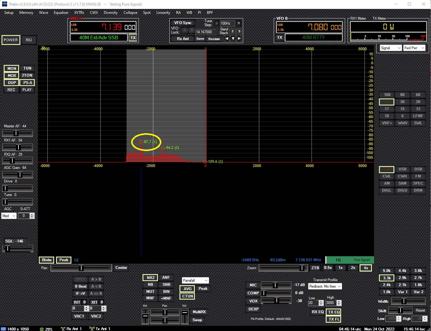

Scott alerted me to this thread. I have been experiencing similar 'audio birdies' almost exactly as described here with my 200D mic input. For me this happened several years ago and I swapped to PC audio, which I used successfully until I hit a reverb problem recently (in another thread).
Here is a screen shot of my mic audio spectrum- you can clearly see the peaks present giving the birdy type interreference. These audio tones are heard on TX and cause a real degradation of signal quality.

I don't see this on my 100D or 8000. They are both very quiet. And there are not a lot of reports on this issue, although perhaps we'll see a few more now that this topic is started. But it hardly seems epidemic.
My gut feel is that this is noise from one of the internal switchers or some sort of clock noise affecting the CODEC chip itself, and nothing to do with software, firmware or the FPGA. Perhaps something along the lines of this topic: viewtopic.php?f=17&t=2922 (Jim did a fabulous job of fixing his ANAN if you read through the entire topic).
I just took a screen shot of what's coming out of my 8000. Nothing plugged into the microphone port, mic boost off, mic gain maximum. Transmit passband is 50 to 3500Hz (quite wide). Protocol 2 is in use.
It looks essentially the same mic boost on or off, mic or line selected, on all bands. When I turn on MON and turn up the volume I just hear normal noise akin to white noise, there are no obvious tones. It is quite an odd shape, though, not at all flat, and I have to wonder what is causing that.
