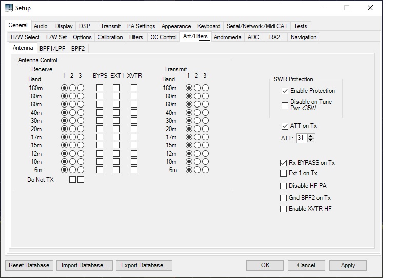

Ron,
Although I can't be of much help, I've attached a screen capture of my Ant/filters menu. It hasn't changed while operating ever since saving the profile under the "Transmit Profiles" menu.
Possibly try to create a new profile name, then save it and see what happens. If that fails, then it may be time to consider a database reset.

Paul, K9AC, thanks for reply. That's how my selections look too except I ground BPF2 on TX as I have receive antennas connected.

Hi Ron,
Previously, 31dB of 'TX' attenuation was always applied when PS-A was off
Richie made a change so that whenever change tx mode the att is not resetting back in 31db. So if you use your transceiver with or without amp in different modes is very easy to overdrive your input.

Hi Mike, there will be an option to apply this in my next version, soonsv1jso wrote:Hi Ron,

Mike, thanks for that info.
Richie thanks for incorporating the choice in your next update. To me, seems that there is no harm in keeping the attenuator level unchanged until the operator goes in and changes the setting. Perhaps I'm missing the benefit of having it change based on mode.....
