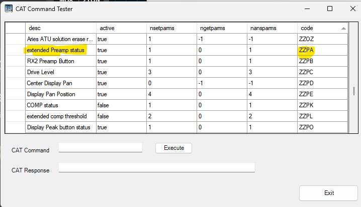

Using the built-in CAT test facility of 2.9.0.6, I get back nothing from any version of this command except ZZPA; which returns ZZPA1;
