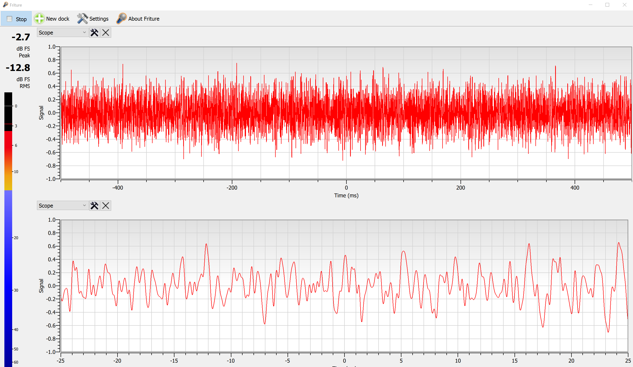

I had promised some scope traces, so here they are.
I used the Friture app (https://friture.org/) to visualize the digital audio stream. It is quite handy. Here I have visualized both short term and long term audio, and on the right the RMS level is noteworthy (the peak varies too much).
Here is the audio output of noise at 5KHz deviation and RX1 AF of 30:

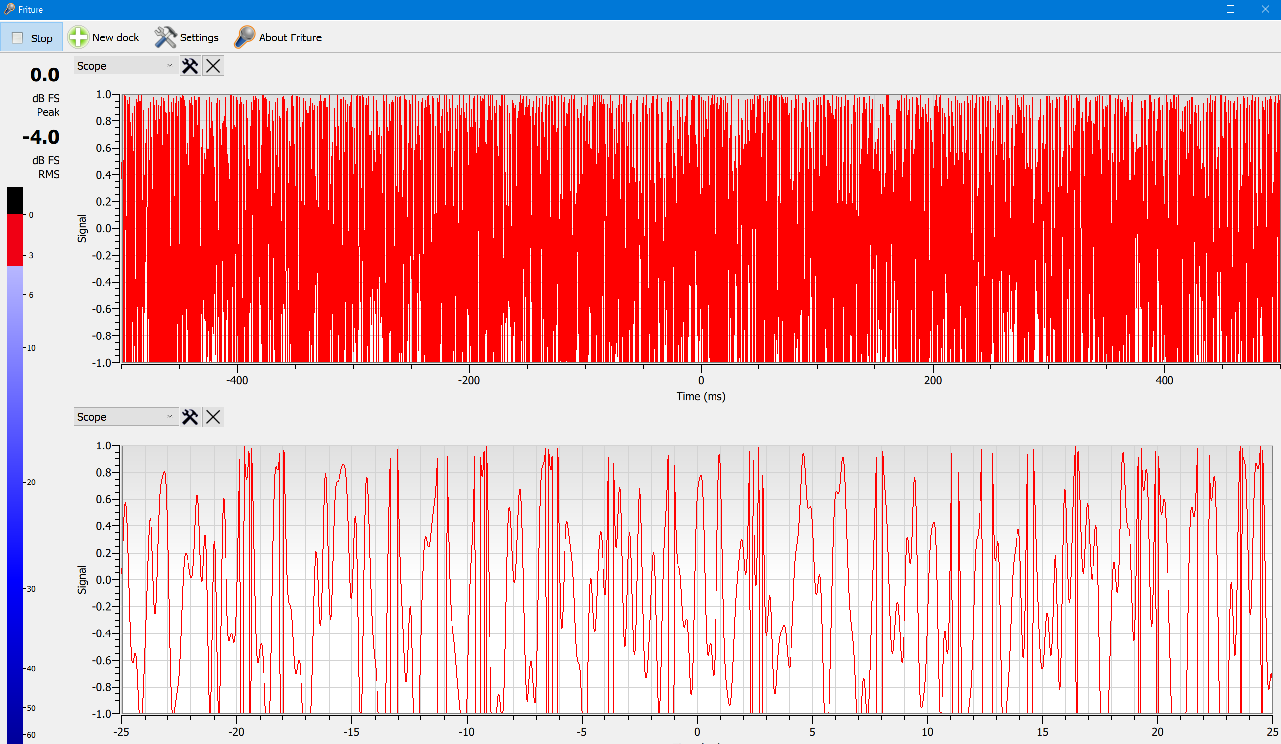

Here is the same thing with RX1 AF at 100. The positive peaks are reaching but not exceeding 1.0 (0dB), i.e. I don't believe there is any positive peak clipping, but the negative peak clipping is obvious and massive.

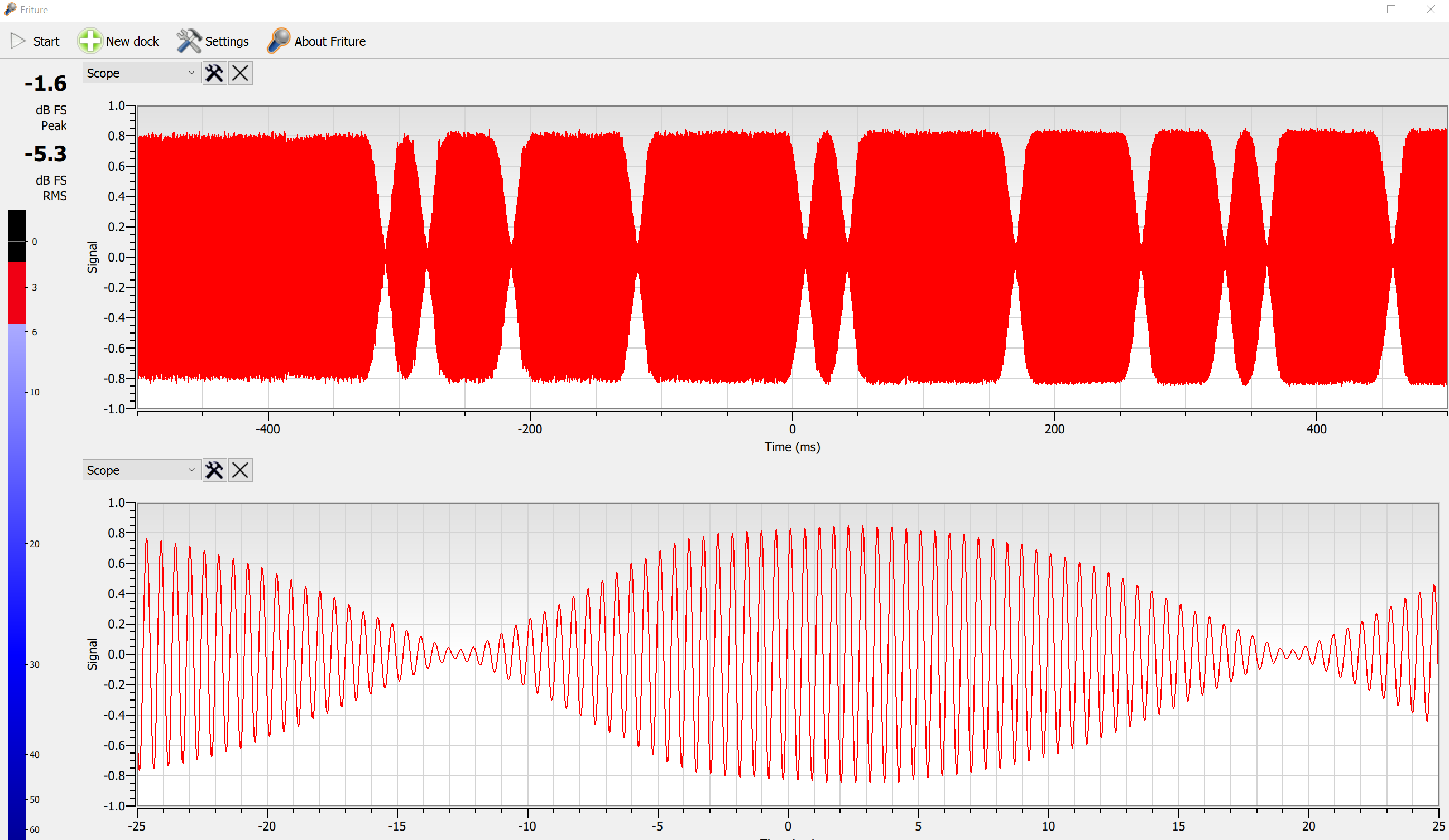

In contrast, it is impossible to create this condition in LSB, USB or CW modes. For example, I found an S9+20 digital signal. I set mode LSB, bandwidth 3.3KHz (more than enough to encompass the entire signal), NR OFF, AGC Gain max (120), RX1 AF 100. All other settings the same as for FM. The audio output never gets beyond approx. -1.5dB and it is completely symmetrical.
