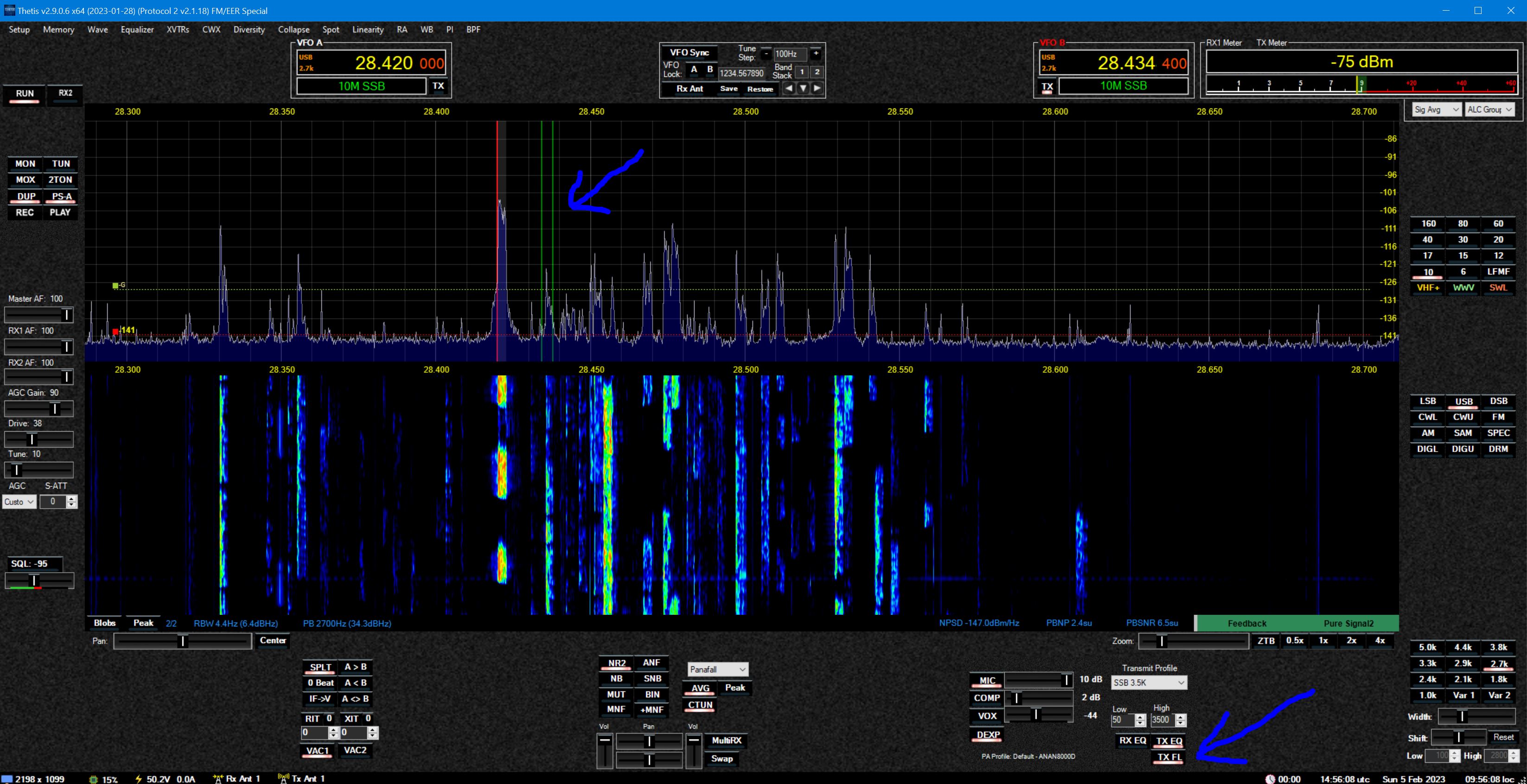

How about turning on the TX FL button to show your TX passband?
Re: Split Function
Posted: Sun Feb 05, 2023 2:58 pm
Example:

WA2DVU wrote:I want to be able to have a second panadapter to view my transmit fx
That was the question I was answering.
It seems you wanted a lot more than that.
The good news is you figured it out for yourself. The procedure you more fully describe is exactly what everyone does when trying to bust an "Up 5-10" type pile-up.
