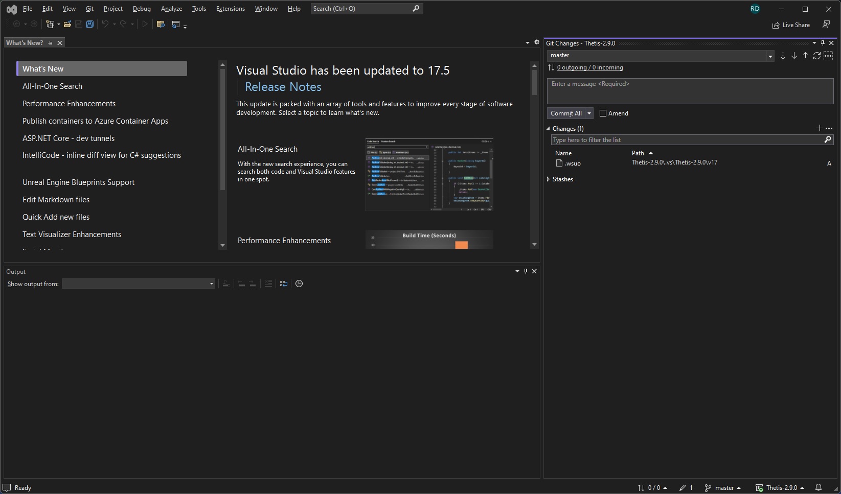

Did you use the VS Extensions menu to install the WiX v3 Visual Studio 2022 Extension and WiX Toolset v3 for Visual Studio? If not do that first.
When VS opens you should get a window that has a list of "get started" tasks. Select "open a project or solution". Navigate to
C:\Users\yourwindowsusernamegoeshere\source\repos\Thetis-2.9.0\Project Files\Source
There you will find the .sln file and you can open that.
Then at the bottom right select the multimeter branch (not master).

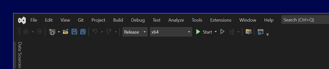

You should get a toolbar where you can select the build to be release and x64.
