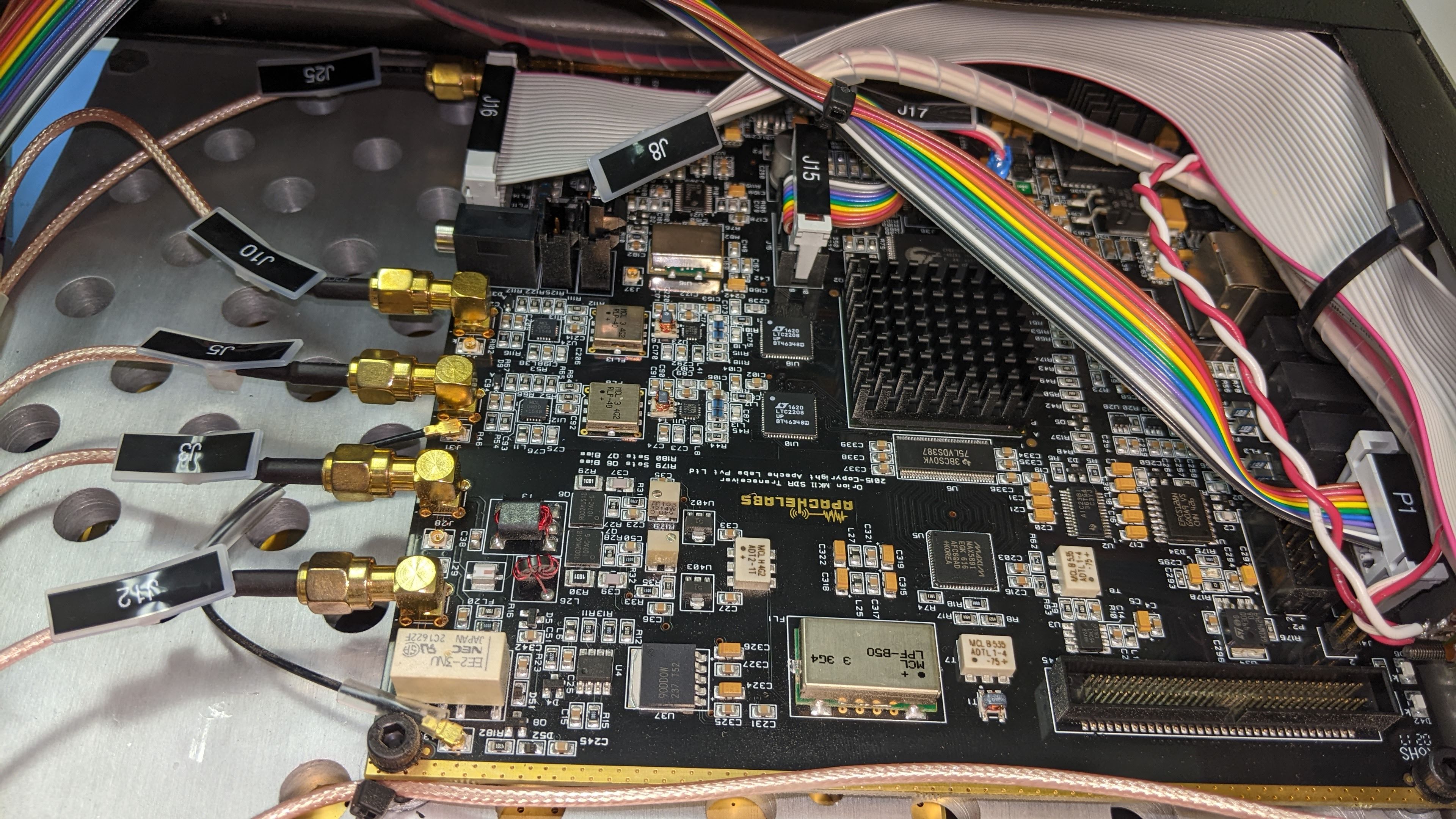

You'll see on the schematics that there is not a lot to go wrong between the mic jack and the CODEC chip. It's unlikely it's any sort of bad solder connection since a power cycle fixes the issue. Since you are not using mic bias we can't blame a failing mic bias circuit. If we assume it's not corrupted firmware, then there's not much left to consider. It could be a failing CODEC chip. Or it could be a failing FPGA that is either sending erroneous control data to the CODEC or failing to process the audio data from the CODEC properly. Replacing the CODEC is easy. A failed FPGA generally means a whole new board because it's a BGA package, and because Cyclone IV's are no longer available.
It will be easy to probe the CODEC during operation, but it's probably not going to tell you very much. Just take the bottom off and run the unit upside down. It's a bit fussy to disconnect the fan from the PA board, you either need to use a mirror or temporarily pull the top cover. Unfortunately Apache chose to tuck the Orion board under the curve of the chassis, which IMHO was not a smart move, but luckily the CODEC, U2, is easily accessible.
If you choose to only send the board to Doug instead of the entire 8000, the only difficult part is getting the cap screws out that are under the curve of the chassis. I reached under with an Allen wrench for initial/final torque, then used a too-small ball end driver poked through the vent holes to run them in or out most of the way. If you drop a fastener, well that's a good reason to have pulled the top cover off ;) Also be aware that there is a small heatsink on the underside of the Orion board that presses on the main 8000 heatsink plate. You will need some fresh thermal grease for reassembly.
These are some photos I took the last time I opened my 8000. The labels on the cables are mine, the factory doesn't do that. U2 can be seen just off the bottom right corner of the FPGA heatsink in the photo.
