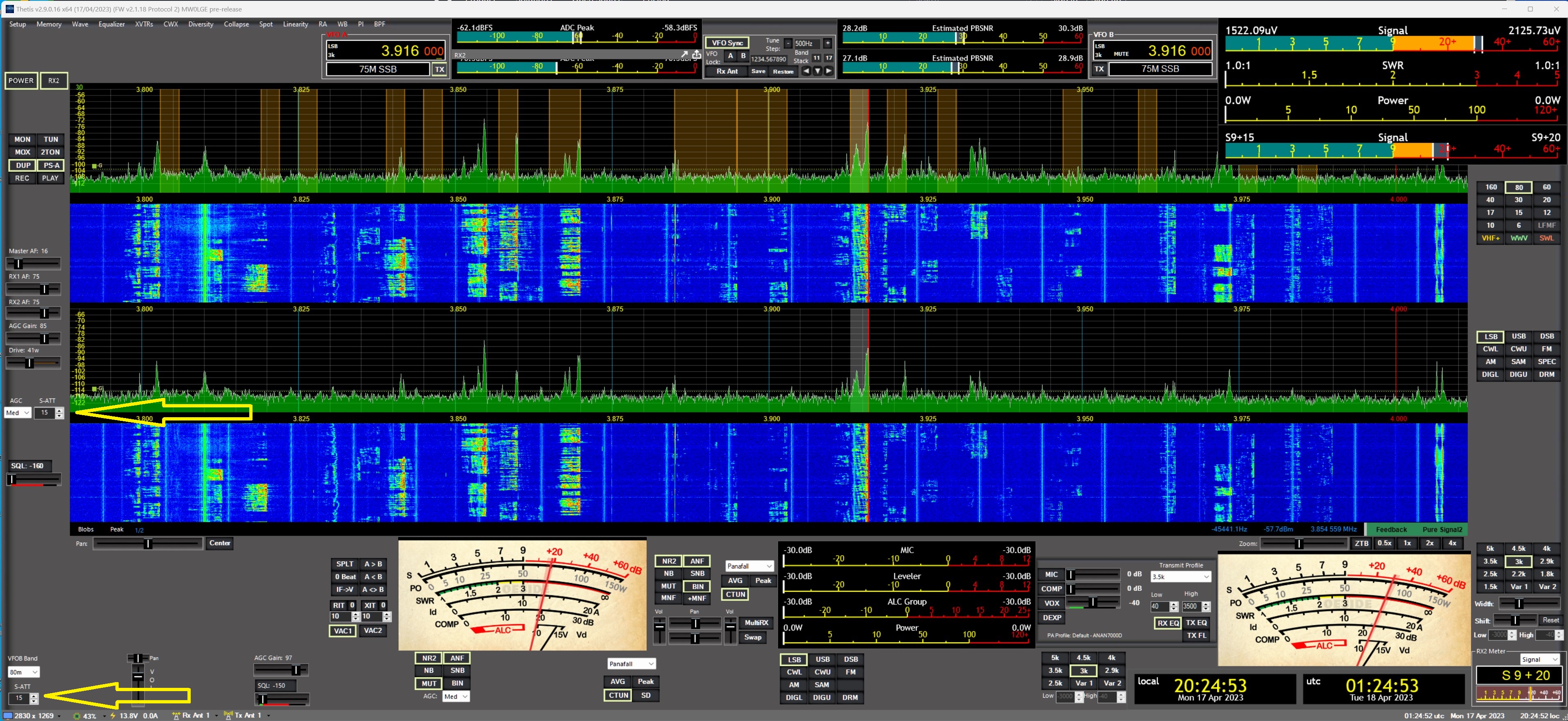

Re: ADC2 Overload! error?
Robert,
See the pic attached, the two yellow arrows on the mid- and lower-left portion of the screenshot are pointing to the S-ATT attenuation settings.
The upper arrow is pointing to ADC1 attenuation, the lower arrow is pointing to ADC2 attenuation.

As proof of that, look at both receivers in my picture above. The upper receiver is on a tuned dipole and the lower receiver is on a wideband active mag loop, which doesn't capture anywhere near as much energy as a dipole. But look at the PBSNR meters in the upper middle portions of the screen. Those meters show nearly equal S/N ratio for both ADCs, even though the S-meter signal strength of ADC1 is at least 10dB higher than ADC2 (which can be easily seen on any of the several pairs of S-meters strewn about my console, lol). In short, attenuating a signal doesn't adversely affect the readability of any signal at all. As long as a signal is above the noise received by the antenna it will still be the same relative level above the noise after everything is attenuated.
Go ahead and dial in some attenuation and see for yourself that the readability of any signal isn't affected at all.

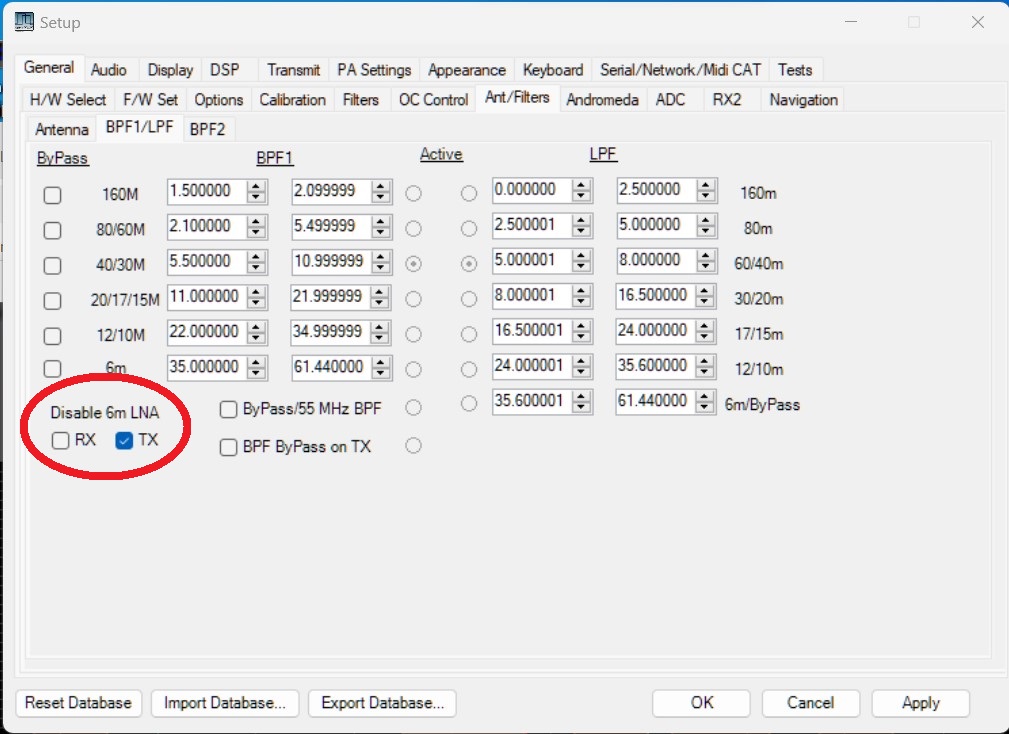

The radio appears to have a 6-meter preamp (Low Noise Amp) that you can enable or disable but I've never used it so I can't attest to its functionality:

Mark, looking at the form you have open in setup, I wonder if I could tweak the lower cutoff freq on the 12/10m filter to just above 27.5 mhz? Would sacrifice the 12m reception but might mitigate the CB overload when on 10 ?

Robert, I've never fully understood the function of those filters, nor the operation of the Bypass/55 MHz BPF.
However, I will report that the effect I'm observing on RX2 of the 6m LNA and the Bypass/55 MHz BPF are not at all what I was expecting.
Sorry I'm not of any help to you there.
