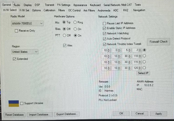

Not sure, but when using the Bootloader (to assign static IP to the radio, as I have done successfully previously), the utility finds the board in the ANAN and also displays the MAC address, but after I restart Thetis, nothing works and no MAC address is to be seen. See below.
Problem with MAC.jpg (98.19 KiB) Viewed 19130 times
