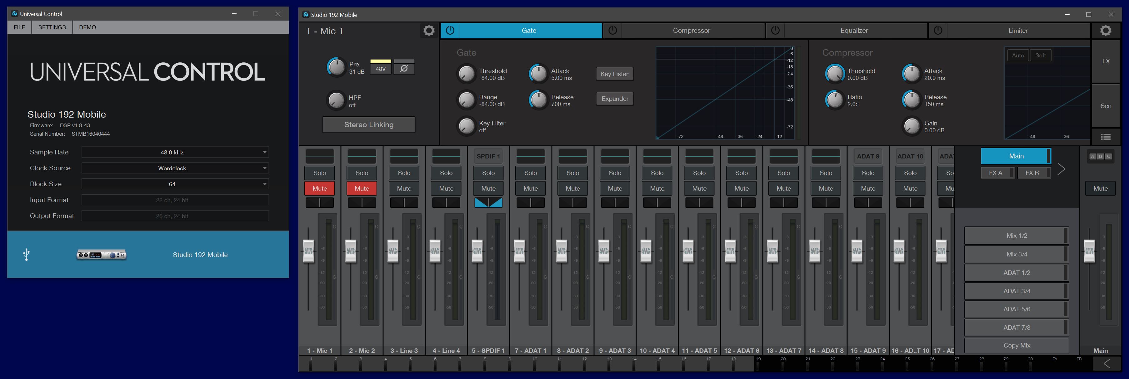

What are you using for a PC sound interface, and is the audio switching automatic between your two radios?
I'm using a Presonus Studio 192 Mobile. I only run one radio at a time. Both instances of Thetis are set up to use VAC audio and VAC is setup to use the mic audio from the Presonus. It's quite possible to run two instances of Thetis simultaneously and both will easily receive audio from the Presonus also simultaneously.
Additionally, how does the latency between the PC sound interface compare to a traditional microphone I/O setup?
With an ASIO driver capable interface (like the Presonus and many others, e.g. Behringer, Focusrite, Steinberg, M-audio--the list goes on), with proper adjustment of VAC parameters latency is lower using the VAC interface than with the audio CODEC built into the ANAN hardware.
And because these interfaces generally provide professional grade, balanced mic inputs and preamps, audio SNR is superior, and EMI/RFI resistance is also superior.
This is similarly true for receive audio. Rather than source it out of the ANAN hardware, it can be sourced via the PC sound interface, thereby obtaining better latency in the receive direction as well.

Unfortunately there is no equivalent replacement for the Studio 192. It was unique in that it was the lowest cost interface available that had an external wordclock (sound studio speak for sample clock) input. Because now that the 192 has been discontinued you have to jump into the over $1K market to get that, which sucks. For that reason the Studio 192 continues to sell on eBay for sometimes more than they cost new! Why is this of interest you might ask? Some of us who are on the bleeding edge are feeding our USB sound interfaces AND our ANAN's with GPSDO derived clocks in order to phase lock them. Not something everyone needs to do!
At any rate you are making the mistake of thinking you need an "equivalent" interface, or at least one that looks like mine. You can do this for less than $100 with a Behringer UMC202HD. The Behringer hardware and driver software is very good. And really all these interfaces are very similar, hardware-wise. They differ only in how good their driver software is. From that perspective I'd say stay away from Focusrite and Steinberg, their driver software is ill-behaved.
I do very much like the Presonus, but their driver and software setup is somewhat more complex (you can do a lot more with it) and might be more than you want to bite off on initially. However, the Presonus Studio 24C will do everything that is necessary, no need to jump up to a 68C or 1810C.
The Motu M2 is also very much worth looking at. It's a little pricey IMHO, but it has unbalanced line outputs on the back in addition to the balanced outputs. This can be handy for people who don't want to feed powered speakers with a balanced connection.

Speaking of this. I’m trying to get my Presonus 26c line out to connect to my icom 7610. It has very low audio level but not sure why. I’m using an isolation transformer but I thought the line level would be enough output to drive the mic input. Do I use Studio One to set levels???? Needing any advice. I know this is vague. Eventually I’ll be using the ASIO to interface with my Anan too.
Re: Microphone/ Audio Interface Options
Posted: Sun Jun 04, 2023 11:45 am
I'm assuming your Presonus comes with the Universal Control driver and app. This usually sits in your Windows system tray. Open it up, then click on your device in the list and it will open up a main mixer control panel (this is not Studio One). Make adjustments there as necessary. You may wish to attach a powered speaker to the line out to facilitate this.
The complex control panel is the thing that makes the Presonus line so flexible, but it can be confusing to those with no audio background. The ergonomics of the control panel also leave something to be desired.

Ahh. This is the piece I knew I was missing but didn’t know what it was. I will tinker with this later today. I did get JBL studio monitors and they sound fabulous. I had some EQ software already and that with those speakers is unreal what you can do with music. I’ll reroute radio audio through it when I get back in the shack. Thanks once again for the great info. 73. Joe NG5U

I can’t get my 26c to bring up the mixer in universal control. It does nothing when you click it…. But…. I got my line output correct for my 7610. It has plenty of audio. I added the noise gate in Studio One to eliminate background noise and it is working fantastic to my radio. This is really terrific! Now if I can just get a new Anan soon, I can’t wait to really explore. But you are right about one thing… the JBL studio monitors are game changers for receive audio!
