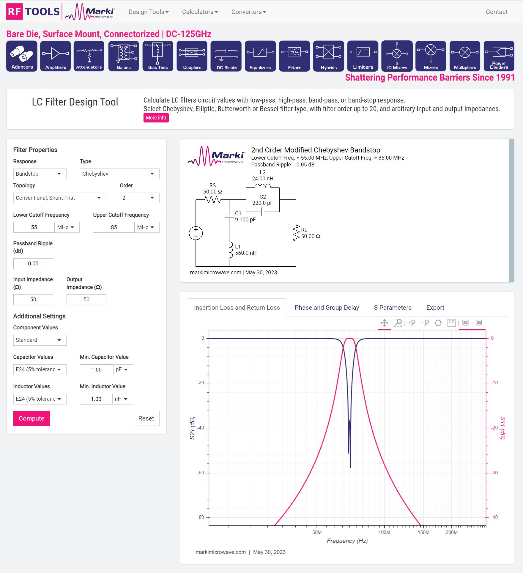

I'm trying to understand how to set the variable notch filter located at the DAC output and centred at around 71 MHz on all Hermes and Angelia buards (C22, L4, C12 ,L3, C13). I don't think I've read anything about this filter in the OpenHPSDR literature.

Interesting question! I didn't have time to put this into LTspice for simulation, but a quick few iterations at https://rf-tools.com/lc-filter/ produced this:
Strange how L3 and C13 are inverted in their order on the schematic.

Thank you, Scott
You had the same reaction I had :- D (except that I'm a lazzy guy, I used Elsie)
I'll try to ask Kjell the question (I already bother him too often about the Munin400/Aries suite etc, I don't dare bother him too much).
I'll simply measure with an analyzer what comes out of the DAC "without" the filter, just to see if there isn't an unsuspected/unwanted birdy.
