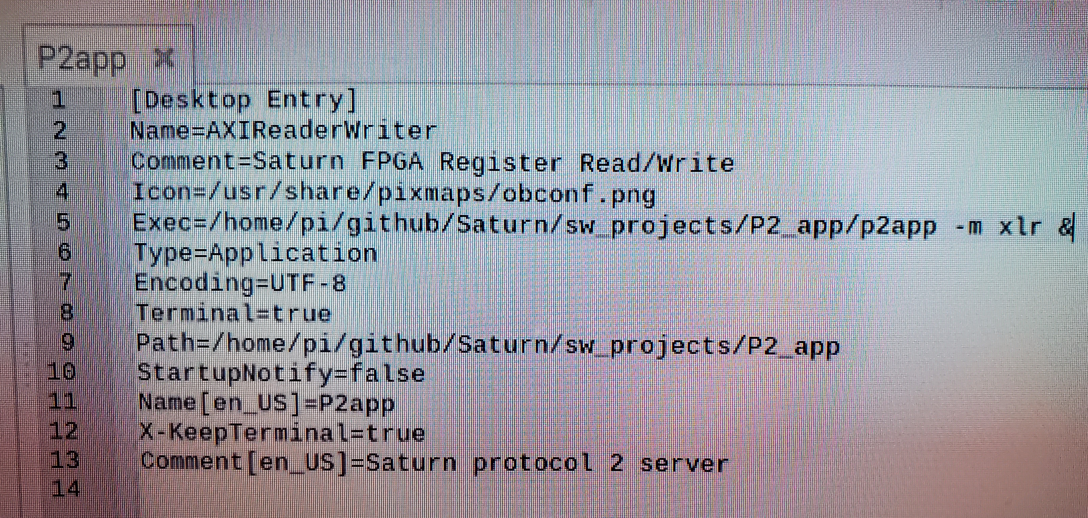

I edited the p2app application icon on the desktop for my G2 no panel as described using the -m xlr & commands and ran the app and it says “XLR Input Selected” so that’s good. But when I connect a dynamic mic to the TRS connector using a standard XLR to TRS cable I get no audio?

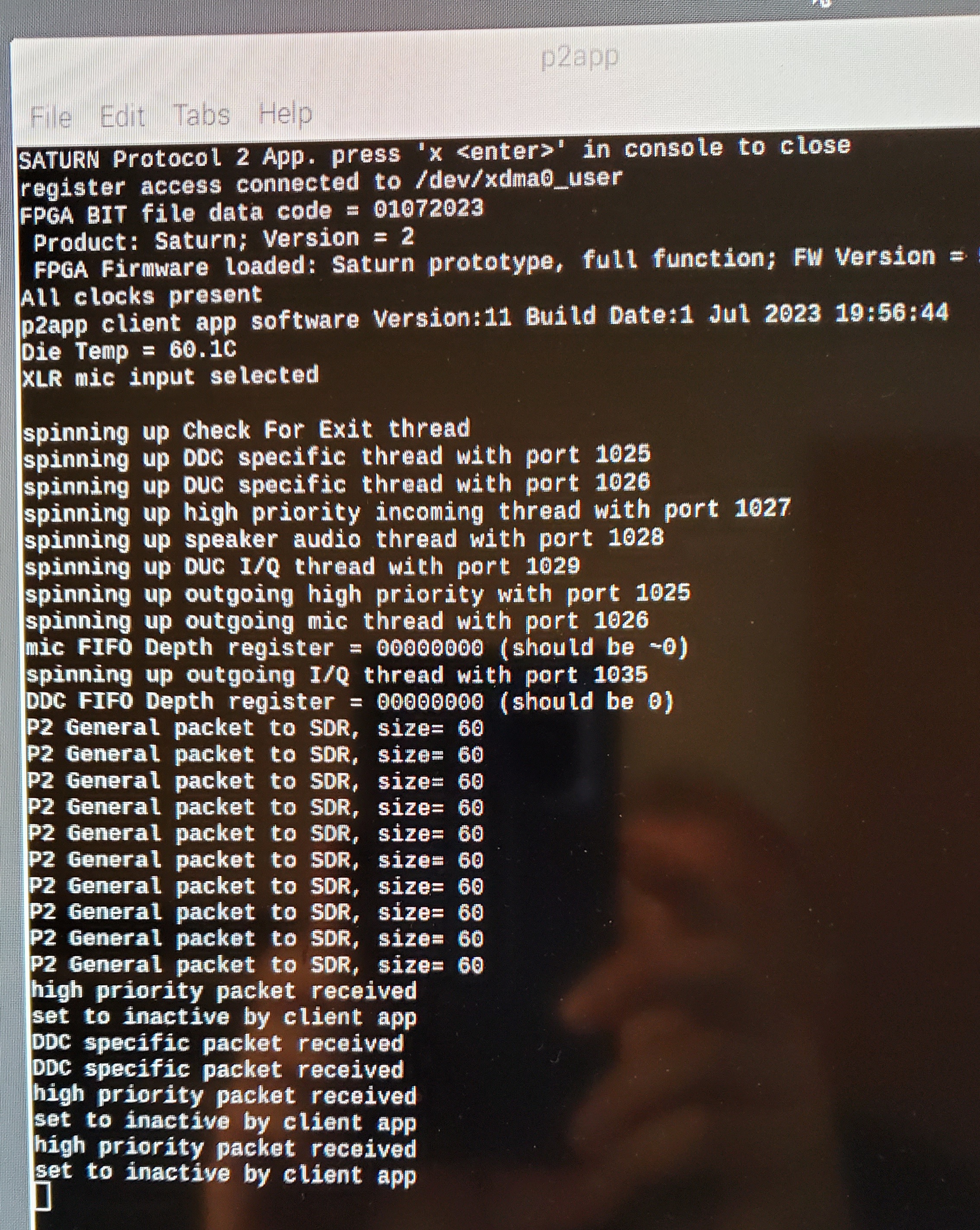

After I added the -m xlr & command I saved and then restart the radio by powering down and up again.
I tried with and without the "&" symbol just to see if there was any diff.
Here are some pics if this helps.
As you can see the p2app is loading with the "XLR" enabled.

That's not the same thing. I suspect you have TWO copies of p2app running - the first of which will not have -m xlr selected. You are editing the commands which leads to you running a second copy of the program, and the screen shots show that you have achieved that. BUT: you also need to terminate the first instance of p2app which ran when the operating system started up. It doesn't have a screen and doesn't show up on a display.
Please read the manual about how to "kill" the one that auto runs at startup. The manual also covers how to edit the settings of the version that auto-runs at power up so you could enable xlr.
(roughly speaking:
terminate the version you have started from the desktop
type ps -ax into a terminal window. This will show you a list of the processes running.
read through the list; I'm guessing you will find another ./p2app. On my computer its process id is around 700 but yours may be different.
note its process id (a numerical value)
type sudo kill <processid value> eg sudo kill 702
now run your desktop icon

-Then right clicked on the desktop icon “p2app” and clicked “Geney” to edit.
-Then I added to the end of the app’s path “-m xlr &” and clicked save.
-Then I double clicked on the “p2app” then clicked Execute.
-Looked at screen and it displays “XLR mic input selected” message in the list.
Is " -m xlr &" a typo?
The command in the manual doesn't include "&" in the line you would use to add the balanced input to p2app so that Thetis will use the balanced input.
