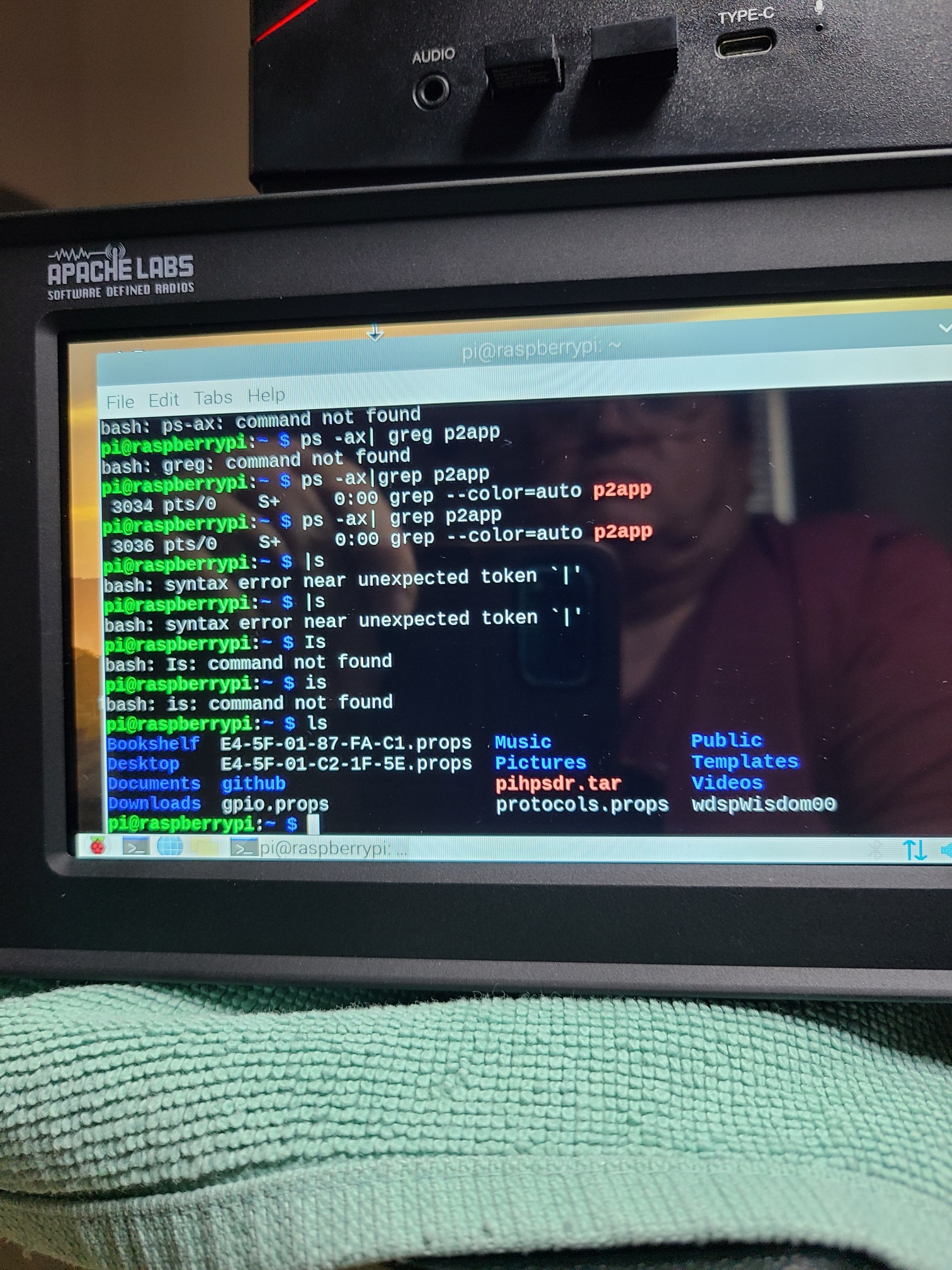

what is the first character before the s on Step 6?
laurencebarker
- Posts: 338
Re: How do i configure my microphone Hardware on my g-2
I agree, it's not very clear.... it is a lower case L. Linux is case sensitive, so it matters. "ls" does a directory listing. What I'm trying to find out is whether you have a folder github
screen shot ls
- L.jpg (1.04 MiB) Viewed 22255 times
laurencebarker
- Posts: 338
OK, the folder is where I thought it would be
type cd github/Saturn/sw_projects/P2_app
type ./p2app
type ./p2app
Laurence Barker G8NJJ

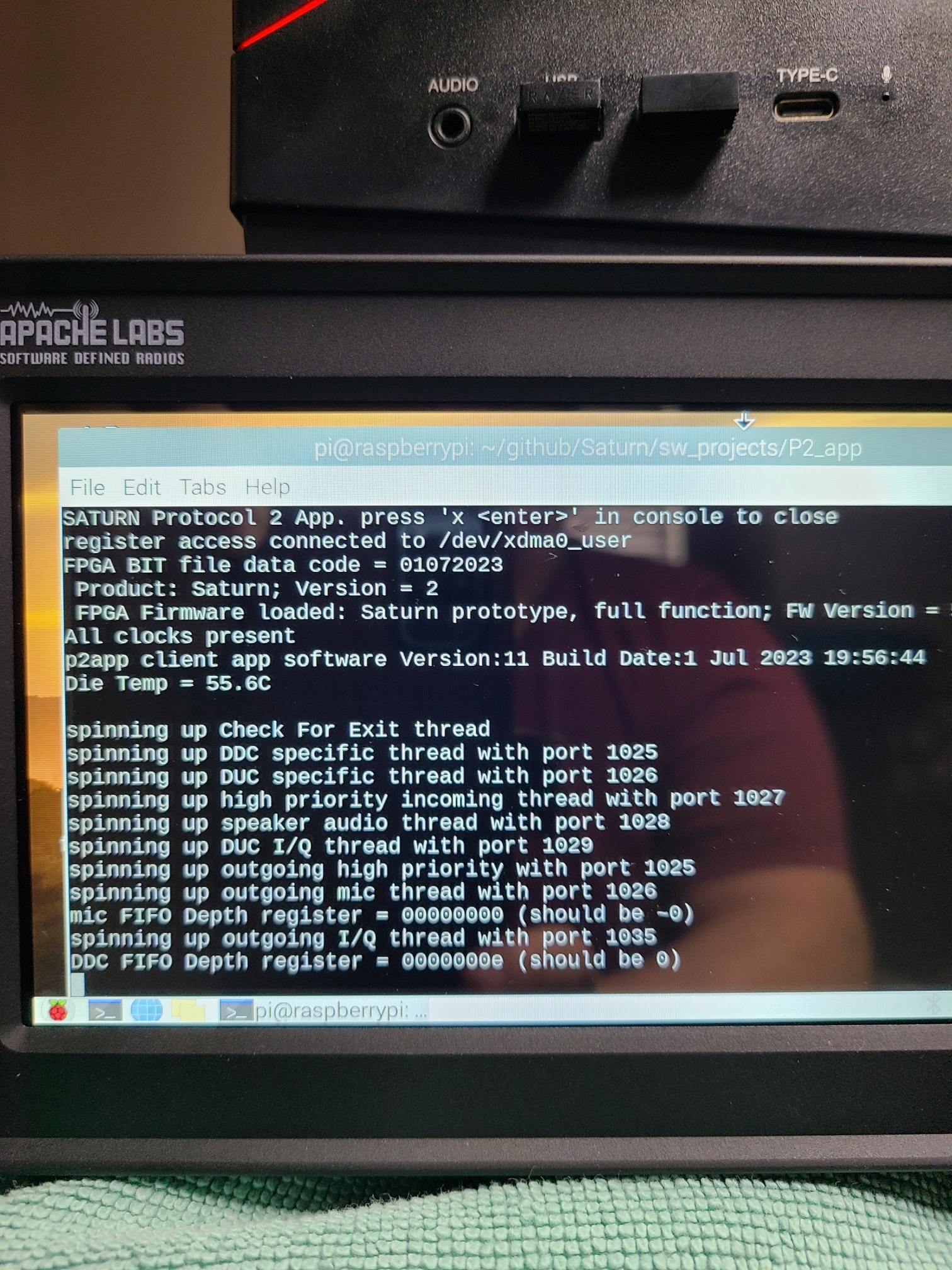

please see attachment, what do i do now , i dont see a cmd bar
- 354.jpg (1.15 MiB) Viewed 22240 times
laurencebarker
- Posts: 338
OK, you now have p2app running.
Try Thetis again
when you want to exit p2app, type exit <enter> (the characters are not echoed back)
I'll send another post in a moment about checking the desktop icons
Try Thetis again

Checking the Saturn desktop icons: I'm guessing this is where the problem lies
Right click on the p2app desktop icon and select Properties
A form with 3 tabs opens up
The 1st tab just gives some information
Click the 2nd tab – Permissions
Owner and group should both say pi
View content: should say Anyone
Change content: should say Only owner
Execute: should say Anyone
Click the 3rd tab – desktop entry
Command should say: /home/pi/github/Saturn/sw_projects/P2_app/p2app
Execute in terminal emulator – ticked
Keep terminal window open after command execution - ticked
Working directory should say: /home/pi/github/Saturn/sw_projects/P2_app
Description – blank
Tooltip: Saturn protocol 2 server
Use startup notification – unticked
Press OK to make any changes
Be aware the path names are case sensitive!
Description – blank

Thetis is running now

You also said you had two desktop icons for p2app - I don't know why!
