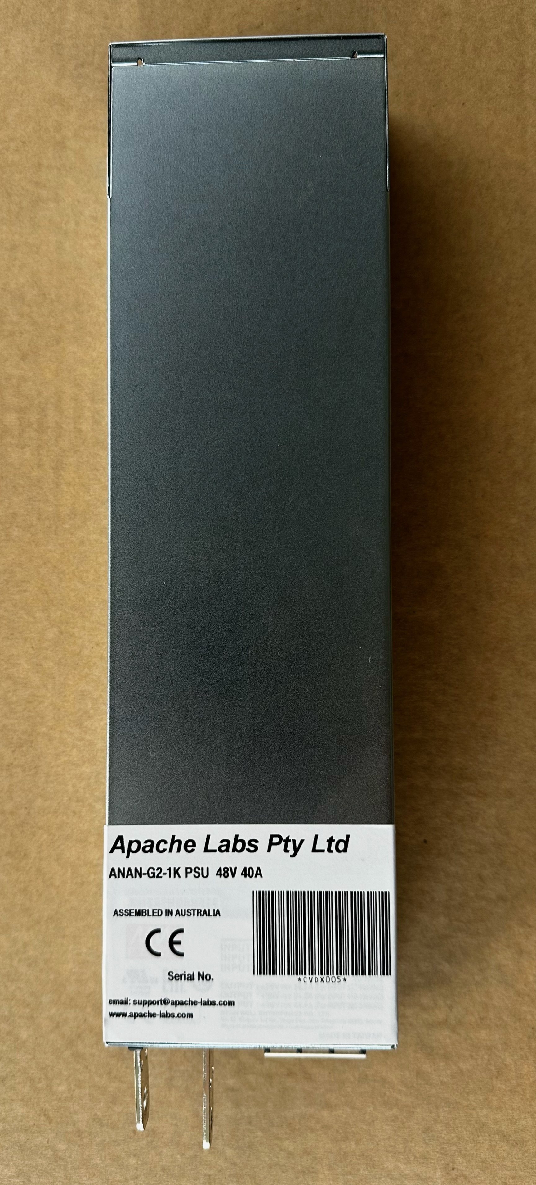

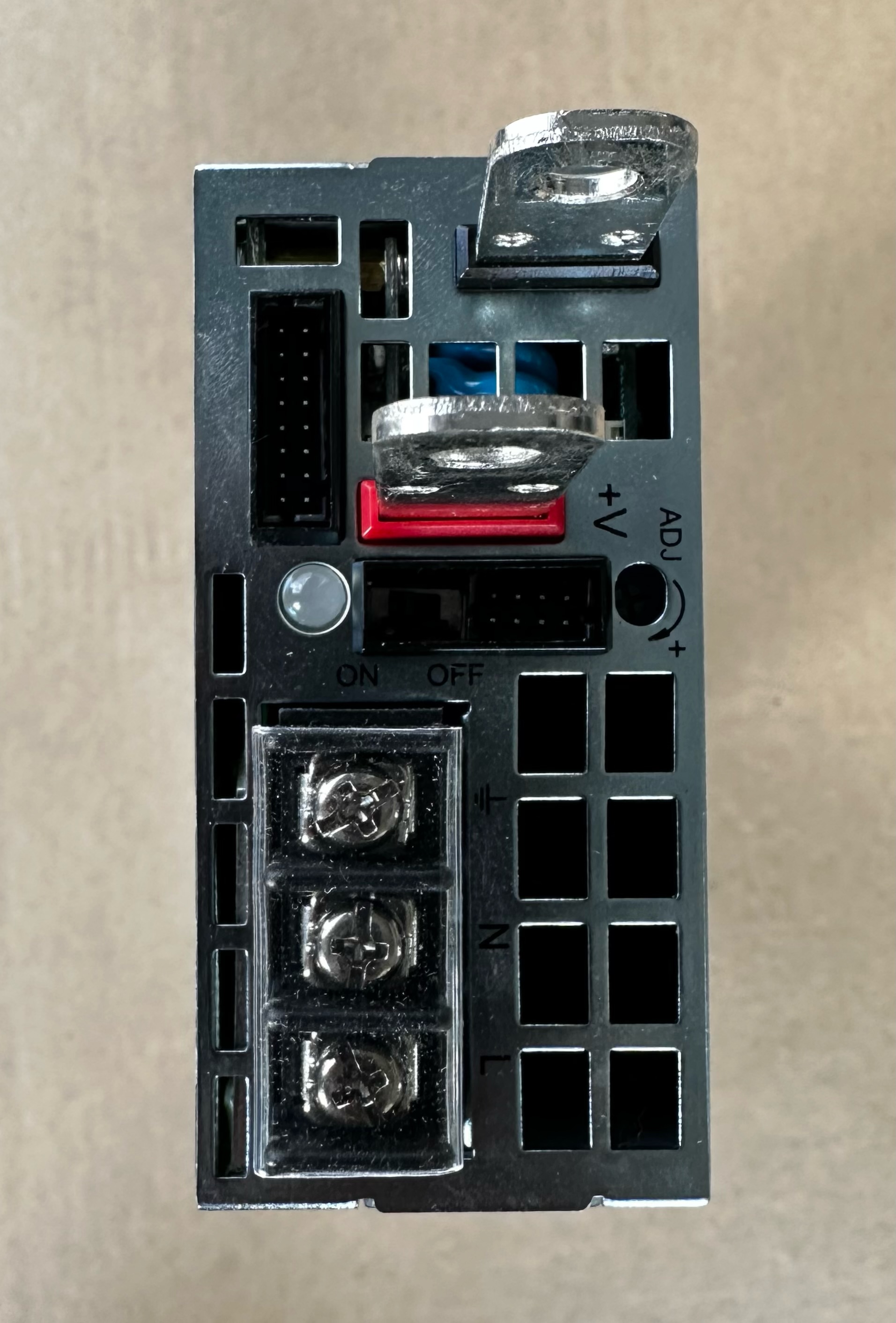

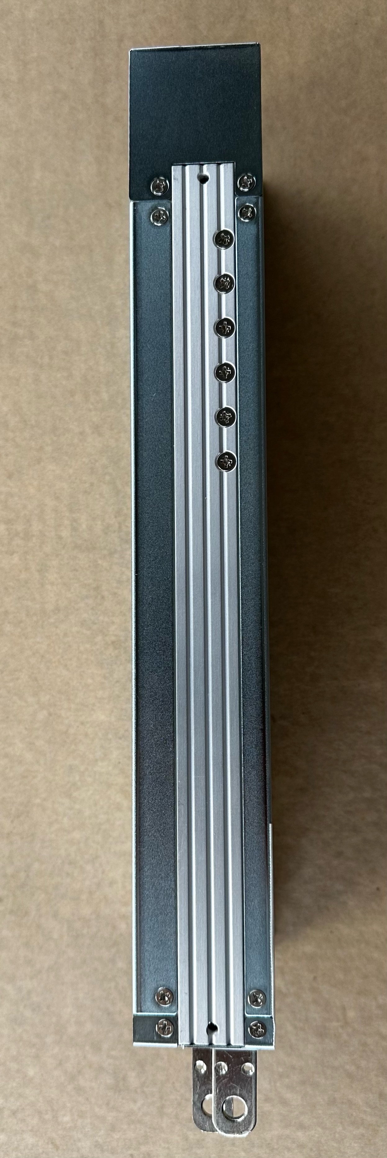

I got some more information.
The dimensions are 30cm L x 8.5cm W x 4 cm H
Fans are temperature controlled.
It's a non-standard Meanwell supply with modifications to make it RF quiet and quieter fans.

Thank you again for your prompt response with photos and dimensions.
Please excuse me if I misunderstood your statement:
"It's a non-standard Meanwell supply with modifications to make it RF quiet and quieter fans."
I am not sure if you meant to imply that "modifications to make it RF quiet and quieter fans" have already been made to the power supply or if the end user needs to make those modification after purchase?
Also; I was contemplation whether it might be useful to purchase two power supplies and run them in parallel so that neither of them are stressed out by running at full capacity when the transceiver was transmitting at 1000 watts output in order to extend the longevity of the supplies. My only trepidation about taking such a course of action would be the difficulty of matching the voltage output of each supply so that they each carry half the load. The reason I say this is due to the fact that I used to work as a telecom technician and had to regularly maintain multiple -48 volt 100 amp paralleled rectifiers. trying to balance them to share equal loads was always a very touchy affair.
Regards: John VE3INH
