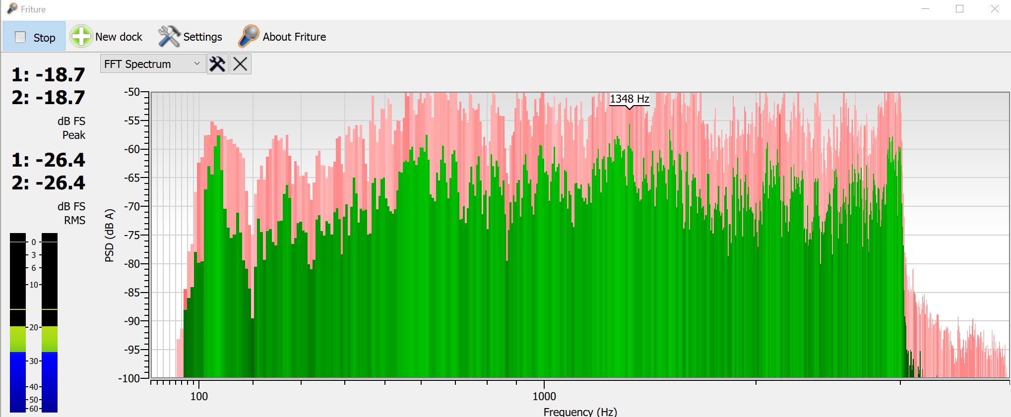

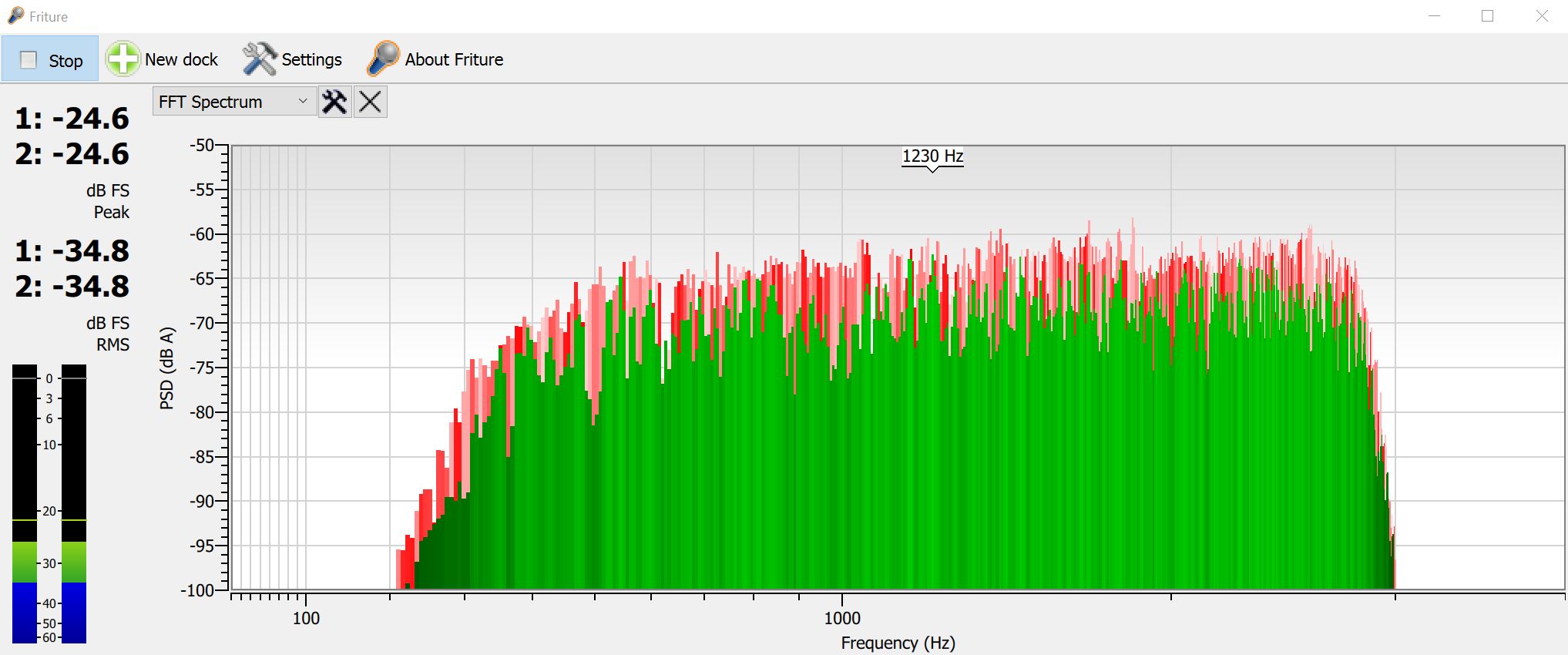

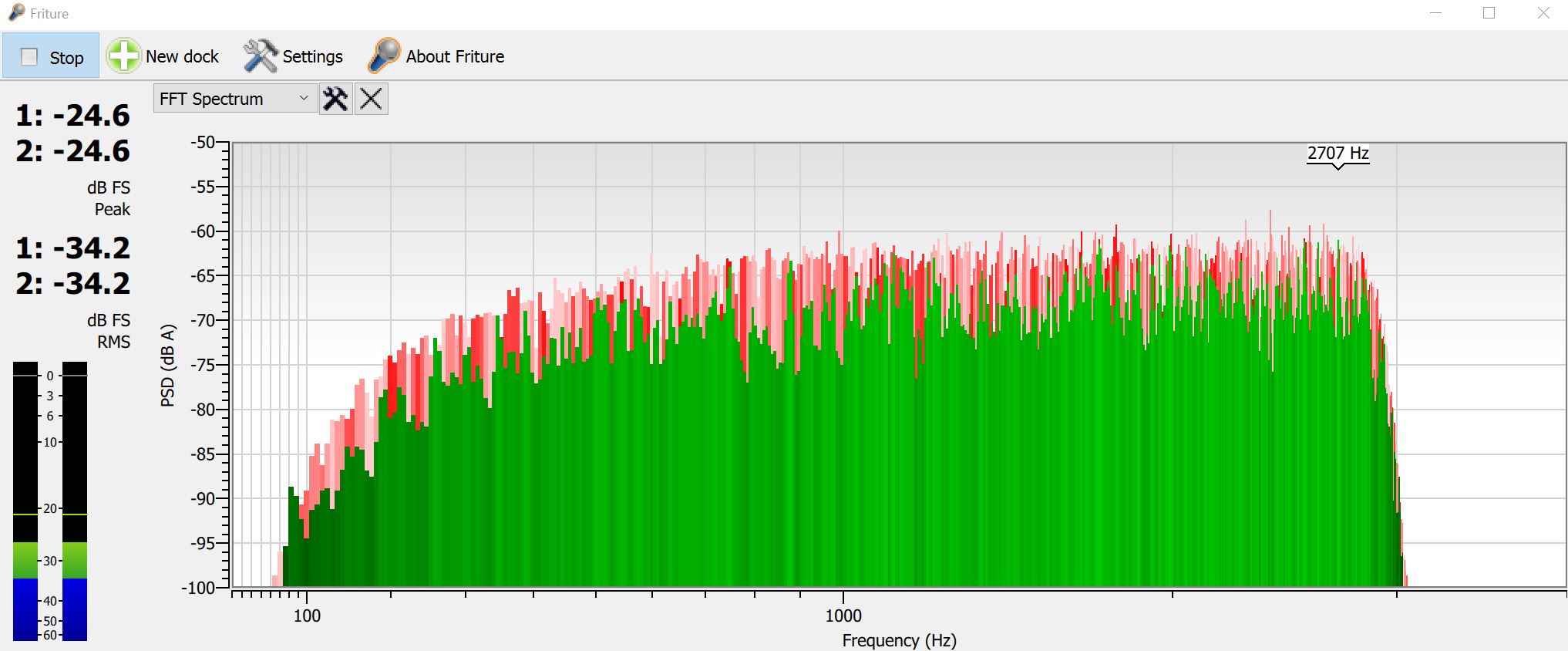

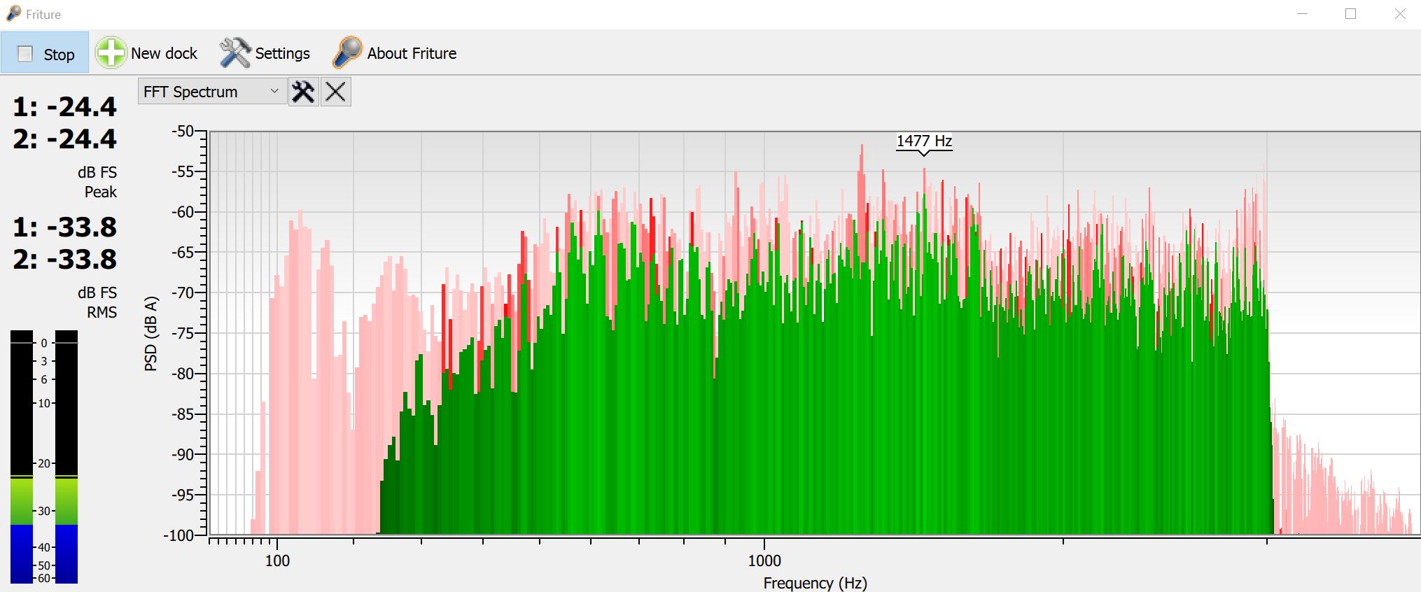

Using the same test conditions that you used, I put the audio output of my 8000 into a spectrum analyzer. Without SNB I get this:
With SNB activated I get this:
No rumbling in either case.
Now compare this to your recording, first without SNB:
And then with SNB activated:
Something is creating those bizarre humps centered at about 140 and 280 Hz. And isn't it interesting that they have that harmonic relationship?

When I have some time this evening I'll grab some screen shots of the noise audio spectrum with and without NR2 so you can see the NR2 "rumble" and observe how it is completely different from your original problem.
