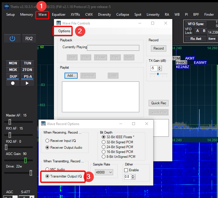

by oe3ide
LarryW wrote:I am getting the same gibberish as W4BF is reporting. I can hear my audio in the background, but garbled.
I am running P2 with the latest u1.
Do you have this set?
Re: Receiver Recording
Posted: Wed Dec 27, 2023 11:16 am
by w4bf
That fixed it ! Thank you.
Posted: Wed Dec 27, 2023 7:35 pm
by LarryW
That also fixed it for me too---Thanks Ernest!

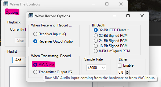

Posted: Thu Dec 28, 2023 5:57 am
by rdwing
NO, This does not fix the issue. This records the I/Q quadrature output, NOT THE TRANSMITTED AUDIO. This is insufficient and incorrect as a representation of the TX AUDIO.
Posted: Sat Dec 30, 2023 6:59 pm
rdwing wrote:NO, This does not fix the issue. This records the I/Q quadrature output, NOT THE TRANSMITTED AUDIO. This is insufficient and incorrect as a representation of the TX AUDIO.
I made some changes and have built a work in progress build. Please try https://github.com/ramdor/Thetis/releas ... 10.3.6-dev
Posted: Sat Dec 30, 2023 7:22 pm
by W4WT
I just tested Richies latest Dev work and it indeed seems to be recording MIC audio now. A good test is to do a quick recording on one band, play it back to verify it, then switch to another band to see if it still plays. It does thus it couldn't be an IQ recording.
Thanks Richie!
Posted: Sun Dec 31, 2023 12:19 am
by rdwing
W4WT wrote:I just tested Richies latest Dev work and it indeed seems to be recording MIC audio now. A good test is to do a quick recording on one band, play it back to verify it, then switch to another band to see if it still plays. It does thus it couldn't be an IQ recording.
Thanks Richie!
You could actually play back the I/Q recording anywhere previously, I suspect you still can. But, mic audio recording is indeed working. Thanks so much.
