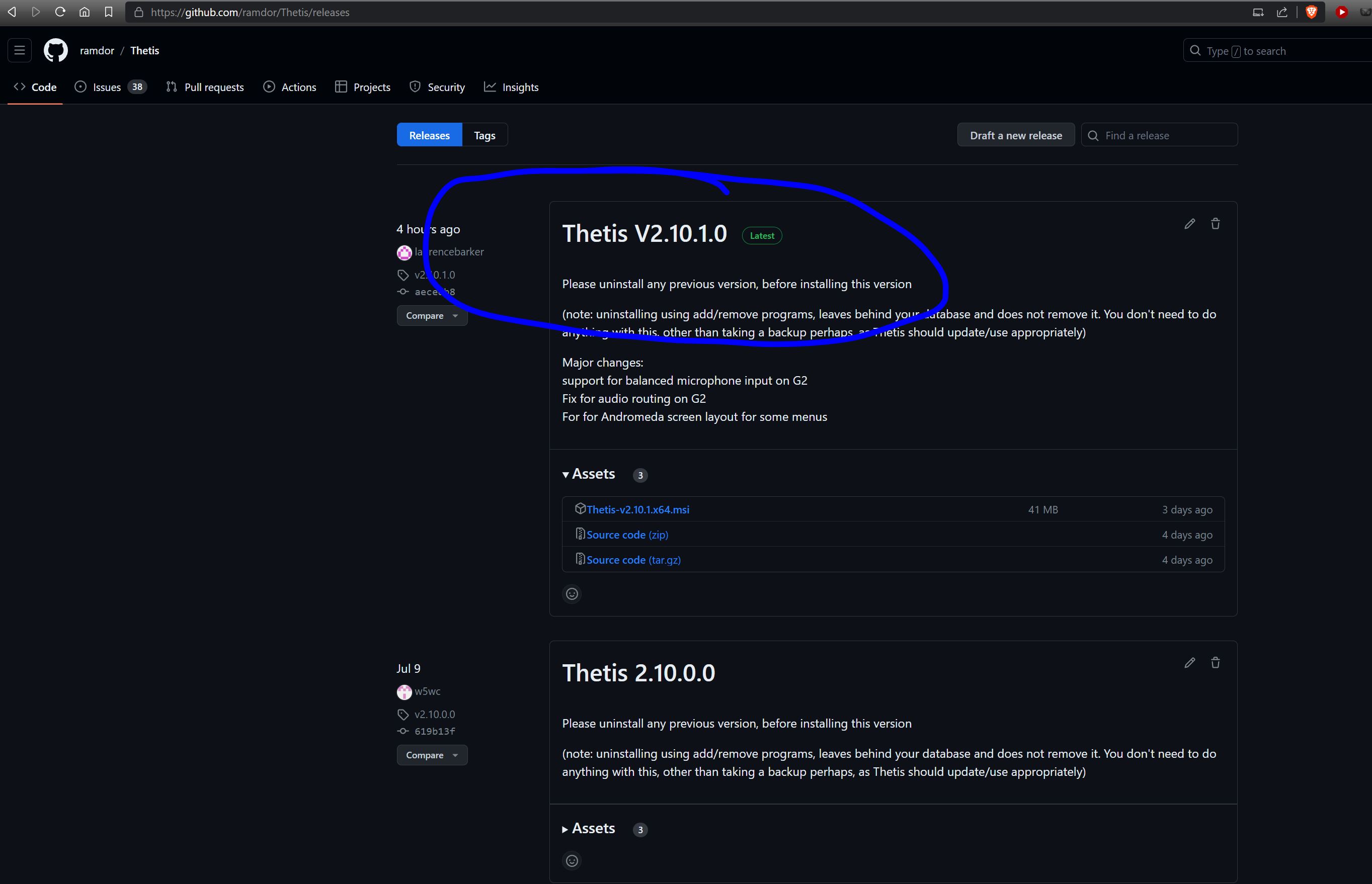

I must be missing something as I only see 2.10.0.0 from July.
Re: Thetis 2.10.1 Released
Posted: Sun Aug 27, 2023 2:38 pm
by ea3aqr
Posted: Sun Aug 27, 2023 2:47 pm
Mike_N1JEZ wrote:I must be missing something as I only see 2.10.0.0 from July.
Your browser must be loading a cached page, because it's right there at the link provided in the first post.

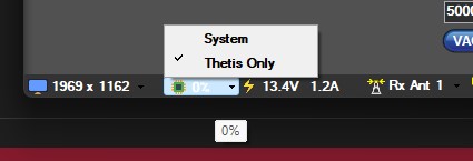

Not sure why, but with all Thetis 2.10.0 to 2.10.2 (Final release) I see higher overall CPU load. Normal load was 2/3%. With 2.10.2 etc, CPU load is now 15% plus. Same results on two other PC's.
Re: Thetis 2.10.2 Final Now Available
Posted: Thu Oct 12, 2023 5:19 am
by Trucker
Previous versions had N issue showing the correct cpu usage. I had to look in Windows Task Manager to see actual usage. That has now been corrected..

Posted: Thu Oct 12, 2023 6:19 am
vk1hx wrote:Not sure why, but with all Thetis 2.10.0 to 2.10.2 (Final release) I see higher overall CPU load. Normal load was 2/3%. With 2.10.2 etc, CPU load is now 15% plus. Same results on two other PC's.
Posted: Thu Oct 12, 2023 6:30 am
by vk1hx
It’s the same no matter which. Thetis is using 13-15%. Default database.
Posted: Thu Oct 12, 2023 6:36 am
by vk1hx
Trucker wrote:Previous versions had N issue showing the correct cpu usage. I had to look in Windows Task Manager to see actual usage. That has now been corrected..
I’ve run task manager and my system uses 0 to 1% cpu. When I run Thetis it jumps to 15% in task manager and is quite erratic. Sometimes hitting 18%.
Im running an i9, 9900k cpu, 16cores, 32gb ram, nvme M.2 hard drives, dedicated graphics. Anyway not seeing this high usage with other versions of Thetis. Back to the old one.
Posted: Thu Oct 12, 2023 9:05 am
by oe3ide
Can not see a difference to older versions. Still between 3-4% (Thetis only).
73 Ernst, OE3IDE

Posted: Thu Oct 12, 2023 9:20 am
Running a severely undervolted and under-clocked i9 laptop here, Thetis is reporting between 1-3% System load.
Check your Task Manager to see if there's something else going on.

K1LSB wrote:Running a severely undervolted and under-clocked i9 laptop here, Thetis is reporting between 1-3% System load.
Thanks Mark.
Yes I've checked it. Check what I said in a previous post. Main system is 0-1%
Posted: Thu Oct 12, 2023 11:28 am
by PD3LK
Many thanks for the update Ramdor!
No issues and only 1% cpu load (Thetis only) (i7 gen12)
Posted: Thu Oct 12, 2023 3:32 pm
by ea3aqr
Thetis, since Windows 11, doesn't show correct CPU utilization.
Please check real CPU utilization in taskbar/processes/Thetis

Speaking of the CPU usage, I think the difference being seen between the percentage shown by Thetis and Task Manager is related to how often Thetis updates cpu data it displays from where it is actually getting the data. I believe there is a delay between the two and that's why they don't often read the exact same thing at the same time.
For me, it really isn't a big deal. My older i7 6700 Dell seems to do just fine. And usage shows around 15 to 18 percent most of the time. I can run other applications without any noticeable impact on Thetis or whatever other application I might be using at the same time.
