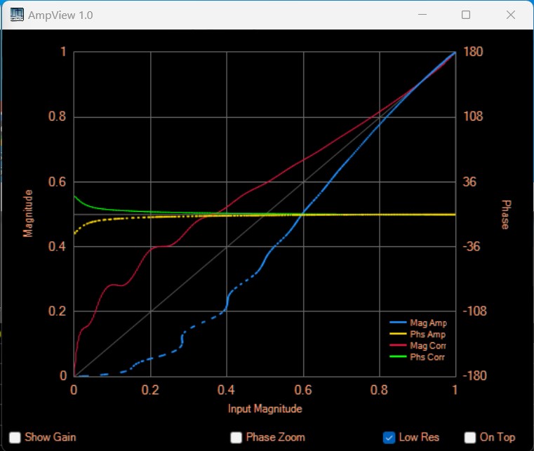

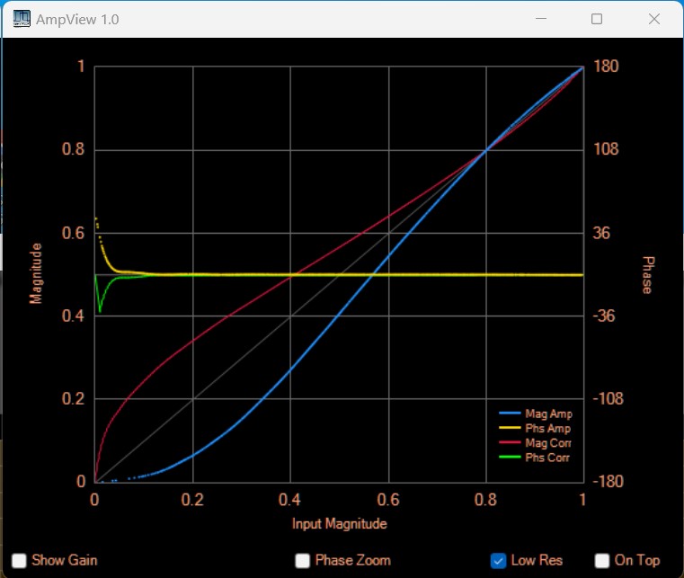

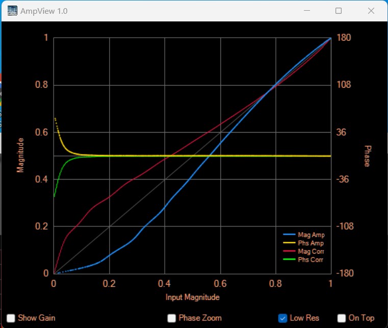

My early model 7000DLE MKII has a problem with PureSignal behavior on several bands, but it's so severe on 20 meters that it's totally unusable.
Here's a snapshot of the PS curves on 20 meters, captured with the internal sampler at 41 watts drive. The resulting TX audio is quite nasty!
20 meters 41 watts.jpg (61.44 KiB) Viewed 31493 times
It's my understanding that the design intent of PS is to apply an exact mirror image correction curve of the measured nonlinearity in the PA output, which is not at all what I'm seeing in the screenshot...the red "Correction" curve is oscillating wildly and is nowhere near a mirror image of the blue Measured curve coming from the PA.
Can someone with specific knowledge of how PS is supposed to work please help me understand what the problem is? In its current state, the problem with PS on 20 meters renders that entire band completely unusable on my radio.
Truth be told, I suspect there is such severe non-linearity in my PA that the PS algorithm is simply failing in its effort to correct for it.
For reference, here's a Drive folder of PS screenshots taken on every band at several different drive levels. As you can see, there is no drive level at all on 20 meters where PS functions as it should. All screenshots were taken with the internal sampler while the radio was at room temperature (cool to the touch).
https://drive.google.com/drive/folders/ ... sp=sharing
Also for comparison, I've included in that folder a snapshot of Juha NI2M's PS curves (I spent a weekend with his 7000DLE MKII running at my QTH). Man, I wish my radio was that clean!
Thanks in advance,

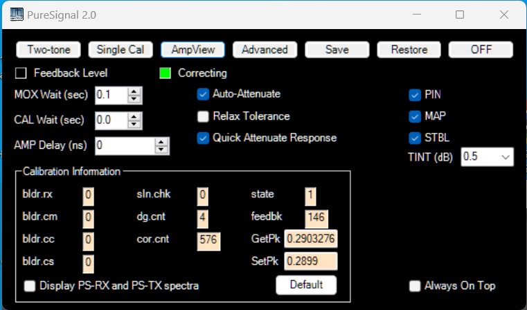

Please post a screen shot of your Linearity > Advanced window.
What S-ATT value are you getting with 41W on 20M?
Re: Severe problem with PureSignal
Posted: Tue Aug 29, 2023 5:33 pm
w-u-2-o wrote:Please post a screen shot of your Linearity > Advanced window.
Here's my PS settings, I've tried the full gamut of settings over the years but this is what works best for me:
PureSignal Settings.jpg (66.46 KiB) Viewed 31462 times
I'm at work so I can't see the S-ATT value but I'm sure it's what would be expected from the internal sampler at 41 watts drive.
Regardless, all of those PS curves look very nearly the same irrespective of whether I'm running barefoot with the internal sampler or from the external sampler behind my AL-80B while running 600-ish watts.
Posted: Tue Aug 29, 2023 5:50 pm
I'd recommend turning off MAP and making your amp delay at least 150nS, but those are nits. Other than that all those numbers look good.

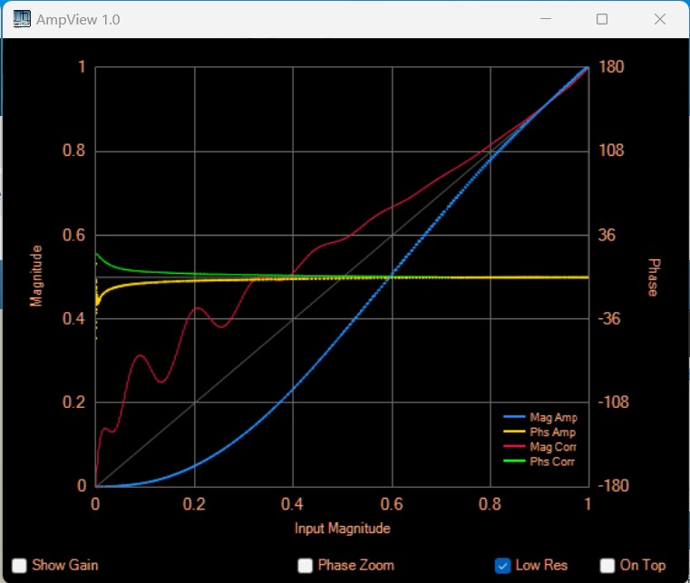

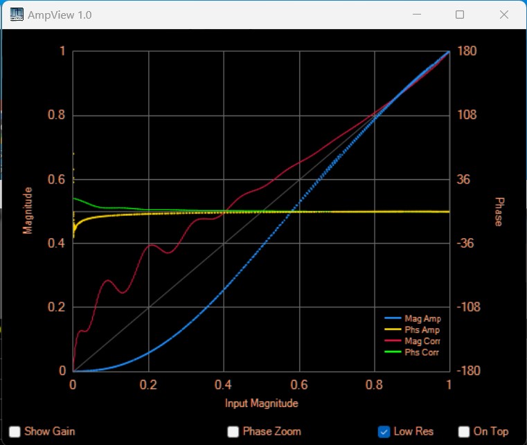

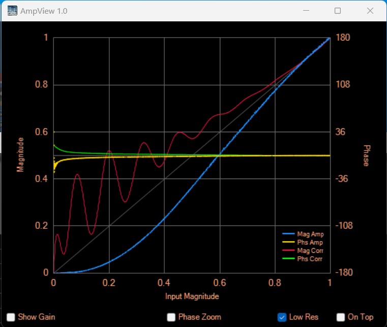

Also, look at 12 meters running 85 and 90 watts. Those curves strongly suggest a PA issue somewhere:

1. The plots you show on 12 meters, when the blue line starts to go horizontal at the top right corner that indicates that the internal amp is badly overdriven and well into saturation. That's obviously bad. Have you calibrated the internal watt meter? Do you have an external watt meter you can use to double check that?
2. I'm assuming you are using two-tone to make these plots?
3. What sort of external coupler do you have? What is it's coupling factor? I'd suggest trying it barefoot in lieu of the internal coupler to see if a problem with the internal coupler can be ruled out. Don't forget to activate the Bypass on TX option.

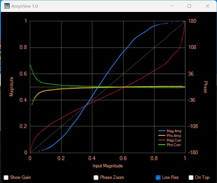

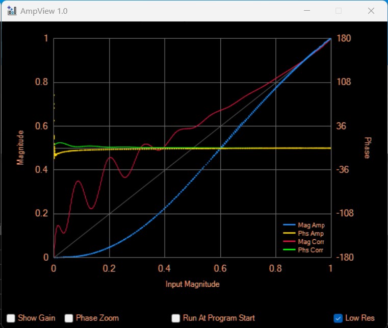

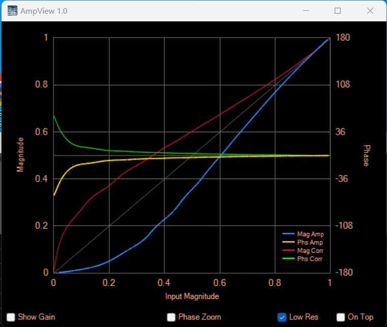

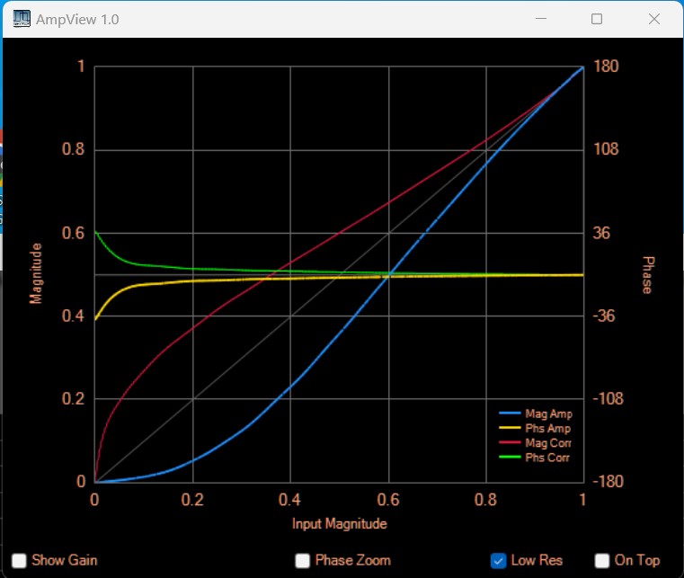

Here are comparative snapshots of different bands sampled through the internal and external samplers, all captured this evening at 41 watts, with S-ATT readings embedded in the titles:

1. There is no way you should be seeing the internal amp overdriven into saturation like that at 100W. Therefore either your internal watt meter calibration is off (with all due respect to Mike's fine lab), or your ANAN is broken somehow. Has it always worked like this, or has something changed, and when did it change?
2. Because both the internal and external sampler are giving nearly identical results, it doesn't seem like it can be a cable problem or a problem with either the internal or external feedback path.

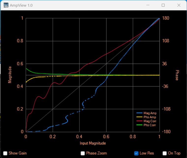

Here are a bunch of two-tone tests on the internal sampler. This first batch is 20 meters on Protocol 1:

So on 20 meters there does appear to be some slight differences between P1 and early P2 and the latest P2 in the range of 33 watts drive, but notwithstanding that I'm not seeing enough difference to make an argument that firmware is the problem in any case. 20 meters is broken at any power level, on any firmware.
Posted: Thu Aug 31, 2023 1:12 am
Mark--your work has ruled out a difference between internal and external couplers, and between P1 and P2.
The next most likely cause is some aberrant RF or RFI condition that is causing bad data. Although you are running into a dummy load such a possibility cannot be discounted. Warren saw your post and sent me a note suggesting the same thing.

Here are some shots of 20 meters at 25 and 41 watts into the Cantenna, the internal 300W dummy load in my 989D tuner and a tuned wire dipole. Some are low-res and some are hi-res.
A fresh 4-foot LMR-240 cable was installed going to the Cantenna. A 12-inch LMR-240 cable runs from the 7000 to the AL-80B, a 3-foot LMR-400 cable runs from the AL-80B to the tuner, and 75 feet of LMR-400 runs from the tuner to the wire dipole.
Some of the shots look somewhat different than yesterday, no idea why, maybe because it's cooler in the shack this morning or maybe because the mains voltage is 125.2 this morning and was 118.7 yesterday.
Edit: I was confused, a 12-inch length of LMR-400 runs from the 7000 to the AL-80B (an 18-inch RG-400 is feedback from the external sampler).
20M 25W HR 989D Dummy.jpg (66.02 KiB) Viewed 31197 times
20M 25W HR Cantenna.jpg (65.65 KiB) Viewed 31197 times
20M 25W HR Dipole.jpg (64.43 KiB) Viewed 31197 times
20M 41W HR 989D Dummy.jpg (62.05 KiB) Viewed 31197 times
20M 41W HR Cantenna.jpg (62.07 KiB) Viewed 31197 times
20M 41W HR Dipole.jpg (61.43 KiB) Viewed 31197 times
20M 41W LR 989D Dummy.jpg (61.85 KiB) Viewed 31197 times
20M 41W LR Cantenna.jpg (62.13 KiB) Viewed 31197 times

by w4bf
Look at linearity with PS off using spectrum display.
This is 100 watts - 3rd order IMD on my 7000 about -30 dB from each tone.
With PS ON, it drops to -52 dB.
Sounds like his internal HW has issues since he gets same results with amplifier.

Looking at my latest screenshots, I see no differences between the Cantenna and the 989D dummy load and the wire dipole, nor between the lo-res and hi-res graphs.
So I think we can eliminate all of the above (loads and graph resolution) as issues.
Posted: Thu Aug 31, 2023 12:58 pm
Agreed. So now it's grasping at straws time. I'd drop that rear panel and check all the RF connections you can reach to make sure they are secure.
