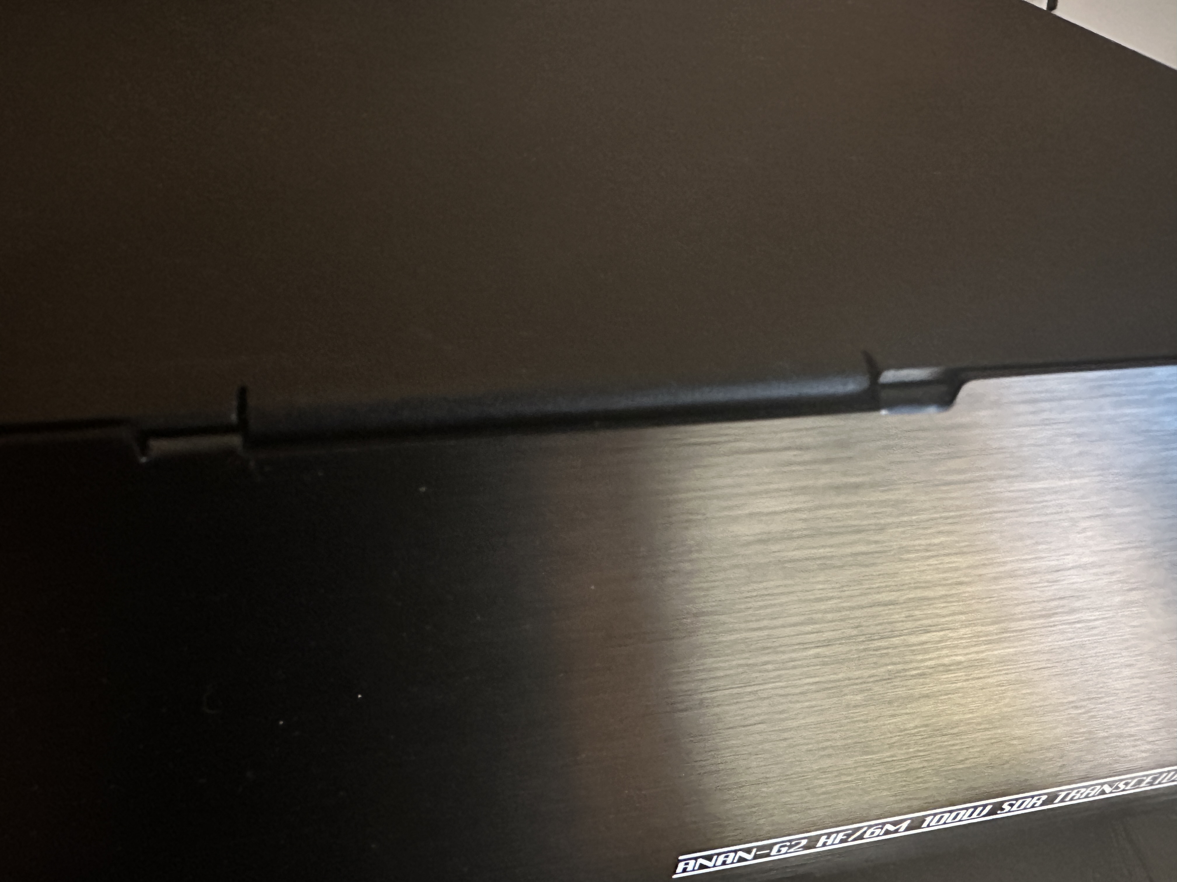

There is no high resolution image of the G2 on the Apache-Labs website. The front plate has a cutout on its upper edge. Is there a housing latch and an LED there? I'm waiting for the G2 to be delivered and I'm curious what's installed there.
Slawomir

by KI4P
qst wrote:There is no high resolution image of the G2 on the Apache-Labs website. The front plate has a cutout on its upper edge. Is there a housing latch and an LED there? I'm waiting for the G2 to be delivered and I'm curious what's installed there.
Slawomir
the cutout you see is there for a tab on the top to fit in, see attached
Richard
