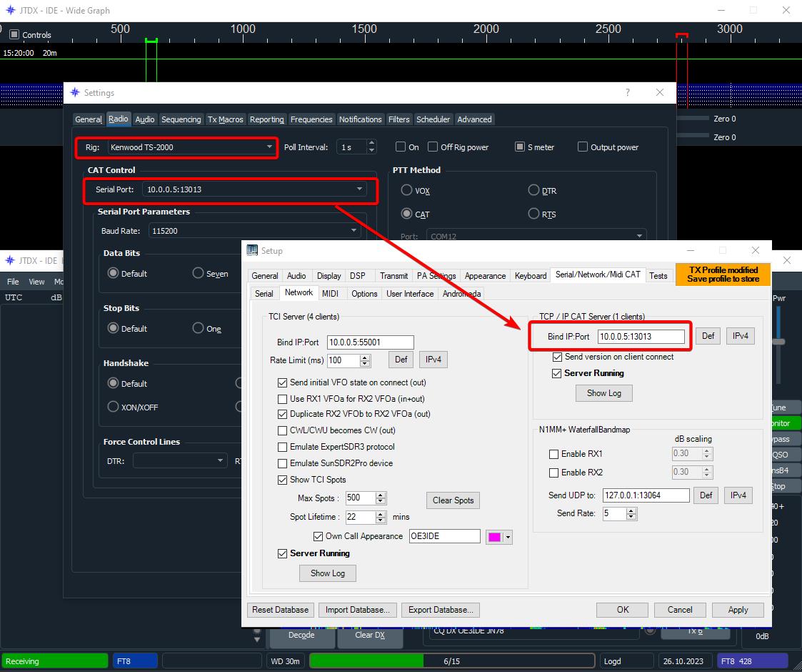

If TCI does not work for you, you can use TCPIP-Cat (only in JTDX afaik)

Thanks Ernst, I'll try TCP/IP-Cat and see how that goes

oe3ide wrote:If TCI does not work for you, you can use TCPIP-Cat (only in JTDX afaik)
It works in a lot of app's. It will work in anything that uses HamLib, such as Fldigi and WSJT-X. It also works in DX Labs, N1MM and other software.
See: viewtopic.php?f=22&t=4249&p=25803

Thanks Scott FYI JTDX has a rig listing for FlexRadio/Anan PowerSDR/Thetis . I will test with that rig listing

so far so good using TCP/IP-Cat
