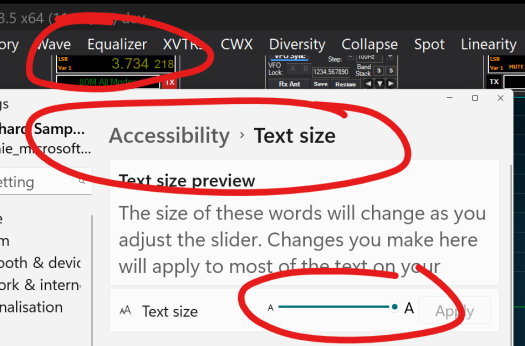

I noticed just now that VFOA and VFOB windows aren't showing correctly. Not sure why I see this only now (it has been there all along), but I wonder what causes this? See image below.

JJ4SDR wrote:I noticed just now that VFOA and VFOB windows aren't showing correctly. Not sure why I see this only now (it has been there all along), but I wonder what causes this? See image below.
No problems here.
I guess this Windows setting is involved:
Start > Settings > Accessibility. Select Text size

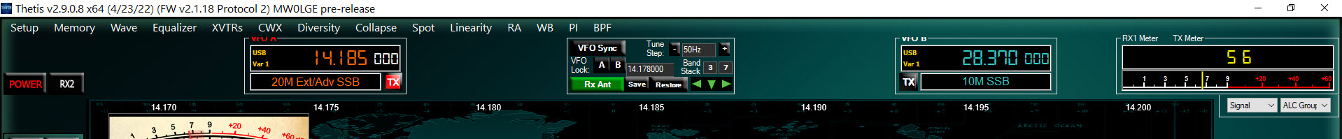

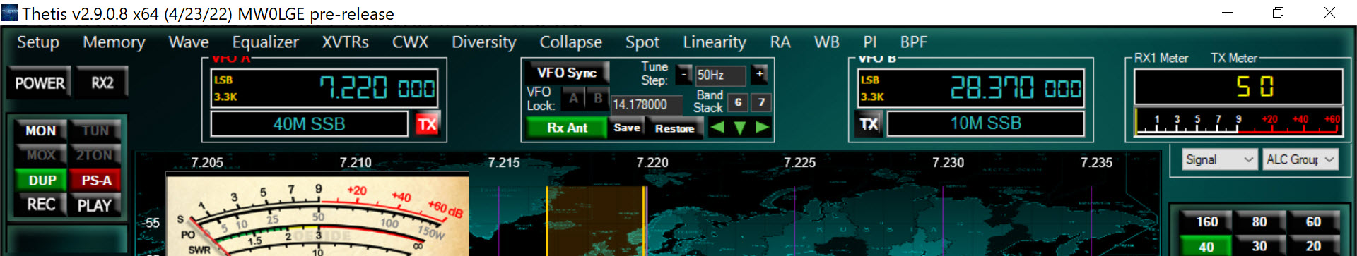

Well here is mine if it is any help.
Terry. GW4NNO

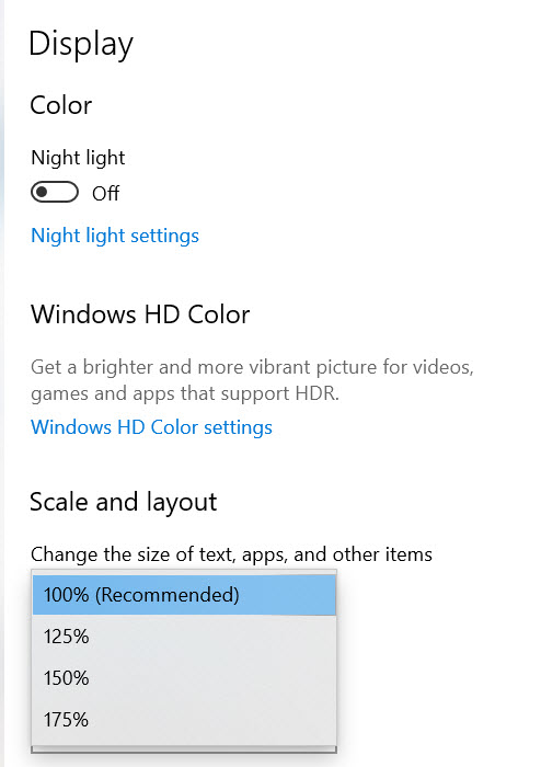

I guess Windows 10 doesn't have such a slider.....
Display scaling.jpg (47.39 KiB) Viewed 33886 times
Re: VFOA and VFOB windows not showing correctly
Posted: Tue Nov 28, 2023 1:20 am
In that image you are probably changing display scaling, not just the text size.
In windows 10, go to start button, select settings, ease of access, display. Use slider Make text bigger. There is another slider that 'Makes everything bigger', ignore that one.
https://youtu.be/01pzenMJiQw
