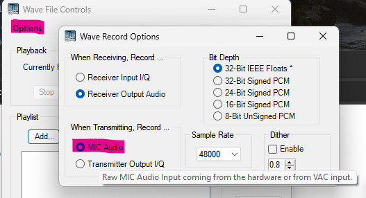

I made some changes and have built a work in progress build. Please try https://github.com/ramdor/Thetis/releas ... 10.3.6-dev
Re: Transmit Record ability lost
Posted: Sat Dec 30, 2023 7:16 pm
by dynamicfusion
How cool is that! MIC Audio pertaining and including VAC audio IN ya? Will test later tonight when back in shack.
Posted: Sat Dec 30, 2023 8:13 pm
by Joerg
You can now record your own audio signal, with and without EQ or CFC.
If you record audio with MIC, you hear your audio without EQ or CFC and with Transmitter Output I/Q you hear yourself as others hear you.
So press PTT, start REC, stop REC and then press PTT and Play to play.
The audio assessment is better than via monitor.

Most awesome! Running the 2.10.3.6 "dev" version just posted by Richie.
No change selecting either recording to MIC Audio or to Transmitter Output IQ.
Press MOX (or VOX) and then press REC button.
Playback by pressing MOX and Play buttons. Perfect monitor playback using studio monitor speakers.
Turn off transmit equalizer and/or CFC. The playback audio accurately portrays the transmitted audio with these modifications. Great way to evaluate the effect any of these adjustments on the transmitted audio.!!!
Thanks! I've wanted to be able to do this since first using Thetis 12 months ago. What a great tool to discover those "perfect" equalizer and CFC settings!

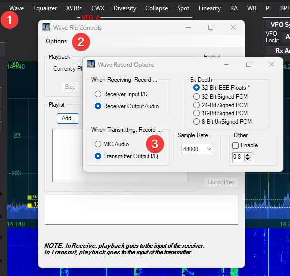

Cant seem to find the record options control ? What tab is it located on please ?
Posted: Sun Dec 31, 2023 3:51 pm
by oe3ide
Tony EI7BMB wrote:Cant seem to find the record options control ? What tab is it located on please ?
Posted: Mon Jan 01, 2024 1:55 pm
by Tony EI7BMB
Thanks Ernst
