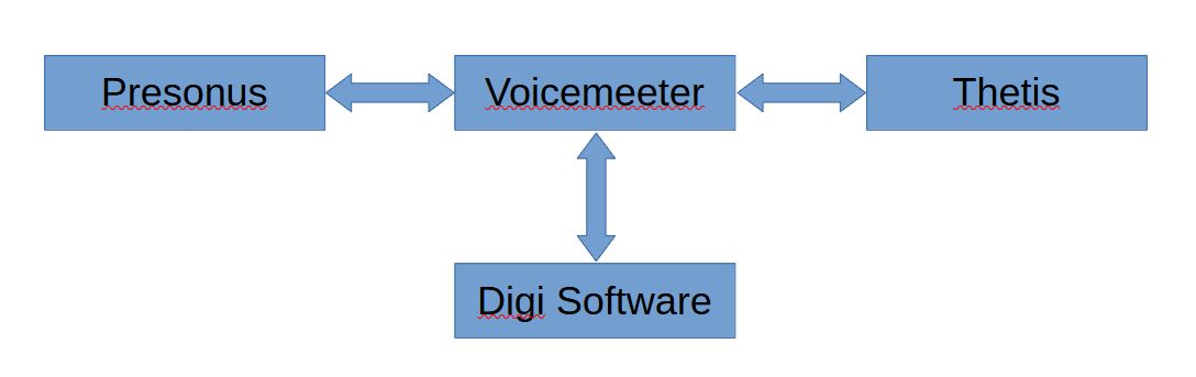

Re: Full VAC or Hybrid audio
Posted: Sun Mar 17, 2024 4:58 pm
Maybe I didn't explain good enough :D
This is how I use Voicemeeter:
That way I can turn decide what audio goes in and out of Thetis and where it goes. This is particularly helpful on receive when you may wish for the audio to go to both the digi mode software (perhaps more than one digi mode app) and also the speakers (plugged into the Presonus) at the same time and at different levels.
Posted: Sun Mar 17, 2024 5:35 pm
by CT2IRY
Got you Scott.
Thanks for the picture, like they say, one picture is worth 1000 words. :D
