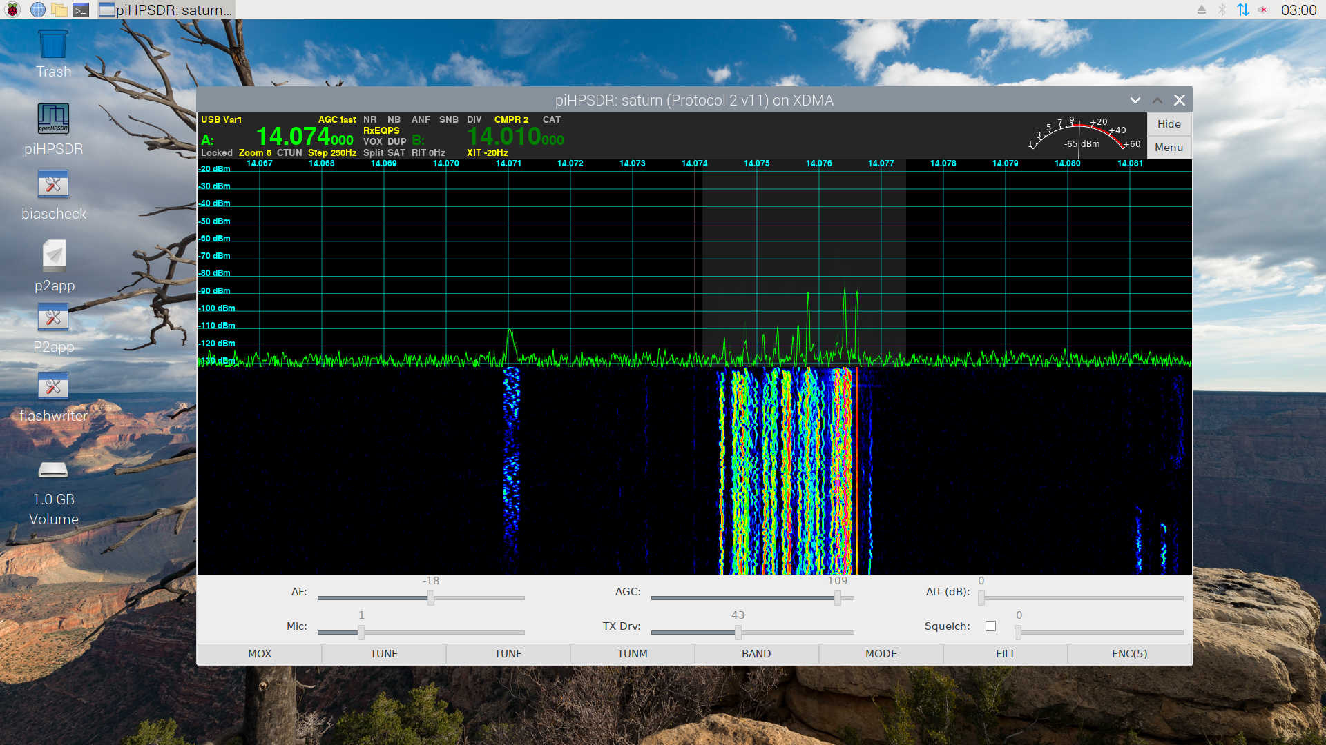

Why does the waterfall looks so much better when using pihpsdr, (it is much more colorful)? I would think that one would be able to have the same beautiful colors as in pihpsdr, when using Thetis. Currently have selected 'Enchanced' for Palette.

Yes, I have tried to customize it, but can not get it to look as good as pihpsdr in waterfall AUTO mode! Have you tried it?

John, just out of curiosity, could you post a screenshot of the waterfall in PiHPSDR that you are seeing? I will hook up my controller later and see if the version of PiHPSDR has a setting like you are seeing.

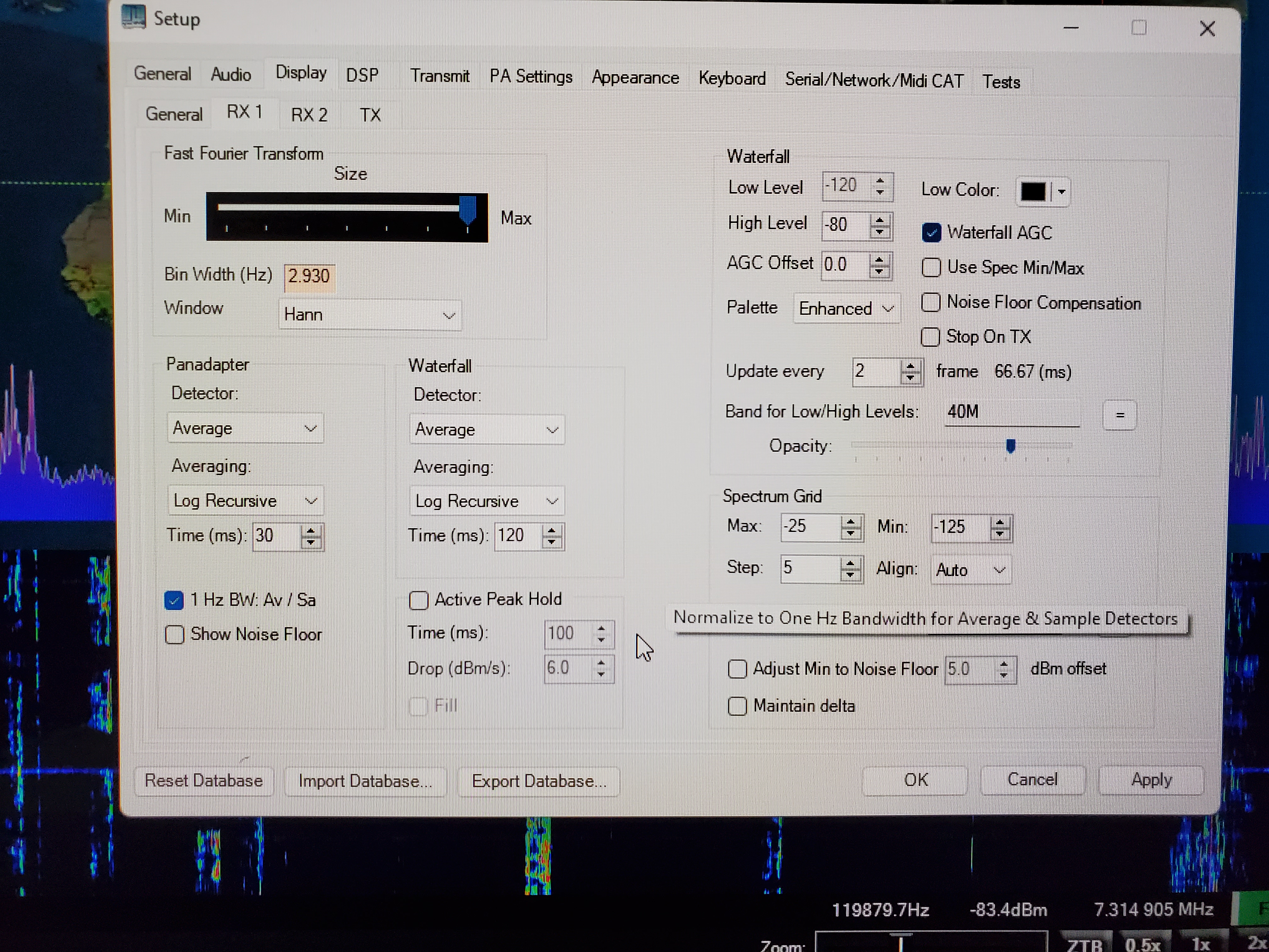

John, is this the waterfall display you are looking for?
Re: Waterfall Spectrum Colors
Posted: Thu May 02, 2024 3:20 am
by Trucker
If so, here is where you set it up in Thetis.

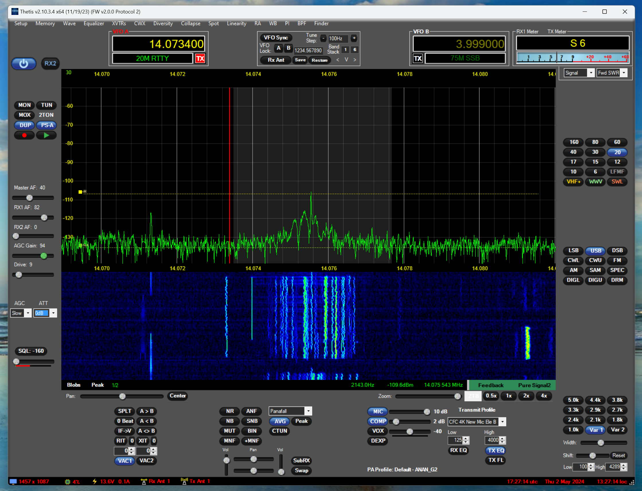

OK, below I will attach a screenshot of the waterfall using pihpsdr, and also the waterfall using Thetis. One can clearly see that the pihpsdr is more beautiful! It seems like the 'ECHANCED' mode in Thetis needs to be more ENHANCED!

Looks good John! Everyone has different tastes in how they operate and how information is presented to them. That's what makes using a radio like the G2 Saturn ( with or without, the front panel) a nice experience.
You can get basically the same look in Thetis with some careful adjustment of the different display settings available. The Collapsed view using the Andromeda controls display along with the waterfall settings can be quite nice. Either way, it can be a fun exercise tweaking things to get the look and feel one wants.

OK, it is much better now, I had the Waterfall Detector set to PEAK, not AVERAGE! Thank you for the screenshot!
