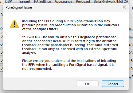

Reason for bypassing BPF for PS transmit: We run a high feedback level to use basically the full dynamic range of the ADC. This high signal level can produce passive Inter-Modulation Distortion in the inductors of the bandpass filters. This distorted feedback then degrades PS performance. This is more pronounced in some radios than others. Note that you will NOT be able to observe the degraded performance on the panadapter because PS is correcting to the distorted feedback and the panadapter is "seeing" that same distorted feedback. It can only be observed with an external spectrum analyzer.
Warren NR0V

the following will be shown if the bypass system for PS is disabled. The message added in next release. Default is to have the bpfs bypassed with PS.

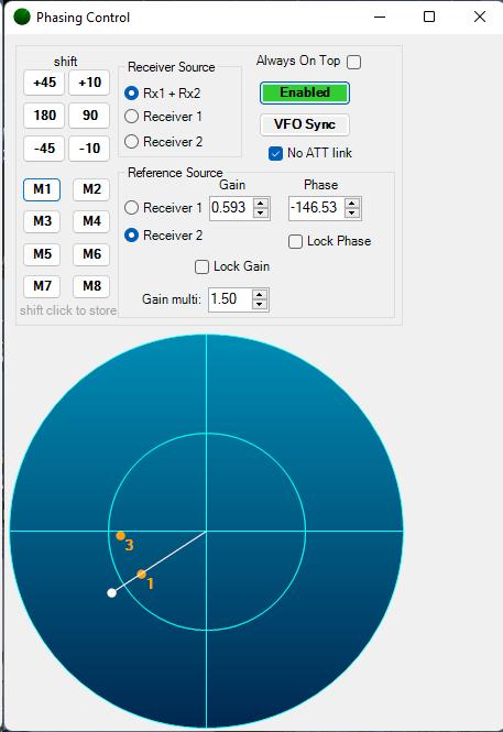

Installed 2.10.3.6 dev_5b and so far all the features I use are working fine with one exception. One display error has showed up with the Diversity interface. I find that when I start Thetis the Diversity "Phasing Control" comes back in the state it was in and the settings appear to be correct but the Phasing Control does not reliably display the correct point of adjustment. If I exit the Diversity GUI and then restart it, the GUI Phasing Control displays the memory point correctly and all is fine. So, the memory of the gain and phase adjustment function is fine, just the reported GUI setting is sitting at the center of the adjustment circle or at a random point instead of on the actual point of adjustment. Switching between Diversity M1 - M8 memories can also cause the adjustment point to remain in the middle of the circle or at another random point rather than on the actual adjustment point. It has been repeatable here with several Thetis shutdowns and restarts.
Rob W1AEX

Posted: Thu Jul 11, 2024 6:38 pm
hmm. diversity configs are stored per band. Which has always been the case. If you use a memory recall button to load one of these 8 additional, then it will overwrite the settings for the current band. Consequently if you change band, then come back it will look like that memory config is now in use.
The M[1-8] buttons are essentially like favourites than you can store away, and recall at any time, whatever band you are on. Those settings from that mem button will be used for that band.
Edit: it does look like something odd is going on. I just started up and was 'stuck' in the centre. Will look into it Rob. Cheers.
