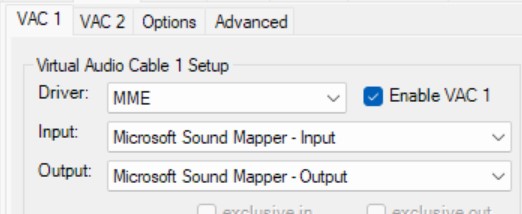

I don't know if this will help or not. My setup includes a Win 11 laptop as my desktop computer. Under the laptop is a multi-port dock. The dock is fed via USB C from the computer. I too have a Hi-Fi receiver fed by a headphone-type jack 3.5mm on the dock. The setup in Thetis looks like this...
Thetis - Setup Audio VAC, etc..jpg (24.83 KiB) Viewed 7497 times

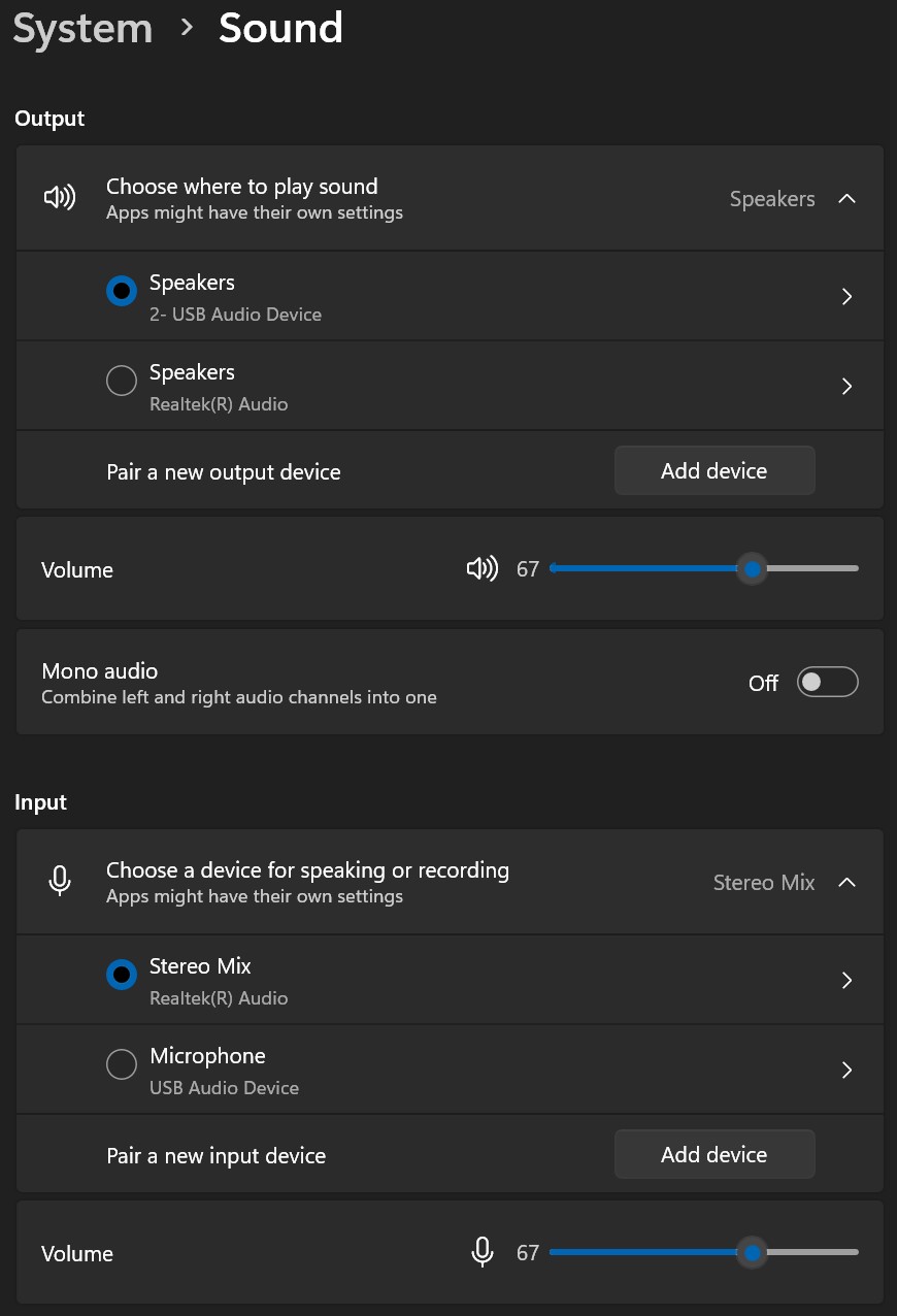

and the setup in Windows > Settings > System > Sound looks like this below.
Windows Settings System Sound.jpg (96.28 KiB) Viewed 7497 times
I don't know if you'll have that USB Sound in your setup, but the sound through the Dock greatly surpasses that of the Headphone Output on the laptop computer itself. It did take me some effort and trial and error and drivers, etc.
