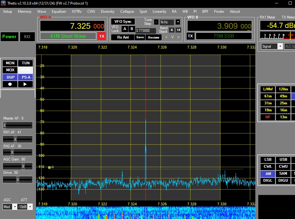

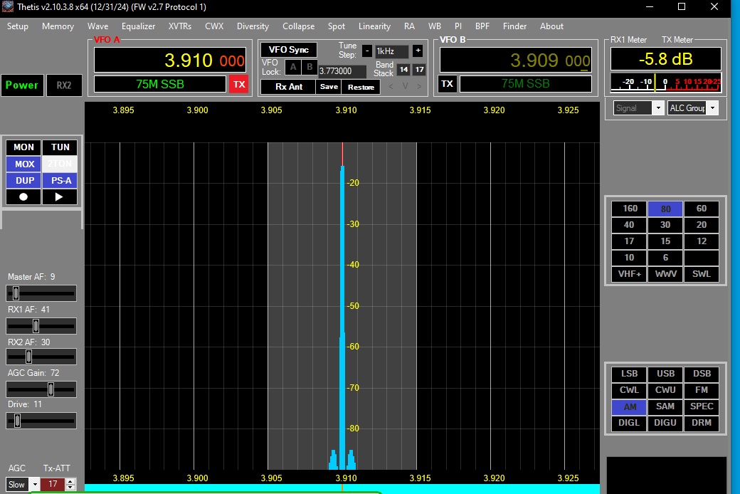

Using 2.10.3.8 I've looked for prior answers to my following question but didn't see. Sorry if a dup.
I tranmit, the line, especially with just carrier is about 4 times as wide as before. Thought a wierd spur but width is the same no
matter what the span on display. All receive signals nice and sharp as before. I used same database as prior 10.3.5 - 4.
Signal sounds fine on monitor, so it is just a display, like a purpose wider trace than rx. Didn't see any setting to change.
Is this a new feature or am I missing something? The FFT setting in tx display are same as before.
See photos
First is carrier of Radio Romania, the next is my tx in tune mode.

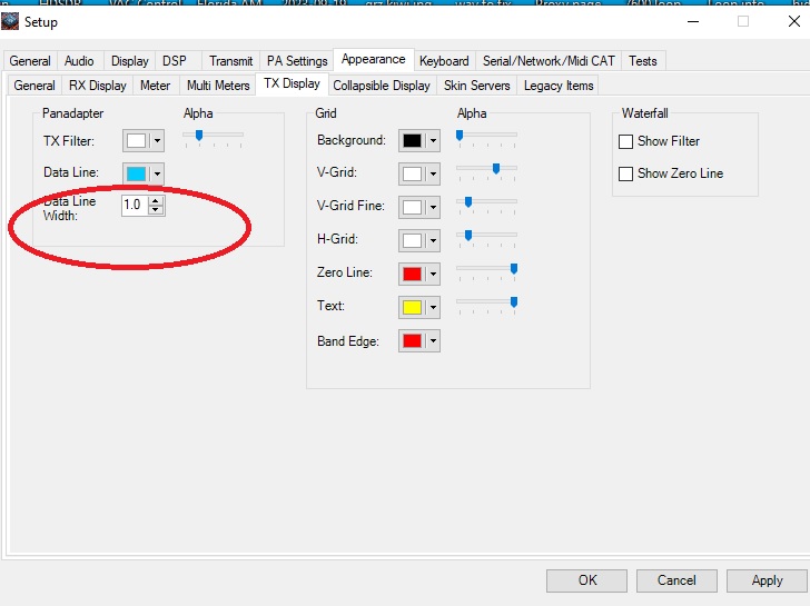

I found it. It is in Appearance --> Tx Display --> Data Line Width
