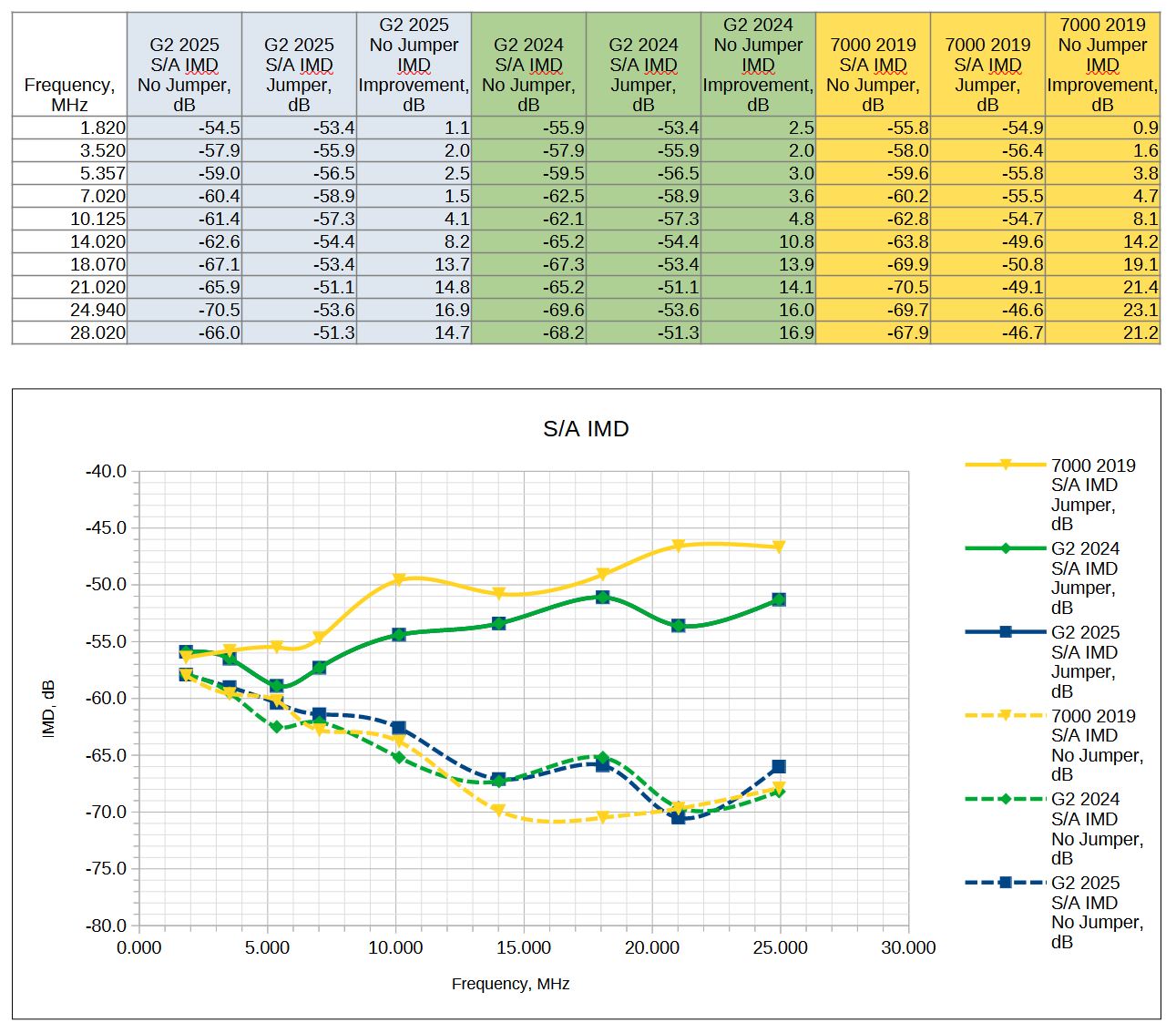

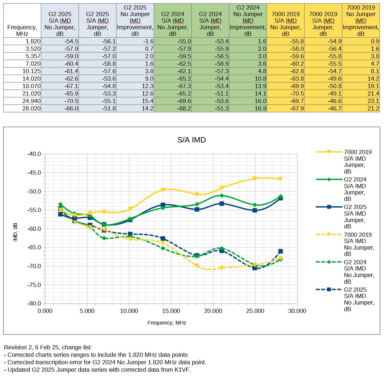

The new data presentation is certainly much more complete and compelling than the initial effort. Thank you for putting it together. The improvement in IMD performance is indeed dramatic above 40M.
There does appear to be an error in the new data presentation. It seems the data for the S/A IMD with Jumper is identical for both G2's. This might just be a cut and paste mistake.
One thing that might be confusing to some is the use of the label "Delta". Many might expect that to be the difference in IMD performance with and without the jumper, a very important value. In this case it's the difference between the Thetis measurement of IMD vs. the spectrum analyzer, of course. Perhaps it would be more clear if both types of deltas are shown.
Here is the data plotted in a different way which might make it easier to appreciate the IMD performance improvement. The solid lines represent the jumper in place, and dashed lines represent the jumper removed. Again, the two G2's appear to have identical data sets for the jumper installed cases.
A similar plot could be done showing the spectrum analyzer accuracy difference data.

If you look at the G2#2 data with jumper removed, the Thetis DUP display agrees with the external S/A to w/in 1dB everywhere except 12m, 1.7dB. That's actually w/in the absolute power level accuracy spec of the S/A in most cases (±1 or ±1.5dB), so PureSignal with Thetis DUP and the jumper removed is nearly a good as an external S/A, that was the impetus of the entire project. We already knew that Thetis in RX mode was already very close in accuracy to an external S/A, now it can also be relied upon in TX mode under 2-tone testing.
The other two radios, are w/in about 1-2 dB until 18-30Mhz, where they start to diverge approx 1-4dB, still not bad. I have some ideas about how to address the remaining small discrepancy from 18-30Mhz in TX 2-tone mode, and will be performing some experiments shortly. We'll report back if we make some headway in this regard. Thanks for your post.
Vince
K1VF

If you update your chart, correct the G2 2024>1.8Mhz>No Jumper data point appears to have been transcribed as -55.9, it should be -55.0

"A similar plot could be done showing the spectrum analyzer accuracy difference data."
Please do.
Re: Even Better PureSignal Performance on your Apache Labs radio
Posted: Thu Feb 06, 2025 3:48 pm
Here is the updated chart with corrections listed at the bottom.
If you would send me the actual spreadsheet with the Thetis and external spectrum analyzer data I'd be happy to make a similar chart as I'd rather not manually transcribe data a second time.
