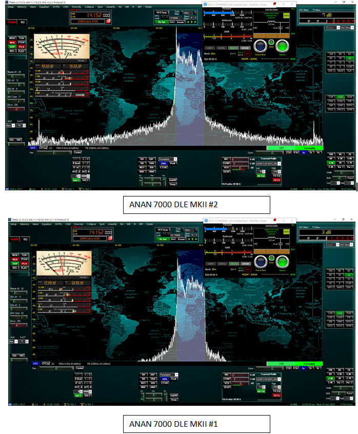

I have two 7000 DLE MKII radios and I believe both have the same FPGA ( EP4CGX150F896 Cyclone IV series FPGA) in them as well although I am not 100% certain. One radio runs on FW v2.1.18 P2 ("radio #1" in the screen-capture below) and radio #2 runs on FW v2.2.2 P2. Note, I tried FW v2.2.2 on radio #1 a long time ago, but went back to FW v2.1.18 as From/To VAC underflows/overflows showed huge numbers acted pretty bad!
Observe 2 "spurs" (for lack of a more appropriate term) when using radio #2. They appear around 15kHz above and below my actual TX frequency. This, regardless of whether I am on CW or SSB or band. Granted that the strength of the "spurs" is fairly low and 99% of the time, they won't be audible. However, why would these rear up their ugly heads only on radio #2? :? The station set-up is identical as I have only swapped radios.
I suppose I could roll back to FW v.2.1.18 on radio #2 and see if that makes any difference!
Comps Radio 1 and 2.jpg (211.58 KiB) Viewed 15779 times

You are on the right track. Put the same firmware into both boxes and see if things look similar. You can put both on 2.2.2 or both on 2.1.18, etc.

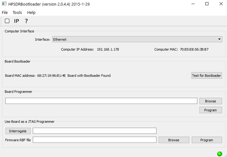

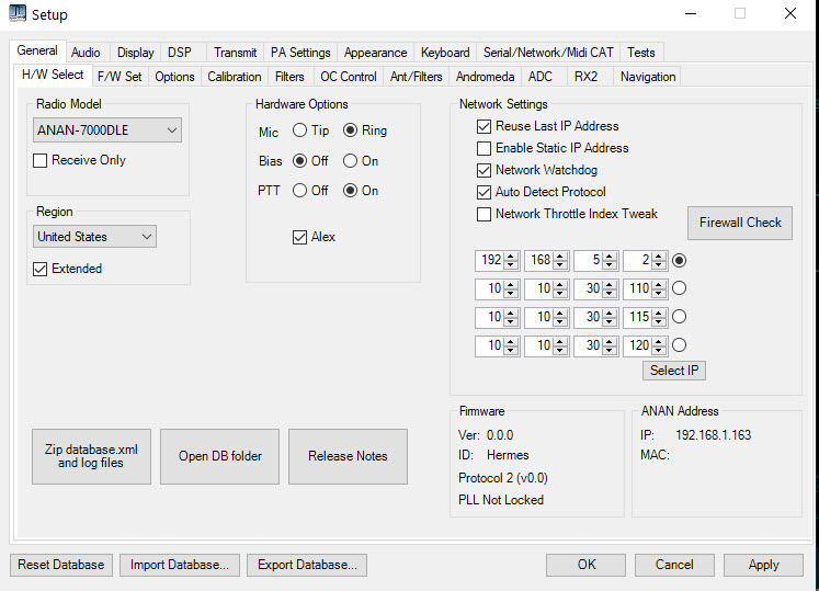

IP address: Why would the IP address be a problem all of a sudden? I guess it is possible. ;) NOTE: I only have one radio on the network at the same time. I have made copies of AppData\Roaming\OpenHPSDR for both #1 and #2 in a safe place. Now, when I swap radios, I purge out the entire AppData\Roaming\OpenHPSDR for the radio I WAS using from the PC. Before I put the other radio in line, I move the entire AppData\OpenHPSDR Folder for that radio from that "safe place." Is this an incorrect way of doing it?
Below, see Hardware, Network Forms and Bootloader View:
Network Tab #2.jpg (121.35 KiB) Viewed 15464 times
Gen HW Select #2.jpg (115.33 KiB) Viewed 15464 times

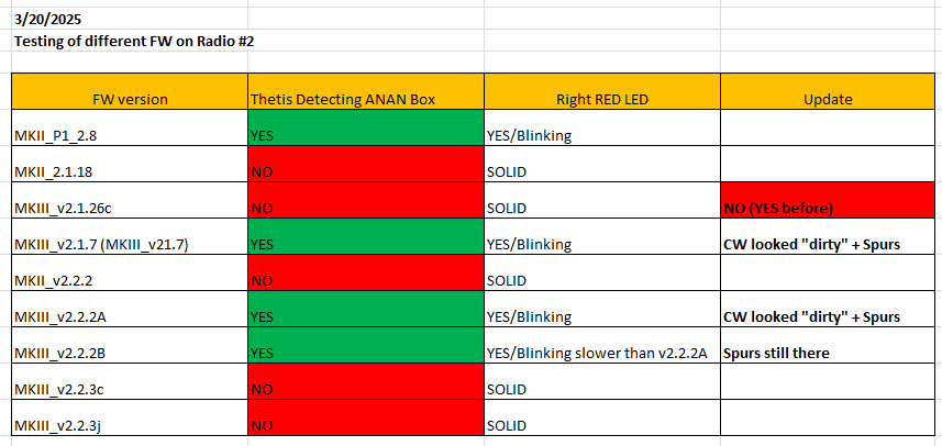

Below, see results from tests I ran today. Now, I am hoping to settle on a working FW (not going to Protocol 1 though!) that will not generate those "spurs" that I reported in the first post.
Update: Made a mistake in the Excel table, but included the correct one below. The spurs are still there for all the working versions of FW though! No change at all. Also, CW is either "dirty" or "clean" depending on the FW used. "Surprisingly," I see "dirty" CW gets "cleaner" when PureSignal is engaged :? ! I was under the impression that PureSignal mainly improved SSB transmissions.
Update on FW Tests on Radio #2.jpg (106.12 KiB) Viewed 14845 times

Q1: See those 2 "spurs" around 15kHz above and below my TX frequency. From earlier threads having to do with PureSignal, I seem to recall that spurs like these will likely not be either seen or heard by anyone. Let's assume that I talk to a local fellow on 40 meters and I am S-9/+40dB at his station. Wouldn't he be able to hear/see those "spurs?" I will read the thread where you are discussing the difference between S meter readings and the levels in the Panadapter that you also posted in this thread.
Q2: When I am on CW, I can see these "spurs" as well and they are approximately -65dBc from my TX frequency. Wouldn't that mean those "spurs" can be easily heard by someone else in case I am putting out a very powerful signal. Say S-9/+40dB again!
I am thinking that especially on CW, I would be using a transceiver that will not pass FCC regulations......but, I think I need to revisit those!
Can you alleviate my concerns and worry? :roll: ;)
Comps Radio 1 and 2.jpg (211.58 KiB) Viewed 14804 times
