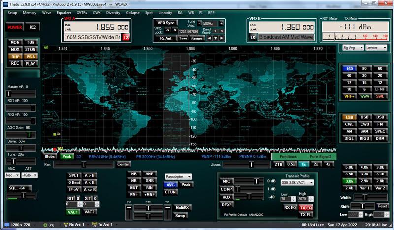

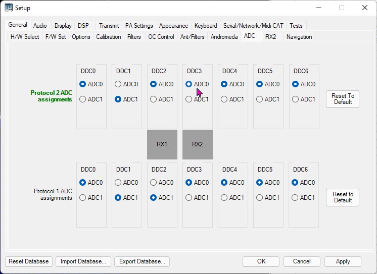

Neither RX1 or RX2 are receiving any signal for me. Attached are screenshots of my ADC tab and the generated ErrorLog.
Radio is black case 7000DLE MKII running Protocol 2.

K1LSB wrote:Richie,
uninstall through windows, go into the thetis install folder, remove any dll's that are left. It looks like your install process did not put the new channelmaster.dll in there which has that new function SetAudioAmpEnable.

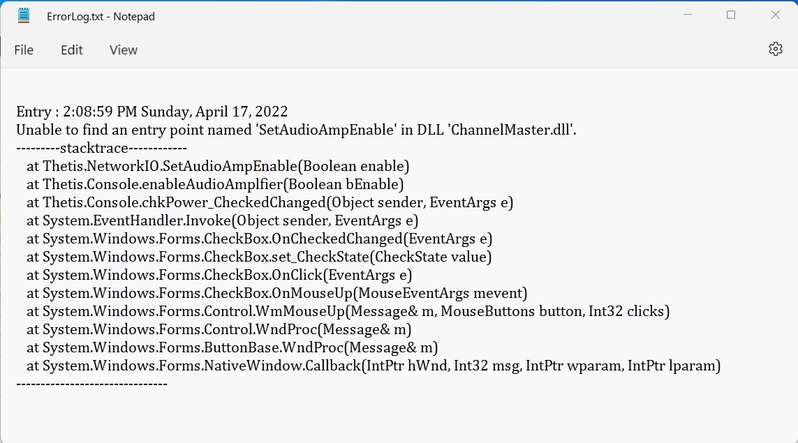

I have a curious installation / startup problem beginning approximately with V2.9.0.
Upon clicking the Thetis icon, the splash screen will open and progress with Loading Settings down to about 8 or 7 seconds. At that time installation activity ceases.
Leaving it at that stage and again starting Thetis a warning of 'other Thetis instances running' pops up. Clicking Yes to continue allows it to continue to move forward. At that time error messages regarding enabling CAT on COM1 appear. Clicking through about 3 instances of that warning allows Thetis to then open. A 2nd instance of Thetis appears in the Apps section of the Task Manager. Clicking Power allows Thetis to then run. Then closing Splash under the 1st instance of Thetis and End Task then closes the 1 instance.
The 2nd issuance of Thetis seems to continue to run okay. Perhaps I haven't achieved a complete uninstall of Thetis prior to the later fresh install.

Posts: 1582
@Dick - KA5KKT
1) reboot
2) uninstall
3) check folders
C:\Program Files\OpenHPSDR\Thetis
or
C:\Program Files (x86)\OpenHPSDR\Thetis
have no lingering dlls
4) reinstall
5) run up thetis and leave it start
If it is stuck again, make sure there are no popup windows behind the splash screen, by hovering over Thetis taskbar icon to see if any other windows are there
if nothing and still stuck, check task manager for Thetis.exe. If in list end task
check for Errorlog.txt in C:\Users\<user>\AppData\Roaming\OpenHPSDR\Thetis-x64 or C:\Users\Richie\AppData\Roaming\OpenHPSDR\Thetis

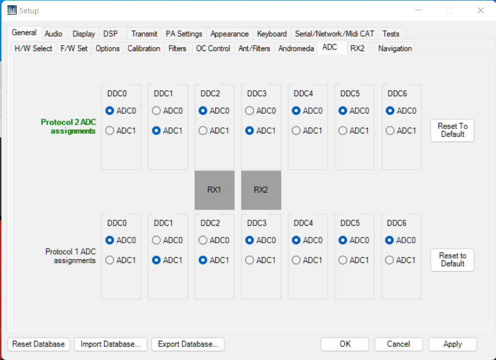

it just happens and is a permanent bug. I will try to replicate the problem with a clean database now.
Edit: No problem with a clean db. Now I have to change to my preferred settings.
Posts: 1582
DL8LAQ wrote:Hi Richie,
it is related to having the same adc set for both ddc2 and ddc3 in your case with 7000.
I am still working the fix.

ramdor wrote: it is related to having the same adc set for both ddc2 and ddc3 in your case with 7000.
Ok, I will check that with the previously used database.
Attached are the ADC settings. I don't use a 2nd antenna, so both rx are tied to ADC0.
Edit: Yes, using the previous database and default ADC settings the problem is gone!
Posts: 1582
DL8LAQ wrote: Edit: Yes, using the previous database and default ADC settings the problem is gone!
yes, thanks for confirming that, exactly what I replicated here. I will be rebuilding the installers in about 30 mins.

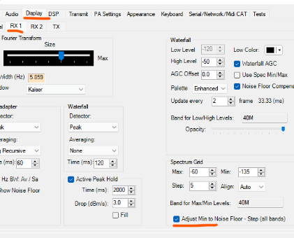

Has been updated with fixes for the ATT issue where RX1 + RX2 use the same ADC. Also added GridMin to NoiseFloor option which is early work in progress.

Deinstalled prev ver, installed new version, but the bug is still in here! I will try later with clean db. Have to leave for ice cream and Liqueur
tasting.
"Adjust Min to Noise Floor" is a beautiful feature!

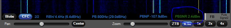

EA1DAV
Posts: 52
Post by EA1DAV »
May be I am wrong, but this measuremet is dB and not dBm.
Not sure what PBNP is.
