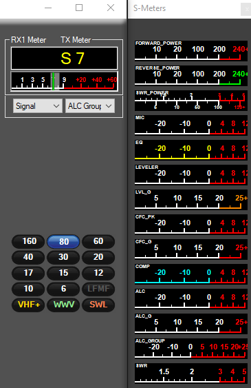

Just a teaser. Should be done by sometime over weekend. :D

Whooha, looks good Richie :o

I love your creativity Richie! Looks beautiful and it should make monitoring and setting up the TX audio gain distribution very easy.

Most Cool Richie !!!!

Oh Yeah!!!! Looks Great! :P

Hot Dang!!! Looking Good!

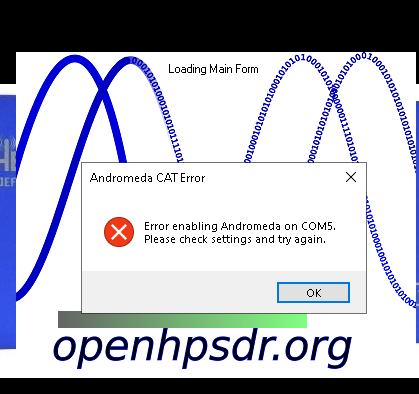

I’m getting the same Andromeda error message here.
Frank, W2SDR
I’ve tried setting to “none”. No luck

W2SDR wrote:I’m getting the same Andromeda error message here.
Frank, W2SDR
hi Frank, please attach your database.xml to a message. Located in C:\Users\<user>\AppData\Roaming\OpenHPSDR\Thetis

W2SDR wrote:my database:
Thetis_database_export_3-13-2020_6.23 AM.xml
Hi Frank, with your database, cat2 and cat3 are enabled. I get errors related for those when starting up due to com ports not available (as expected). However, I dont get the andromeda cat error.
I have tweaked the error messages so easier to see which cat number it relates to. The settings are in CAT+ under cat control tab.

Wow! Looks awesome. Thanks Richie, and welcome back.

Those CAT + com ports used because they worked fine with the previous versions. Also all of the PA calibrations had changed when going to 2.7.0 .

W2SDR wrote:Those CAT + com ports used because they worked fine with the previous versions. Also all of the PA calibrations had changed when going to 2.7.0 .
i'll spend some time again looking over the db migration code, to see if there are any issues ref the pa stuff. Laurence has taken a look at the andromeda cat issue and has reported that nothing stands out. We will take a look again this weekend.
If things are getting strange, I would say take screenshots of everything setting related, and do a full uninstall, delete of dababase etc etc, and re-install 2.6.9 then use the update zip to move to 2.7.0.

I uninstalled the program and deleted the complete folder with the wisdom file and database file also and did a new install of 2.6.9. It created a new wisdom file and of course a new database file. Then I updated to 2.7.0. Same issue. Picture of the message attached. I made sure no com port was selected in the Andromeda section. If I have no CAT commands selected the message says COM 0. It seems like its reading the first CAT control selection. I use COM5 for something in my setup ordinarily . Then COM5 gets indicated in the error message.

I forgot to mention, I'm getting the same error message on shutdown.

What happens after you get this message? If you click OK, then exit normally and run again, what happens?
I have been completely unable to reproduce the problem. I know why it gives an incorrect COM port number (if the COM port that had been saved no longer exists, it gives the first one on the list, which I can correct) but I cannot see how that line of code gets executed with "enable andromeda" being unticked.
And that code has been in Thetis for a while; I don't know why this has sprung up now.
If you click OK, what **should** happen is that the "enabled check box gets cleared, and that is saved to the database when you exit, so it no longer tries to re-enable it. Connecting a COM port and then unticking "enabled" could also help get the control state to a known "definitely not ticked" state.

I will sort out a temp exe later that has a stack trace on that error so we can get an idea where it is coming from. It could be a possible side effect of the singleton change to setupform.
