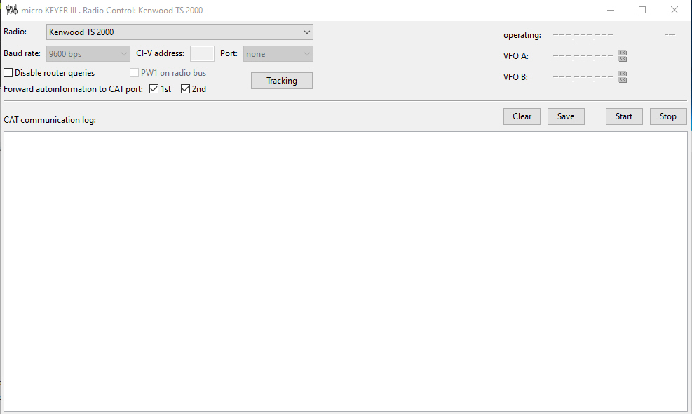

Post screen shots of your microHam and PowerSDR setup screens that show the port settings, please.
Posts: 6109
Re: micro Keyer III and anan 100d
Posts: 6109
In the microHam app your radio control port is set to "none". Set it to COM15.

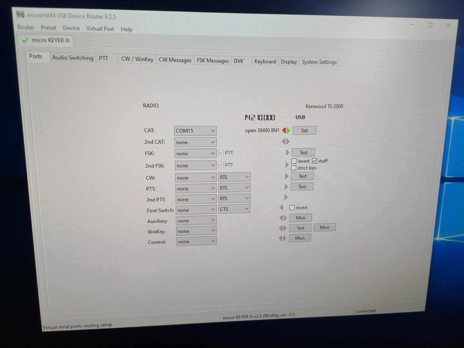

Posts: 6109

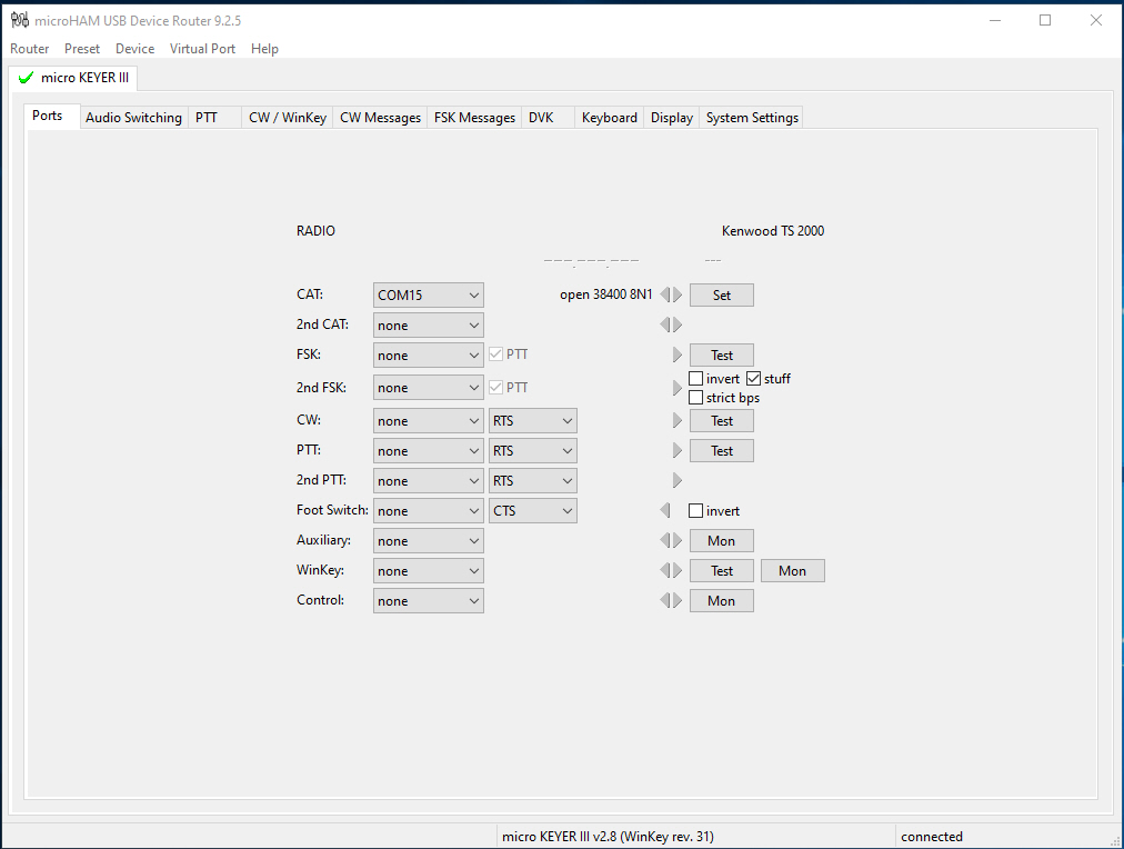

Please post a screenshot of the ports tab in the microHam software.
ea8tk
Posts: 15
Joined: Mon Apr 10, 2017 11:10 am
Post by ea8tk »
Posts: 6109

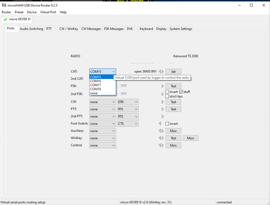

With PowerSDR running, when you select COM15 on that screen and press the Set button, do the arrows light up?
ea8tk
Posts: 15
Post by ea8tk »
They do not light, it only indicates that the port is open and the data of the same OPEN 38400 8N1

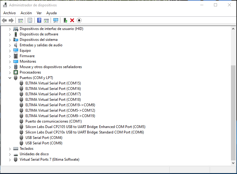

Returning to the subject I have received the rs232 to usb adapter, I have put it and it has assigned me COM9.
My question now is how do I emulate the TS2000 in OpenHPSDR, since I don't know if I'm doing it right, in the CAT control in ID as: I put TS2000, then I assign the COM9 port and enable CAT.
In the MKIII router I have selected the TS2000 but in CAT only the COMs that I have created through the Virtual Port appear and it does not allow me to assign the port.
Any idea what I can do?
