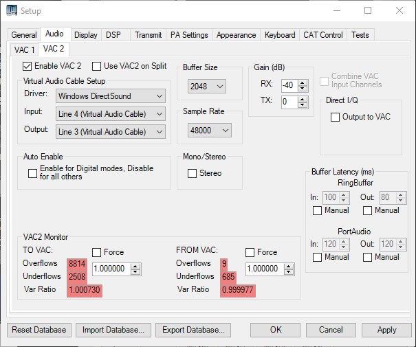

My problem looks like the one mentioned in this tread https://apache-labs.com/community/viewt ... 3291#p9914
The pictures show what I have seen and I also could hear a crackling noise using the audio repeater. The problem with 4.6x was kind of intermittend, but I could not find a way to get it functioning stable.
I went back to VAC 4.15 which solved this for me. But I see very many overflows and underflows (see the picture) This is RX2 & VAC2 running a few hours on 144.174. Nevertheless, jtdx and wsjt-x seem to work fine! I did not change all of the settings to get that solved, but will try that tomorrow or later.
Maybe it's time to try banana or potato s/w :-)
Thetis 2.7.0a3, W10/64 Pro latest build 20xx on a I5 board.
