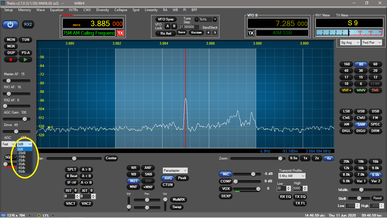

Anyone notice the extra -20db line in the attenuator settings?
I am running 2.7.0 A3, P2 v1.9 on 200D .24.
I reset the data base just to be sure but it is the same.
Here is the screen shot.
Don W9BHI

Re: 2.7.0
I only see -10 -20 -30 on mine

W9BHI wrote:Anyone notice the extra -20db line in the attenuator settings?
That's not new.
It's always been that way.
73 Marcus

Post by dj1yr »
with a double click on the ATT font you can switch between Step ATT and old ATT, this function is old

Post by W9BHI »
I switched the software to 7000dle and the attenuator selection shows 10, 20, 30.
It is a 200d software issue.
Not really a problem I guess.
Don
Posts: 6135
Re: 2.7.0
Not a huge mystery, except that it is because there is no documentation except for what you read here.
Until the 8000, all of the hardware was built with two switchable attenuators on the RF board: a 10dB attenuator and a 20dB attenuator. Thus there was the so-called "ATT" mode where you could select one, the other, or both, to get 10, 20 or 30dB of attenuation. To get more the step attenuator was added in 10dB increments. Some time ago several of us tried to figure out why 20dB occurred more than once on the menu but failed, the code is that hopelessly convoluted.
You can, of course, change to "S-ATT" mode and use the step attenuator to change attenuation in 1dB steps. IMHO this is the preferred mode of operation. The maximum step attenuator setting is 31dB.
Starting with the 8000, and in the follow on models, the 7000 and soon the 6000, it was realized that the additional attenuators on the RF board did not add any value and they were not incorporated. Hence the change to the UI in PowerSDR and Thetis for those models. In ATT mode you get three convenient 10dB steps. In S-ATT mode you get 1dB steps. But in both modes only the step attenuator is being used because it is the only attenuator in the receive path.
