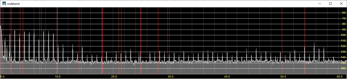

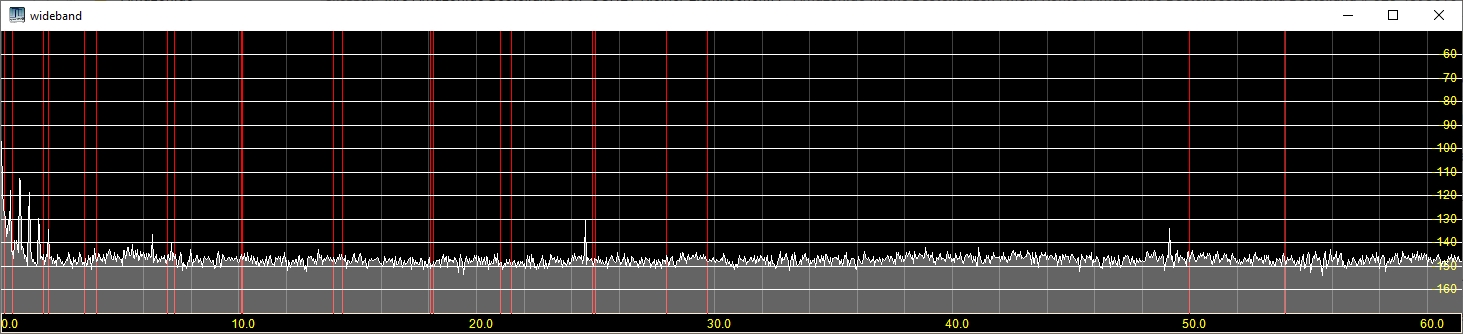

Also interesting:
PA Gemini HF1K on:
PA Gemini HF1K off:

Wow, that's some bad switching noise from that amp!
Re: 7000 receiver s meter calibration
I checked all birdies... they are all outside the ham-bands :-)
