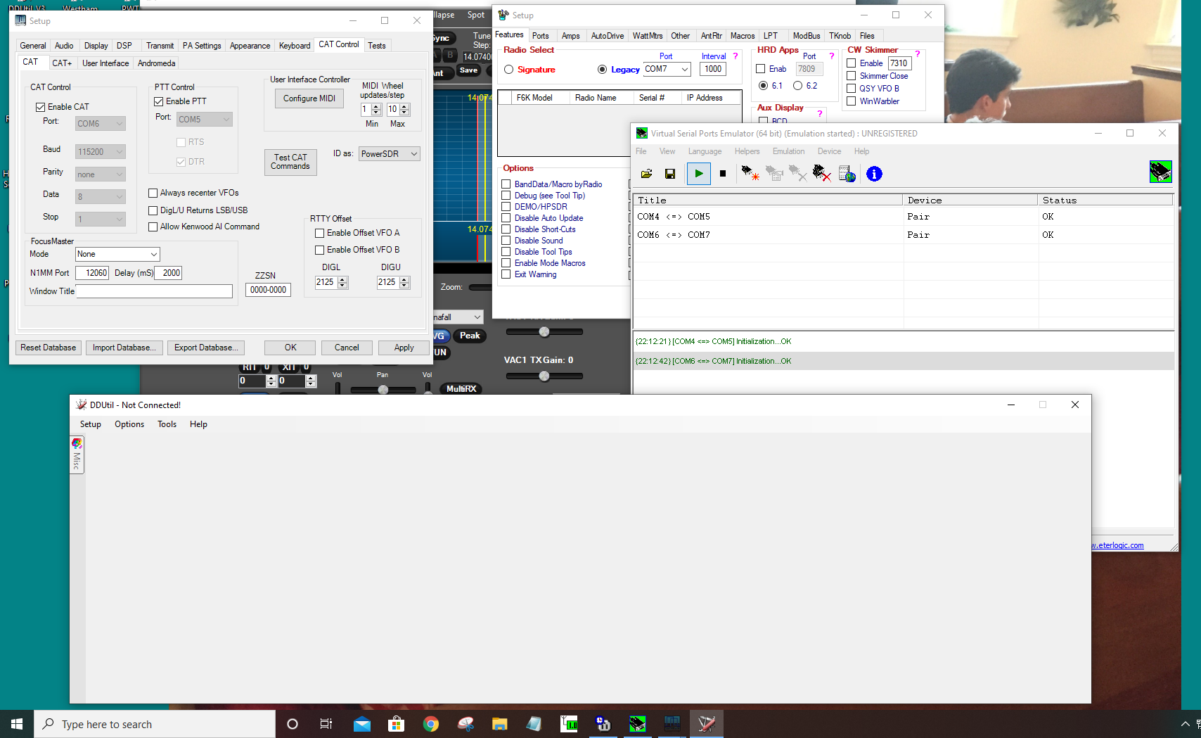

However, I am unable to find the secret of getting DDUtil to connect to Thetis via the virtual pair, COM 6 and COM7.
I've assembled a dot PNG file showing the various elements. Hopefully, you can direct me further.

So, I have followed your suggestions, including ditching VSPM in favor of VSPE for which I'm awaiting a license key.

VSPE does need to be running before anything else. To automate VSPE on startup, see this topic: https://apache-labs.com/community/viewt ... 779&p=5296
Also, I'm not certain that VSPE will run for any length of time without the license key.
More importantly, my apologies, I forgot to tell you to check "DEMO/HPSDR" in DDUtil > Setup > Features. Do that and restart DDUtil.

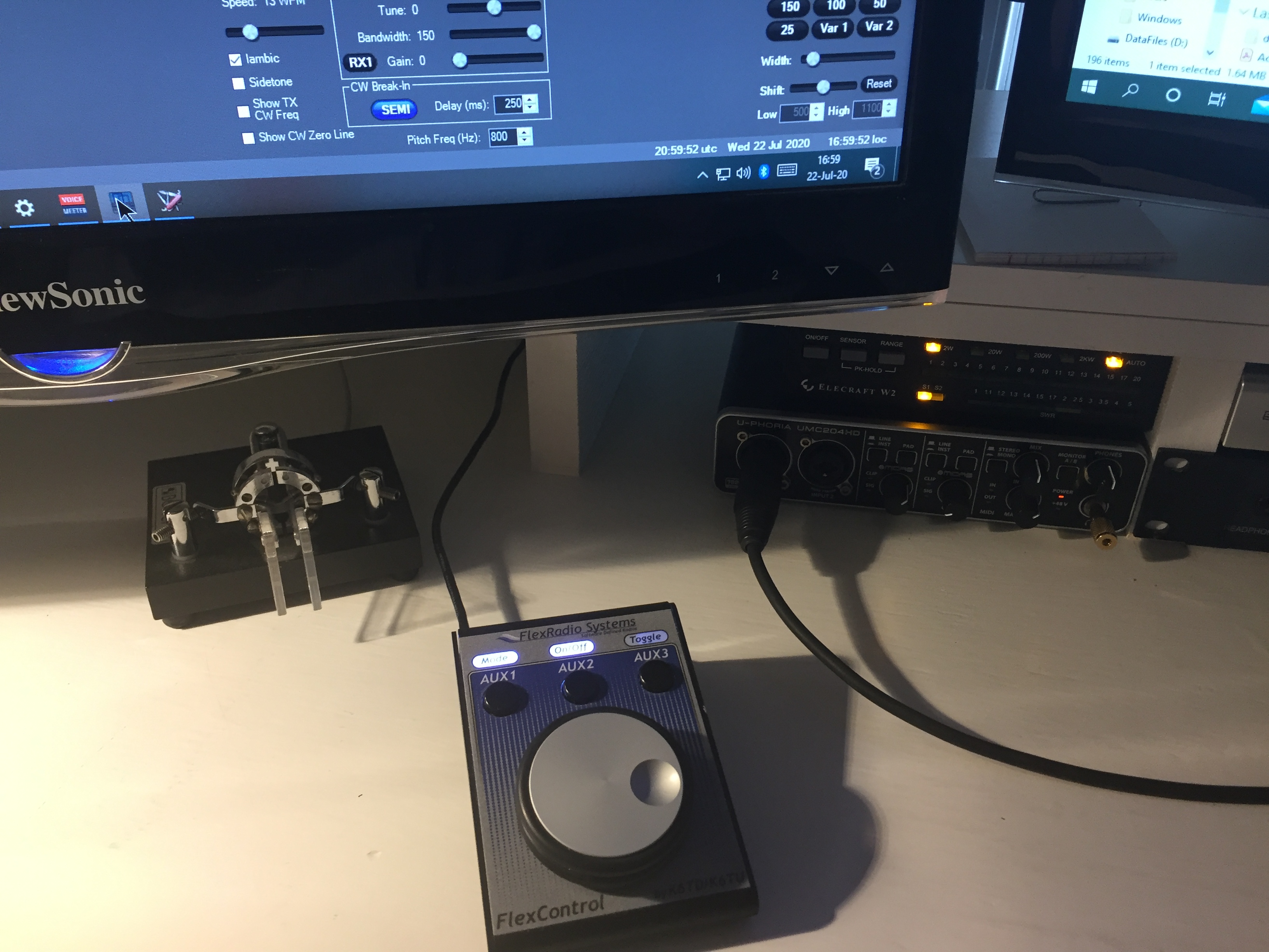

For those unfamiliar with FlexControl, I've attached a picture. FlexRadio still shows them available for purchase. I was intrigued by pictures of your MIDI controller (very nicely labeled, Scott), but at this point the FlexControl is good enough for now.
