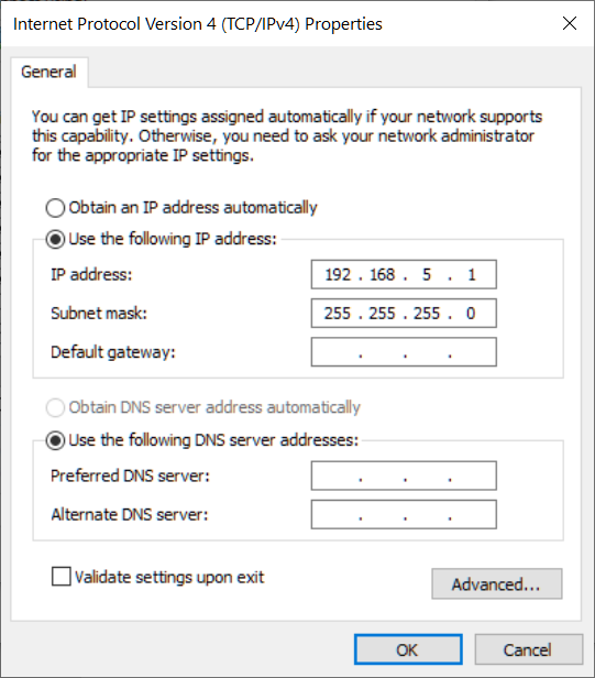

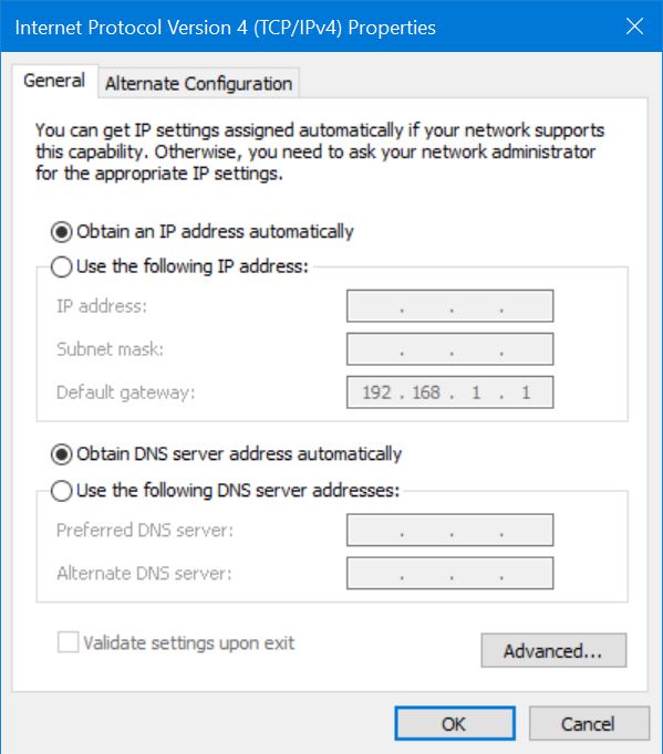

If you want to go back to APIPA you need to do two things.
1. Use Bootloader to set the IP address in the ANAN hardware to 0.0.0.0.
2. Set the extra NIC on the PC to DHCP mode (and, yes, that is confusing as HELL, shouldn't there be an APIPA setting, right? But NO, that's not how it works :roll: )
To set the extra NIC on the PC to DHCP, on your PC, go to Control Panel (not "Settings") > Network and Sharing Center > Change Adapter Settings. Right click the adapter in question and select Properties. Select Internet Protocol Version 4 and click Properties. Select Obtain IP address automatically and Obtain DNS server address automatically. Click OK a bunch of times to close all the windows.
With those settings in place, when you power up the PC, or power up the ANAN, the network adapter will look for a DHCP server. After some number of seconds/minutes, if it doesn't get a DHCP address, it will make up it's own APIPA address in the range of 169.254.0.0 – 169.254.255.255. APIPA checks the network so that it doesn't create a duplicate address, so you don't have to worry about that.

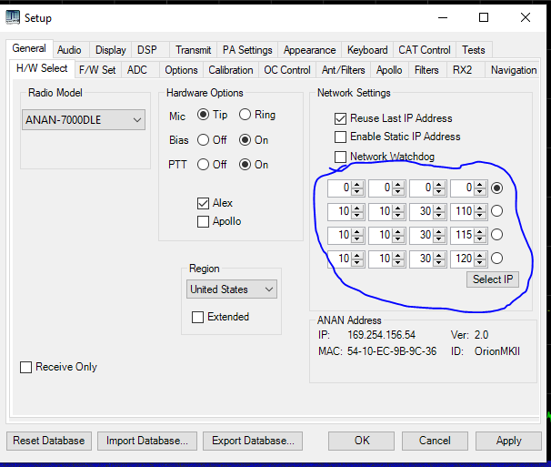

Here's one mystery for me. Why doesn't the ANAN address show 0.0.0.0 like It does when I query it in bootloader. No matter what, it says at 169.254.156.54. even through all these reinstalls. No matter what it's stuck there.
When I look at IPCONFIG from the command line I see the computer has 169.254.221.71 with subnet mask of 255.255.0.0
Shouldn't the sub addresses match? How does 221 and 156 communicate? Yet it is working now.
I can put the computer into sleep mode then wake it up a few minutes later and all is well BUT if I let it sleep overnight I have to go through this mess again.
I tried to put the image here but don't know how. It's just the setup menu showing the ANAN Address as IP: 169.254.156.54 Ver 2.0
Should I flush it out somehow? How? Why is it even working?

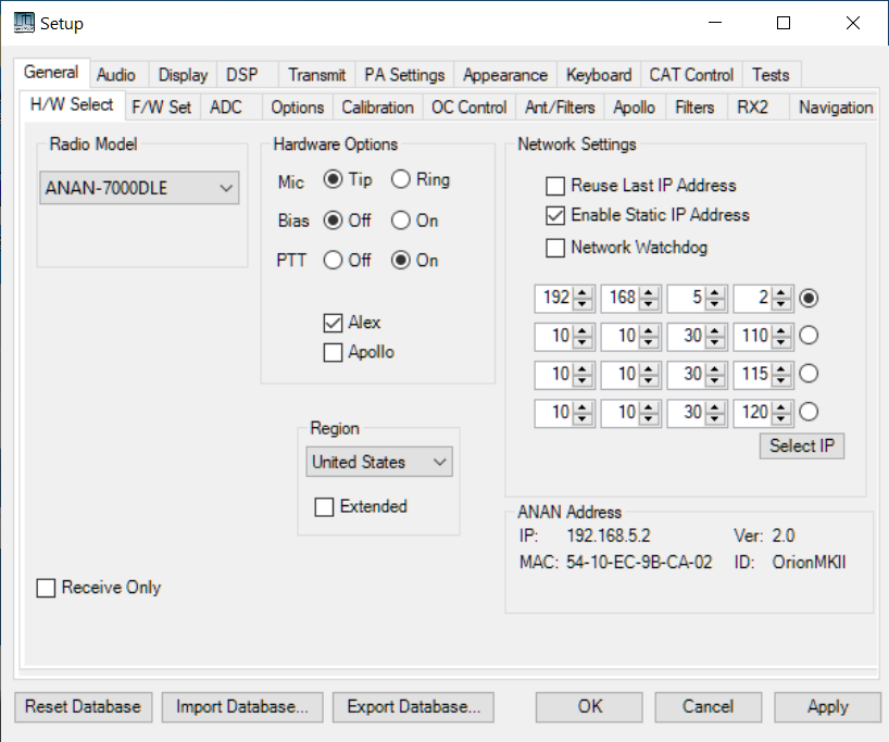

I'm just going to concentrate on Thetis/Protocol 2 for the rest of this discussion, but it is similar for PowerSDR.
When you go into Thetis > Setup > General > H/W Select and look in the lower right hand corner of the window, you will see the currently assigned IP address of the ANAN hardware. If you have set address using Bootloader to 0.0.0.0 then the address shown in the window will be either a) the APIPA address that the ANAN hardware has self-assigned OR b) the address assigned by a DHCP server. You will never see 0.0.0.0. That all zeros address is just a cheap software trick to tell the ANAN to use either APIPA or DHCP. The fact that you are seeing 169.254.156.54 means that the ANAN is successfully self-assigning an APIPA address, which is what you said you wanted to happen.
APIPA addressing uses a subnet mask of 255.255.0.0, therefore the content of the last two octants can be different and systems on an APIPA defined network can still communicate. If this still confuses you, start Google searches on "subnet mask" and "APIPA", there are plenty of good tutorials out there to read that need not be repeated here.
To me this all sounds like a PC NIC that is not waking after the computer sleeps, or hibernates, for a long time. What happens if you restart the PC?

0.0.0.0 is not, and never is, the IP address of the ANAN. By commanding it to 0.0.0.0 with the Bootloader you are telling it to be a chameleon, either an APIPA based chameleon, or a DHCP based chameleon, depending on whether it detects it is in an APIPA or DHCP environment. When it detects which environment it is in it then sets its address accordingly, and that is the address you see when PowerSDR or Thetis makes contact with it.
Also, when using Bootloader TCP/IP is never in effect, no IP address is actually used. Bootloader works at the raw Ethernet frame level, without using any IP addresses.
Do your NIC settings for the NIC you are using to communicate with the ANAN look like this (don't worry about the greyed out default gateway address)?
Is the NIC connected only to the ANAN?

Sorry...Yes it looks exactly like your photo.
I did mention that for a while I had a static IP on this. That's what started the whole thing and you explained how to
reset the Anan back to DHCP which I did.

Here is my computer's address settings:

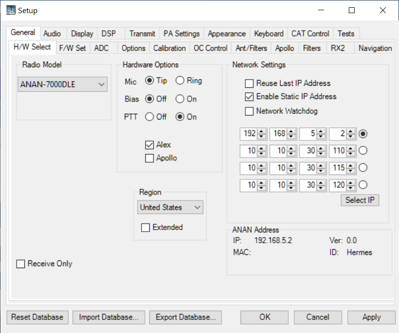

Here is the Thetis Setup page prior to pushing the Thetis Radio On button:
And here is the Thetis Setup page after pushing the Thetis Radio On button:
Hope that helps,

Thanks for the info... Do you know what these windows are for? If you select one, what happens and how do the number get there in the first place? Did you enter your static IP manually in the top one or did the software pick it up? If you click on one then click Select IP does that put that IP address into the Anan? If so then does this take the place of bootloader?
IP windows.PNG (37.35 KiB) Viewed 31887 times
Anan 7000dle MKII, custom- i9-9900k 16gb, Asus X390-A, GeForce RTX 2060, Cat8, KPA-500 amp, EFHW antenna@80'
Posts: 6110
Re: Do not use APIPA when programming an IP address!
n4lq wrote:Thanks for the info... Do you know what these windows are for?
They are for people who have more than one ANAN on their network, each with a separate static IP address.
You manually enter the number. If you select one, and check the "Enable Static IP Address" option, PowerSDR (or Thetis) will only try to connect to that address and not automatically discover the ANAN.
Manually.
NO. This is a very common misconception.
NO.
You do not need to use these features if you have only a single ANAN unit powered up at a time on your network. If you have static IPs setup then just click "Reuse Last IP Address" to speed up discovery. And you don't even need to click that option if you don't choose to, it will work just fine without it.
