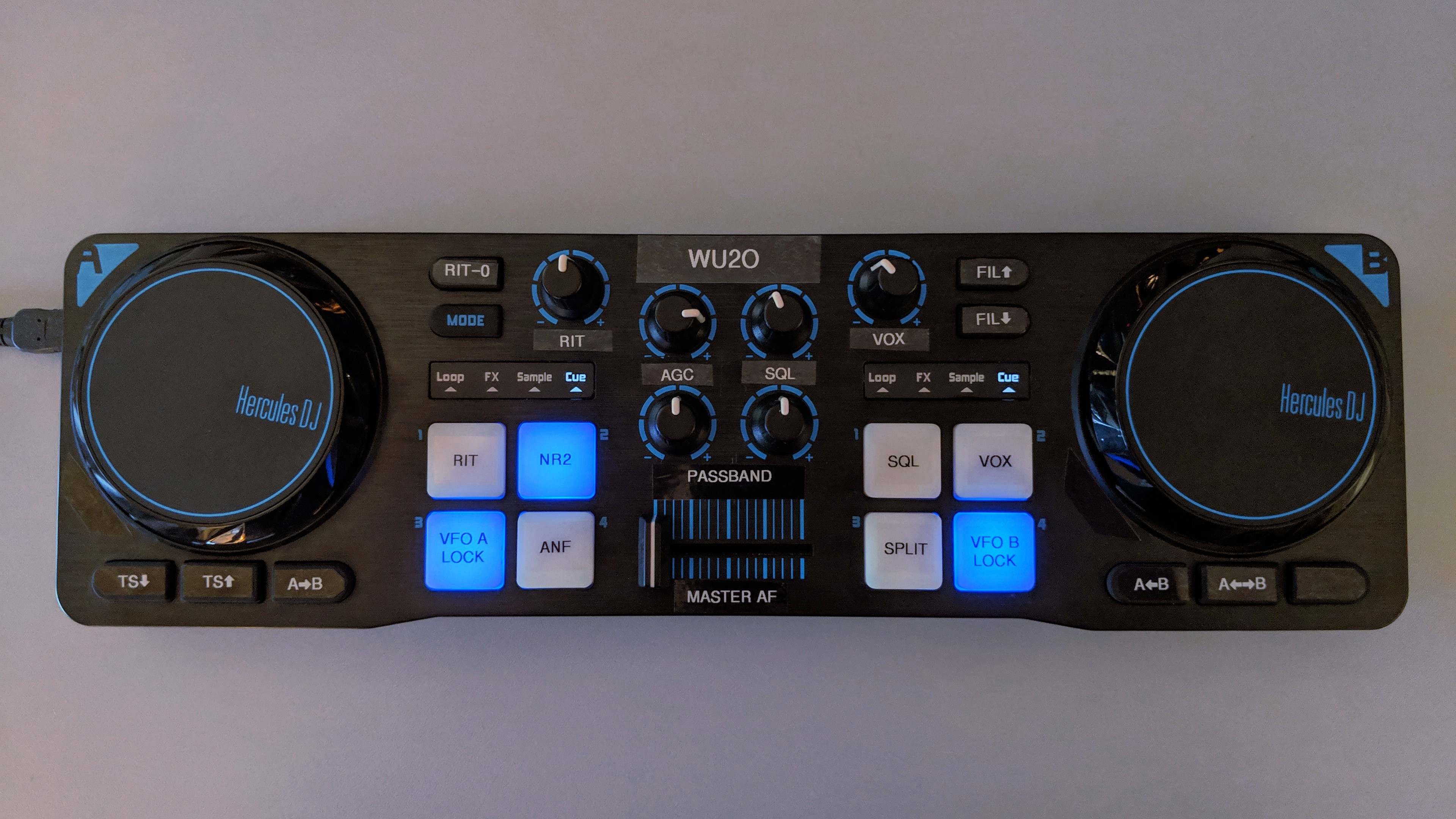

Why don't you just buy a Hercules DJ Compact so that all of your controls work? They are only $70 on Amazon.
You can run more than one MIDI controller simultaneously, if you want more controls.
And a label making machine helps, too

That's nice - and a neat job labeling it!
Maybe I'll play around with other midis later, but the one I have does all I need it to. As I wrote in the post, most of the features are superfluous or dysfunctional for me on the midi, and there's no need to duplicate them. Simpler is better! (labels are temporary until final config, btw)

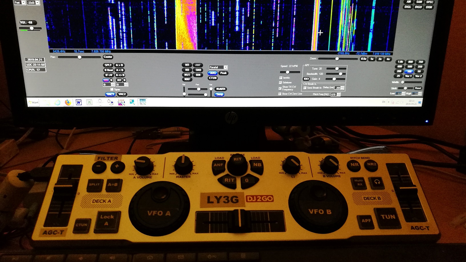

I am using a different version of DJ2GO. Everything is programmable and works great, there were no problems. Of course now I would like a Behringer CMD 2a, but mine is good too.
73! Gintas

Just bought one DJ2GO2 on ebay due to its low price (40€) waiting for postal service....
I've not understood the real issue(s) encountered by vy2ww
What should I expect in NO working with this controller ?
What's the eventual workaround ?
Don't know why the older DJ2GO by Gintas works fine....
