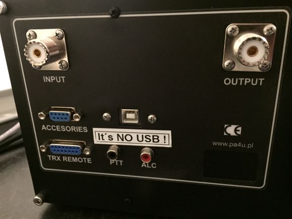

Photo of the rear of this one below
The specification of the amp was to be able to use remotely. As such the USB plug is a serial connection and came with a cable USB>DB9M which can be plugged into an RS232 to ethernet. I have managed to get it connected to the PC like you said with a cross over cable and serial to USB and the PC gave it com9. This however is ONLY for use with their pc software not to communicate by CAT
So, it still needs another cable making from what I can gather from either the Anan OC using BCD or possibly DDutil using LPT. This is where im now lost. It is in the manual for CAT using TRX DB15. Any help gratefully RX -TIA

Looking at the manual, it would appear that you can use RS232 serial connections to the Kenwood signals marked in green on either the DE15 or DE9 connectors on the back of the amplifier. The manual is not clear on three points:
1. If these are normal RS232 levels.
2. If you can use those signals interchangeably on the DE15 and DE9 ports.
3. If TX and RX assignments are relative to the amp or the PC.
The easiest thing to do is to simply try it just like I described in my post above. Set up a serial port on your PC. Assign it to one of the CAT instances in PowerSDR/Thetis. Match the baud rate and other settings on both the PC and amp side, and set the amp to Kenwood CAT. You may need to use a null modem configuration on the TX and RX data line connections--only experimentation will determine this because the manual is not specific enough.
It would appear that you will be able to use the remote control app and the CAT connection simultaneously using two separate COM ports. That's a really neat feature. I can do something similar with my Elecraft KPA500, it's quite wonderful.

This entire mess sounds like an "English as a second language" problem. It would appear the amp supports three different serial ports based on the previous discussion and your latest post:
1. The USB port, configured with a USB to serial adapter: for use with their software only.
2. The DE9 port: for use with their tuner only.
3. The three Kenwood serial lines provisioned on the DE15 port: this must be the Kenwood CAT port.
So still absolutely no necessity to use OC outputs or a BCD interface. If you've got the parts, whipping up a quick, 3-wire test cable with a DE15 on one end and a PC-compatible DE9 on the other should take about 5 minutes with a soldering iron. The only question is the sense of the TXD and RXD pins--you may have to swap them in the cable.

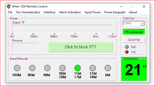

TIAThe amplifier has no USB - it's just a socket like USB. There are TX and RX signals in it as for RS232. Through this port you can:
- connect to SPertControl on the local computer (at the amplifier)
- connect to SPertControl on a computer outside the amplifier's installation location via a modem that acts as a cable between two RS232 ports. This cable is the Internet

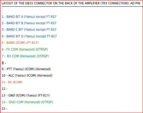

We connect the transceivers to the DB15. All radios except Kenwood, which does not produce transistor amplifiers, work with the amplifier (band selection) in BCD (Yaesu, Elecraft, Anan, SunSDR etc.) or voltage (Icom, small Yaesu) systems. For Kenwood, we had to add some CAT controls. Additionally, ALC and PTT are needed. On some radios all these signals are in one socket, then one cable between the radio and the amplifier is enough. PTT and ALC are brought out both on the DB15 and separately on the CHINCH sockets. They are the same signals, they can be connected anywhere more conveniently.
The parallel port only has the ability to set levels 0 or 1 on the outputs D0 to D. This is often used to control amplifiers, antenna switches and other devices. These outputs are configured in the software itself (logging, competition or remote control). The D0, D1, D2, D3 outputs can be used as equivalents of the ABCD code as in Anana or SunSDR. Hence the table I sent you. DDUtil also has the ability to control via LPT, this is often described as an antenna switch driver, but works exactly the same as the band switch in the amplifier. The bands are coded in the bcd code: 1 - 160M, 2 - 80m, 3 - 40m ...... 9 - 10m, 10 - 6m, respectively. The table in SunSDR gives a negated BCD because in the amplifier all ABCD outputs are at a high quiescent level. To get a low level they are rolled to the ground.
In ANAN, you need to connect ABCD to ABCD in the amplifier, program the levels as in the table to the SunSDR I sent you and connect the PTT. If there is no ALC (there is no SunSDR), the output power is generated by adjusting the input power from the radio from 0 to 20W.

On the DB15 Pins 6,7 & 14 it says Kenwood (OTRSP) - Not sure if that OTRSP affects anything

That means Open Two Radio Switching Protocol. Not sure how it is relevant here.
Nothing special to tick, just set up the CAT instance properly.
