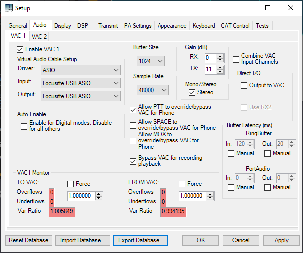

Please post a screen shot of your Thetis VAC setup window. It may be that the resampler is running in an unstable fashion for you. Do you see increasing under or overrun counters when this is occurring?

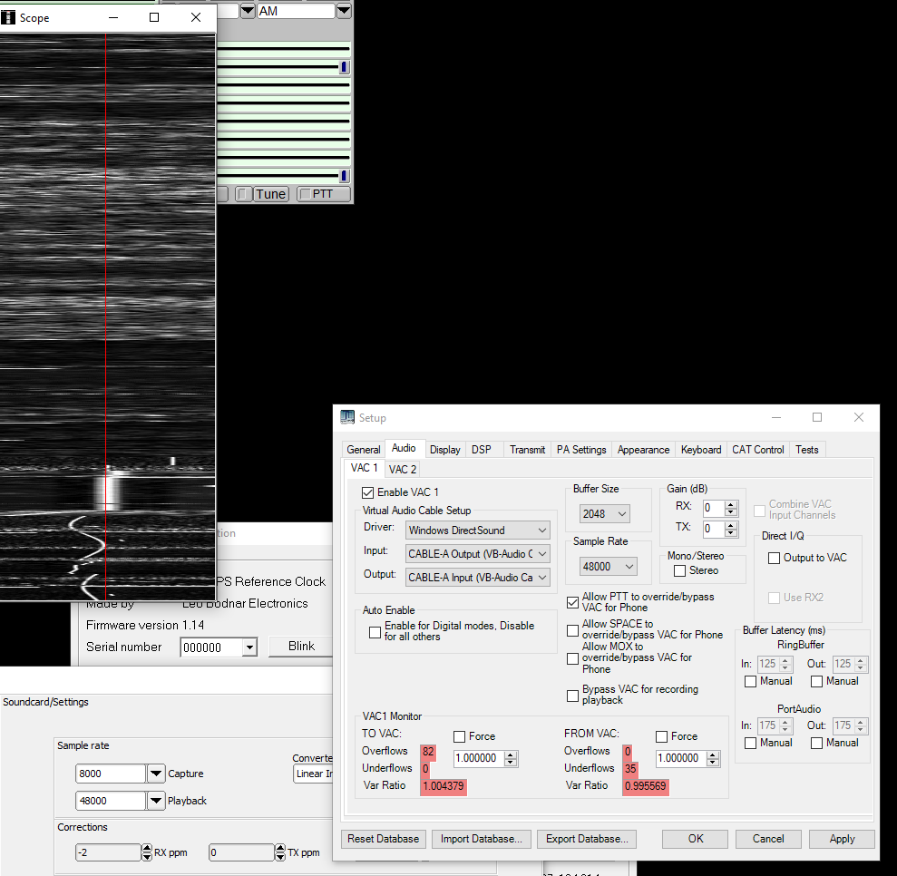

I get the same behavior if I don't force the VAC1 Monitor "TO VAC:"
I'm using Eltima VBCable. Is there some other setting to change?

No, I'm familiar with that. I tried shifting sample rate and buffers around even.w-u-2-o wrote:Please post a screen shot of your Thetis VAC setup window. It may be that the resampler is running in an unstable fashion for you. Do you see increasing under or overrun counters when this is occurring?
I have the issue whether buffer is in manual or unchecked and the VAC1 Monitor To and From are both unchecked for the force boxes.
The setup tab shot is with me operating SSB at this moment, the only change to it is instead of the ASIO, it would have MME or Direct Sound with a virtual audio cable selected.
No underrun or overflow issues.
