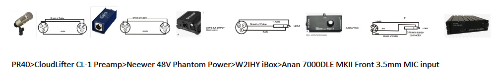

I'm awaiting delivery of a 7000DLE MKII and have been reading the manuals and this community forum while contemplating the audio input chain. Please provide feedback and critique before I begin making cables. I'm proposing to use the W2IHY iBox as a transformer, audio isolation device, and for PTT functionality. I'm brand new to SDR radio. So, all assistance and advice is appreciated. I'm particularly interested in confirming that the wiring diagram is correct and optimal with regard to the balanced to unbalanced inputs (PDF Attached for better viewing).

- Audio Chain - W8JJ.png (57.16 KiB) Viewed 13209 times

I think you are wasting a lot of money.
1. The PR40 is way overpriced. It is a hold-over from the days when radios did not have built in audio frequency equalizers and hams were not really into professional audio rack equipment. It is essentially a very expensive way to EQ yourself in the microphone. And the internal components of a PR40 are nothing to write home about. So if you want to spend a lot of money to sound how Bob Heil thought you should sound, which can be anywhere from cool radio DJ to terrible depending on your source material (the tonal qualities of your voice), with lots of extra low end, it's a good choice (but a bad decision IMHO
Now you have not one, but two semi-parametric, 10 band equalizers built into your radio software (Thetis). Use those. Buy a high quality, low cost, large diameter condenser microphone like the Behringer B1, MXL770 or 990, AKG P120, Audio Technical AT2020, etc. Pair that with the Neewer phantom supply. Adjust your transmit EQ in Thetis and you'll sound great.
2. You won't need the Cloudlifter if you go with the mic suggestions above. If you are bound and determined to go with the PR40 (or another dynamic mic), you can use the Cloudlifter in lieu of activating the mic pre-amp in the 7000 (Settings > Transmit > 20dB Mic Boost). However, my personal opinion that the Cloudlifter is a waste of time and money in this particular application. You are not mic'ing up a quiet source like some gentle acoustic guitar playing, and you are not using a ribbon mic. The built-in pre-amp is more than sufficiently good. Residual IMD in the transmitter, even with PureSignal linearization operating, will completely mask any benefits the Cloudlifter might provide.
The iBox is probably a good idea. It will formally and correctly perform the balanced to unbalanced conversion rather than doing it in the cable, and is one of the few reasonably priced W2IHY accessories. However I can't speak to how well it works or does not work. You will probably want to run minimum attenuation since you are converting mic level inputs (even if you are using the Cloudlifter). The wiring you show looks correct given the default settings for the mic input pinning in Thetis (Setup > General > H/W Select). You don't strictly need the PTT wiring, you could use the rear panel PTT input connector on the 7000. The one thing that concerns me is that the 5 pin DIN connector is inherently unshielded.
Finally, for anyone who is as concerned about audio quality as you appear to be, you are going to want to study Rob's excellent tutorial here:
https://apache-labs.com/community/viewt ... f=6&t=2550
It is a good starting place. Thetis has since added a much more capable downward expander/VOX section, which you will also want to explore.

Thank you for the detailed and thoughtful response Scott. You have opened my eyes to a new world of microphones. I've never considered condenser microphones in the past. I also appreciate your concerns regarding the cost factor. However, all of the equipment that I've listed is currently surplus gear at my station. I also have an RE20 collecting dust that I may substitute for the PR40 in the plan. Since I already have the dynamic microphones and CL-1 in stock, does this change your recommendation at all? Any thoughts on the RE20 for this application with, or without, the CL-1? I am also fine with going in a different direction using a condenser mic if that optimizes the audio potential.
In other words, are there any inherent benefits to using a condenser microphone to achieve great audio? I'm building this station from the ground up with a sharp focus on transmit audio. After listening to Anan users on the air it is clear that this radio, and the available software tools, are very capable of producing the sound that I'm seeking. For now, I intend to keep my Elecraft gear for CW until I have a chance to test the Anan in the real world during a contest. But, the phone duties are definitely being migrated to the Anan with this station upgrade.
Also, I had not realized that PTT functionality was available on the back panel until now. PTT was a significant factor for selecting the W2IHY iBox. Your concerns about the 5 pin DIN are noted and under consideration as well. This makes me consider the possibility of selecting a different commercially available transformer since the PTT issue is moot and the attenuation feature may not be necessary. Or is it?
I'm most relieved to learn that I've managed to successfully figure out the wiring for this project as I've been struggling a bit with that aspect. Now, it's just a matter of inserting and deleting various components into the path based on the hardware that I ultimately select.
73 Tim W8JJ

Re: Audio Input Proposal
Hi Tim,
I'm also really into audio, and was a big proponent of the new audio processing chain that originally came along in PowerSDR mRX, and is now even better in Thetis. The look-ahead VOX with side chain gating is especially fabulous
Before all that I used to do a lot of processing using DAW software, but no longer, the built-in features of the SDR software we use make it unnecessary for 99% of us.
It's worth noting that many of us who are serious about audio avoid the analog section of the ANAN hardware entirely. It's a pretty low end CODEC in there. Instead many of us purchase a professional sound interface, like the Behringer UMC series. I use a somewhat higher-end Presonus interface. This lets us plug our microphones right into a professional level pre-amp and digitizer that supplies real 48V phantom power and uses legit balanced audio I/O. We then utilized the VAC interface facilities of PowerSDR/Thetis to send and receive audio. I route my receive audio out of that interface to a pair of JBL LSR305 studio monitors, which does wonderful things for my receive audio! It takes a little more skull sweat to get the VAC interface tweaked and tuned, but IMHO it's worth it.
If you already own all of the gear, then by all means use it! I'm not a fan of the PR40 sound, but that's just me. I'd go with the RE20 given a choice. And if you like the way the CL-1 sounds, again by all means use it (but not on a condenser, and make sure "mic boost" is off in the software). But, again, a lot of that is very subjective. You need to like how you sound to you. BTW, do not use the MON TX monitor feature with PureSignal turned on. MON picks off the audio after predistortion. So be aware of that. Get things set, then turn on PureSignal.W8JJ wrote:Thank you for the detailed and thoughtful response Scott. You have opened my eyes to a new world of microphones. I've never considered condenser microphones in the past. I also appreciate your concerns regarding the cost factor. However, all of the equipment that I've listed is currently surplus gear at my station. I also have an RE20 collecting dust that I may substitute for the PR40 in the plan. Since I already have the dynamic microphones and CL-1 in stock, does this change your recommendation at all? Any thoughts on the RE20 for this application with, or without, the CL-1? I am also fine with going in a different direction using a condenser mic if that optimizes the audio potential.
In your case not really, because you already own everything. However, for someone starting from scratch, they can achieve a nearly ruler flat, colorless response from any number of large diameter condensers. With a flat response it can be easier to bring in the EQ you want/need, rather than trusting that a more "colorful" mic will do it for them automagically. Also, there are so many outstanding condenser choices at right around the $100 price point, it is a lot less expensive than buying a dynamic mic with equivalent performance. And, admittedly, I'm somewhat biased by a philosophical viewpoint that one should not do their EQ in the microphone. But other than that, and cost, there's no reason per se to use one mic over another.In other words, are there any inherent benefits to using a condenser microphone to achieve great audio?
With PureSignal linearization working, the very high-Q passband filters, and the look-ahead, soft-limiting ALC, even without the rest of the audio bells and whistles in the software there is no question that a properly set up PowerSDR/Thetis/ANAN combination is the best sounding configuration in ham radio. If you put in the skull sweat you will not be disappointed! And the bells and whistles are just icing on the cake. Three different stages of compression (leveler, CFC 10-band semi-parametric compression, and the ALC), two stages of 10-band semi-parametric EQ, and the phase rotator. It's a rack in a box, all in software! Plus the fully adjustable expander/VOX with look-ahead and side-chain gating. Whatever you do, don't use the old COMP compressor or CESSB. That stuff is old and outdated.I'm building this station from the ground up with a sharp focus on transmit audio. After listening to Anan users on the air it is clear that this radio, and the available software tools, are very capable of producing the sound that I'm seeking. For now, I intend to keep my Elecraft gear for CW until I have a chance to test the Anan in the real world during a contest. But, the phone duties are definitely being migrated to the Anan with this station upgrade.
I do not believe you will need any attenuation. If you already own a balanced to unbalanced transformer by all means employ that instead.Also, I had not realized that PTT functionality was available on the back panel until now. PTT was a significant factor for selecting the W2IHY iBox. Your concerns about the 5 pin DIN are noted and under consideration as well. This makes me consider the possibility of selecting a different commercially available transformer since the PTT issue is moot and the attenuation feature may not be necessary. Or is it?
