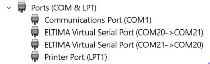

Not sure what you mean by "[VSPM] has not proven to be as stable for me as the other choices" but for the record, that utility is the only VSP software I've ever used and it has never given me a single problem. It may not be as feature rich as some of the others but it is as reliable as an anvil (and it's free). It appears to be based on the Eltima software, here's a snapshot of my Device Manager screen:
If you have any specific examples of instability you've encountered with VSPM, can you share them with us?

Certainly. For me VSPM has often caused an inability to make a virtual serial port connection without having to reboot. It will work for a while, then just stop.
To add insult to injury, when combined with DDUtil this problem had persisted for me across reboots. All honor to Steve, and I love what his software does for my station, and I am totally reliant upon it, but there is something funky about his serial code.
With VSPE I never have any problems except with DDUtil, and I can fix the latter by restarting VSPE without rebooting. Also, I need port splitting, which VSPM can't do.
It is worth noting that I've experienced this in both Win7 and Win10 environments.
