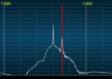

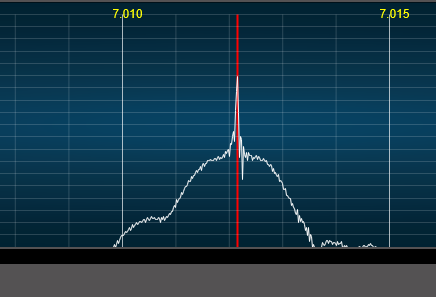

I attached a screenshots of what is actually happening. If you look you'll see the reason for the pair of initial dits (bottom pic). Interesting how the carrier shifts with PS engaged.
Sure would be nice if PS was disabled in CW mode!
--aa2gf--
